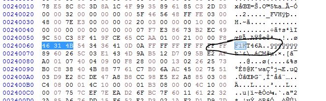

    Have a M72E Thinkcentre brought in today. No POST, and fans just run at high speed so looks like a corrupted BIOS and/or ME.
    Machine type is 3578. Motherboard is IH61M Ver 4.2. There's two SPI ROM's, one is 16M (with 2M flash) and the other is 32M (with 4M flash). Just a bit confused with all the variants for this model. Original dumps attached.

                Here you go,try these,flash both of them.Bios version F1K74A + DMI.
                The old bios version was F1KT46A
                From lenovo support:
                How to identify whether your system is IVY, PCI or Tiny?
                Power on the unit, press the F1 Fn-key to enter the BIOS Setup
                Refer to the image below, if the BIOS Revision Level indicates:
                F1KTxxA, then it is a IVY system
                F9KTxxA, then it is a PCI system
                F4KTxxA, then it is a Tiny system
                xx indicates the actual BIOS level, such as F1KT16A).
