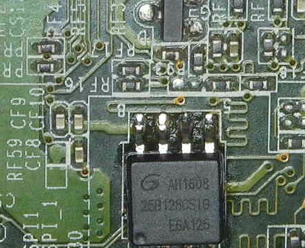

    hello
    i need dump dell precision 3620 MB 09wh54
    original dump :2 blink orange and 1 white
    i find here another bios but not work (spin fan and orange led and power off .)
    https://www.badcaps.net/forum/showpo...5&postcount=75
    I'm not sure, it's a bios problem, I prefer try
    thanks

      Re: Need bios Dell Precision 3620
      same orange light and power off
      edit: ok i think lost a resitor
      I did not find a better picture, an idea of the value

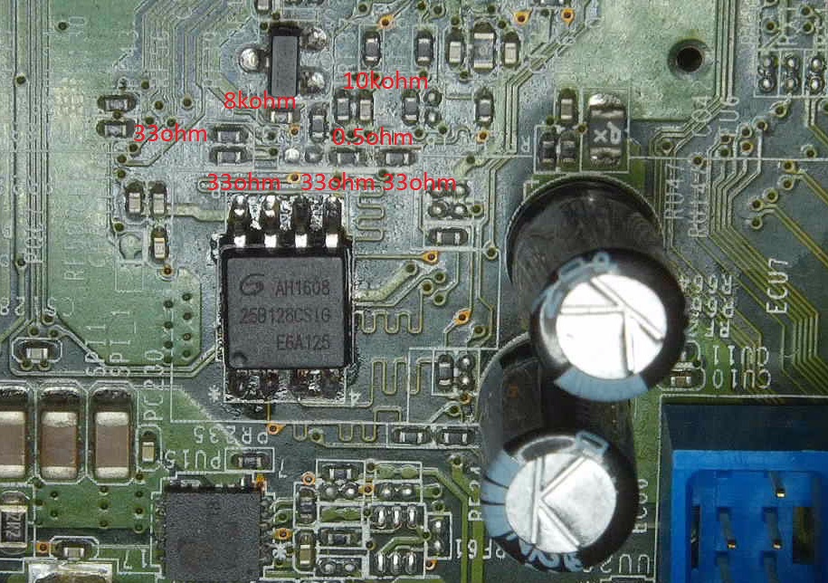

        with values near
          • 20299
          try 33ohm
            so after replaced by 33ohm. the first failure returns. 2 short and 1 long orange flash.
            it's not white. I made a mistake in the first text

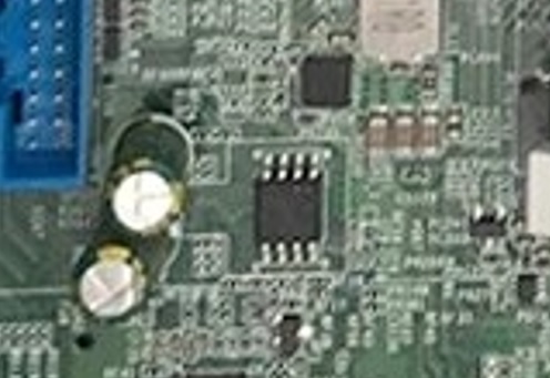

              Hello Gents sorry for the noob vibe I'm about to give, but I need a bios only region of the same workstation Dell Precision 3620. I screwed it up trying to add Slic 2.6
              Thanks,
