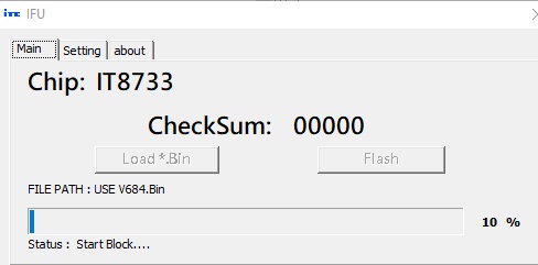

            got an B450 aorus elit v1.0 board for repair.
            with a Ryzen 3 3200g processor
            and i "acccidentally" erased EC bios, lol
            flashed main bios 65e from Gigabye site
            and flashed Soso's ecold dump and it worked!!
            Later on, i decided to run EC Fw Update tool ( see pic)
            and made a backup dump from this working EC bios
            V684.
            hope it helps!

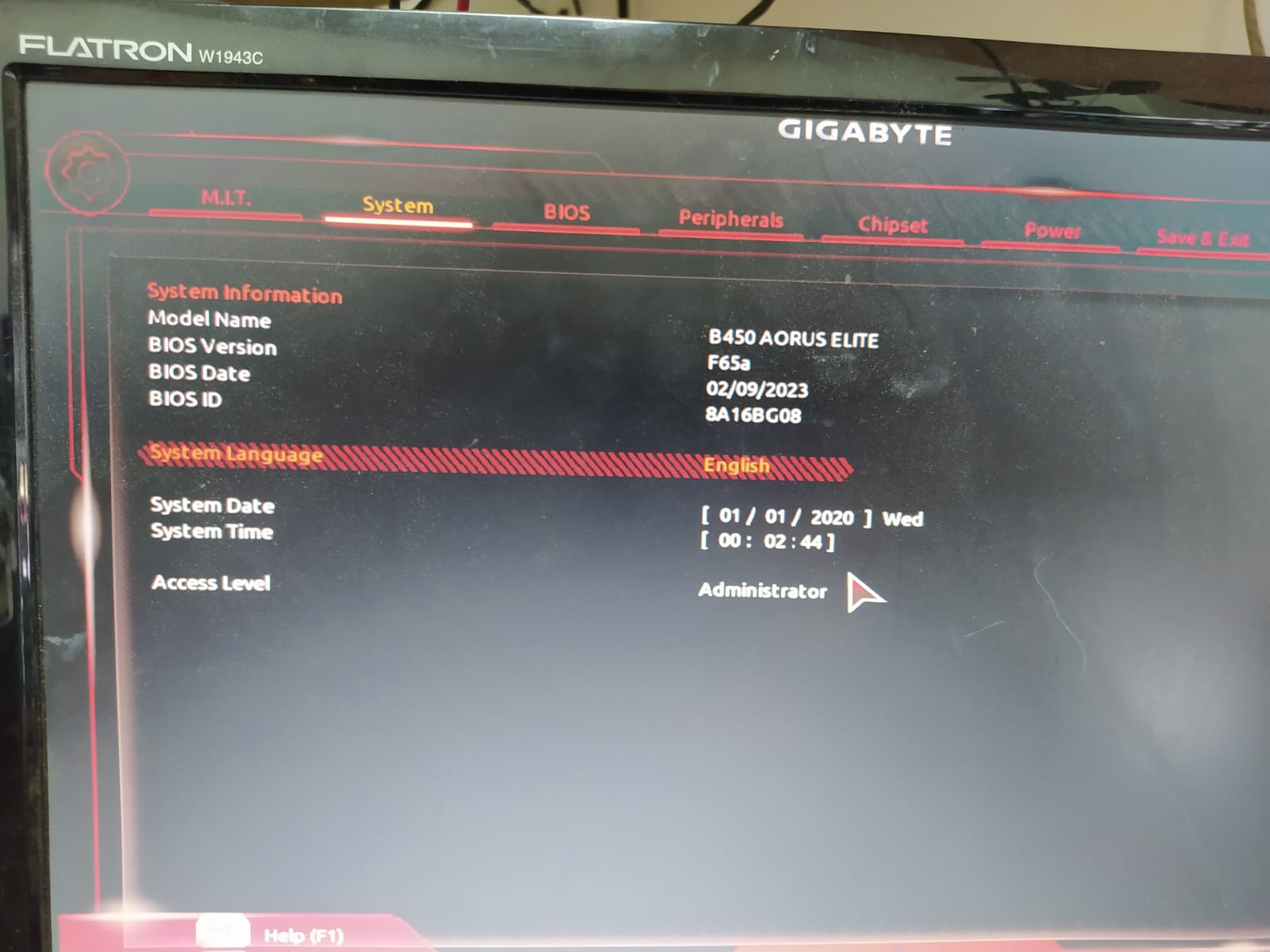

                    Please, does anyone have .bin dump clean of B450 Aorus Elite v1 bios to use with CH341A flasher.
                    Thank you!
