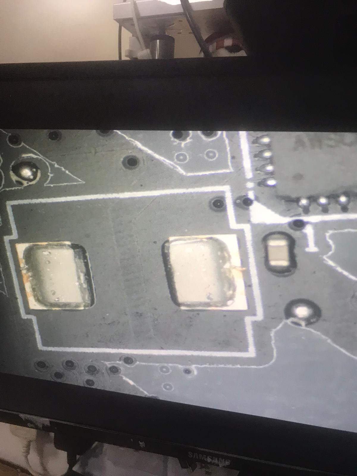

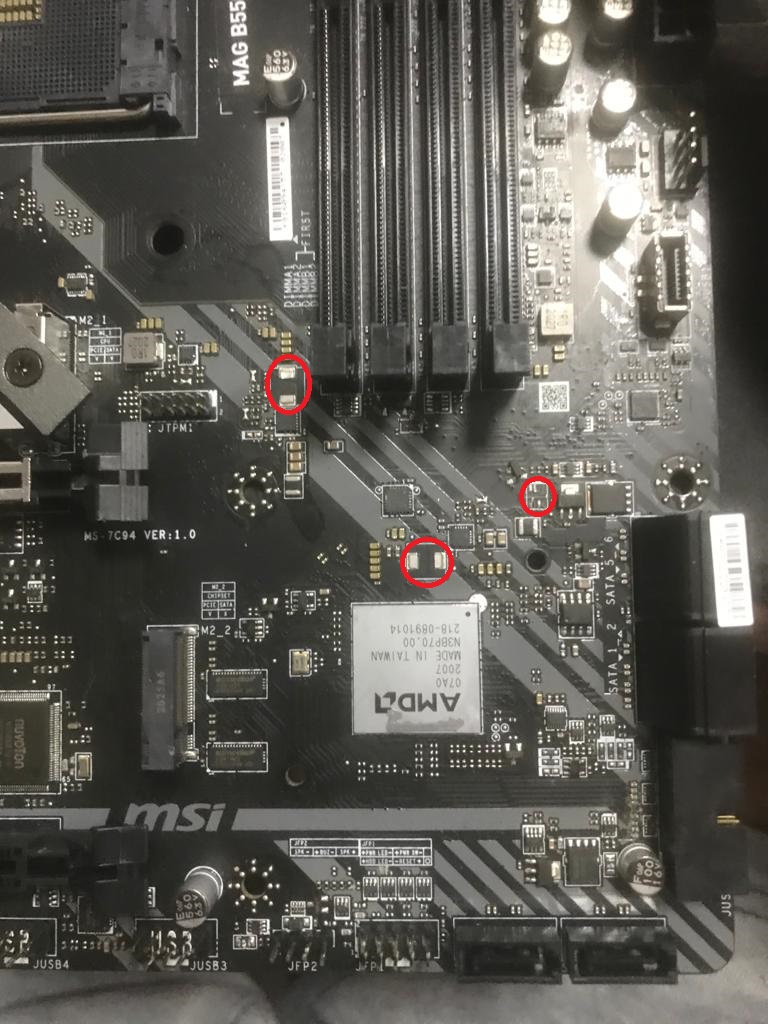

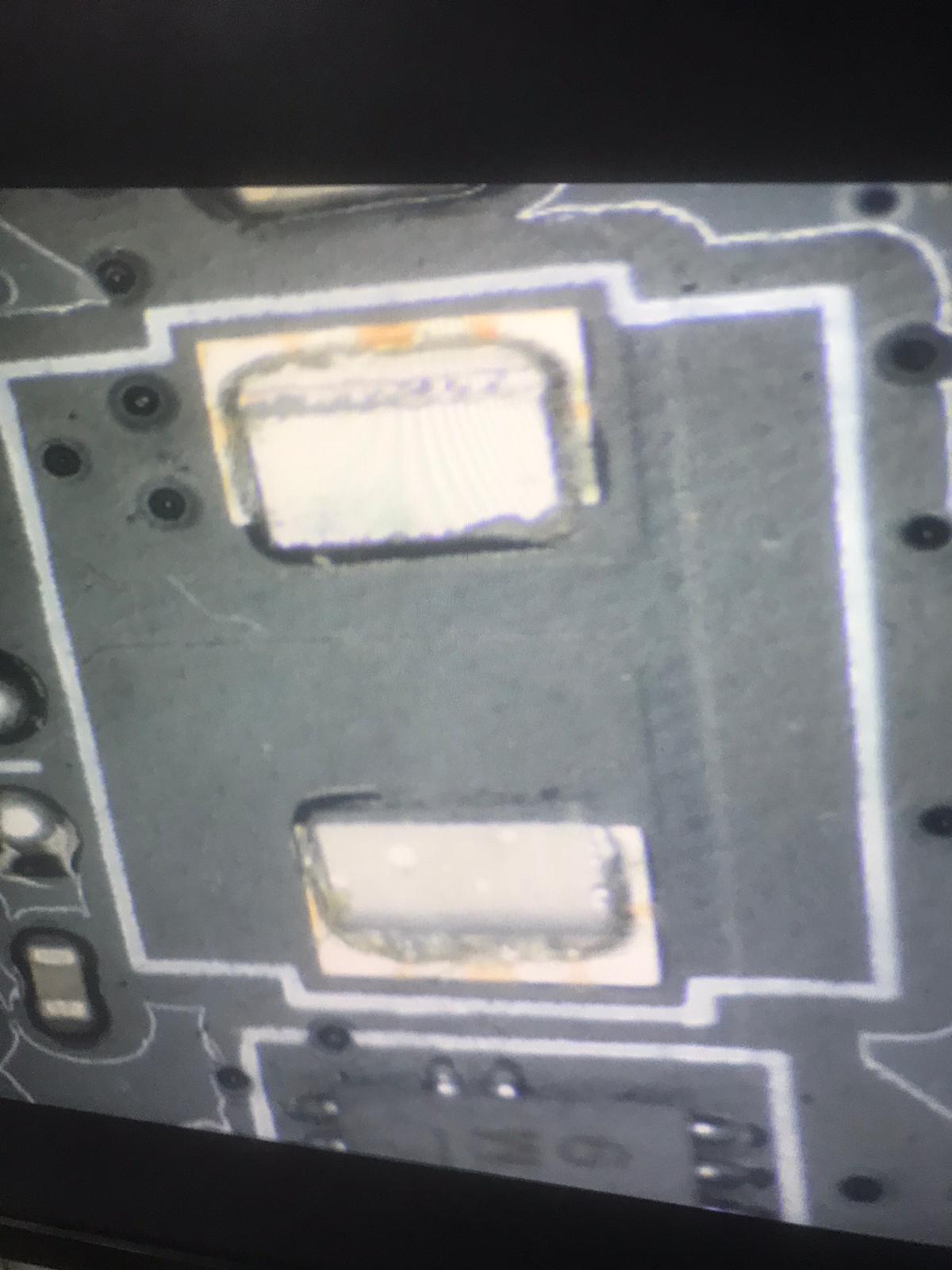

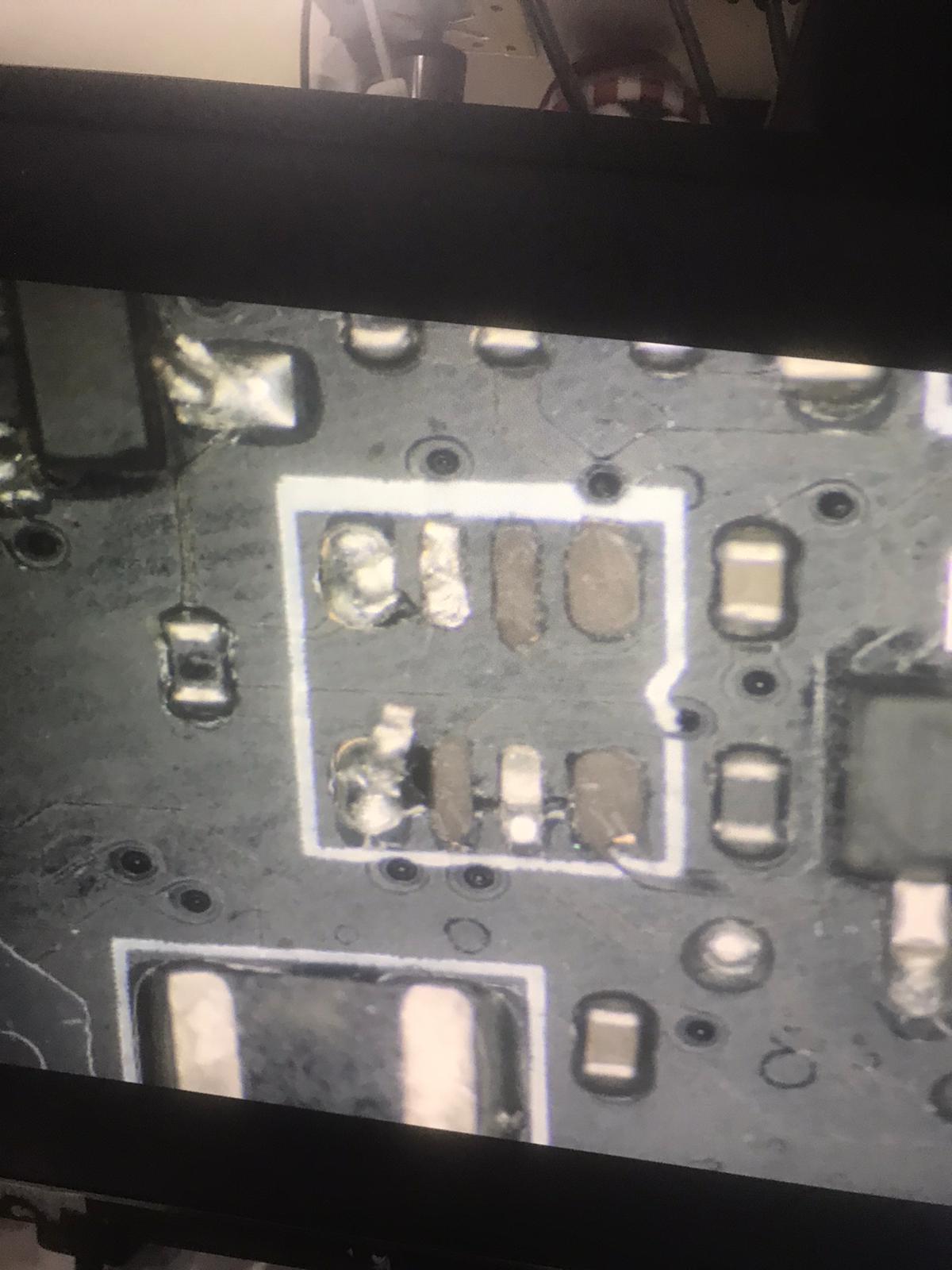

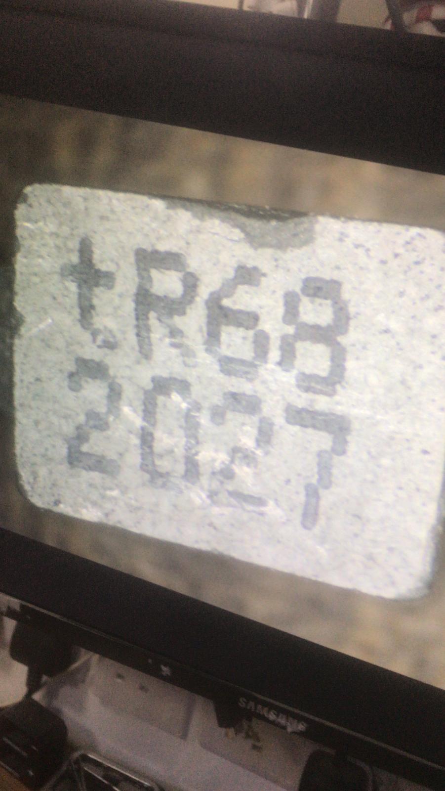

    Hi guys,
    Just got this board - MSI mag B550M Mortar (MS-7C94 ver: 1.0) with 2 inductors (1 was inside the box) and 1 ci knocked...
    Anybody could please name the missing ones and point the inductor to the right spot or have the Schematics/Boardview for that model?
    Thank you all

      Re: MSI mag B550 Mortar - Schematics/Boardview or Name this Missing Parts
      With left to right:
      CHOKE4 - CH-0.68u8.5A9.3m
      L5 - 1.0u7A11mS
      U30 - UP7501M8
