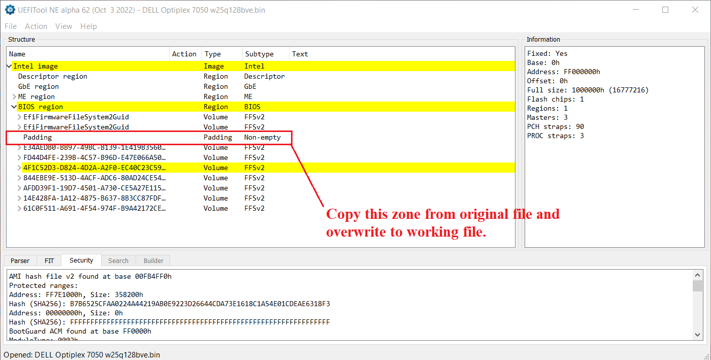

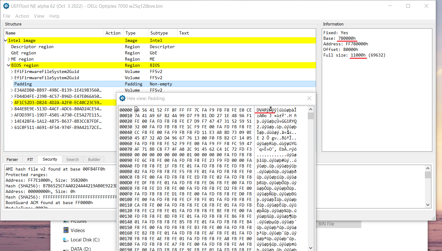

        Hi, i downloaded this bios but i have problem with MR region. Do you have some advice ?
        • peste
          • Dec 2016
          • 13653
          • ROMANIA
          Re: Optiplex 7050 Bios bin file
          what problems do you have exactly ??
            Hi everyone!
            There is a bios dump from a working nettop. There is another nettop on which the bios is lost. If you just copy the BIOS from a working one to a non-working one, then there are problems with the ME region (long start, inadequate cooling, etc.) and all numbers (service tag, poppy addresses) are copied and the network card does not work. Can it be cleaned of dirty ME and, most importantly, how to add other service tag numbers, poppy addresses, etc.?
