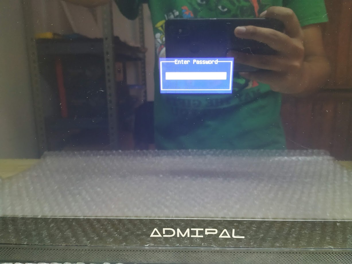

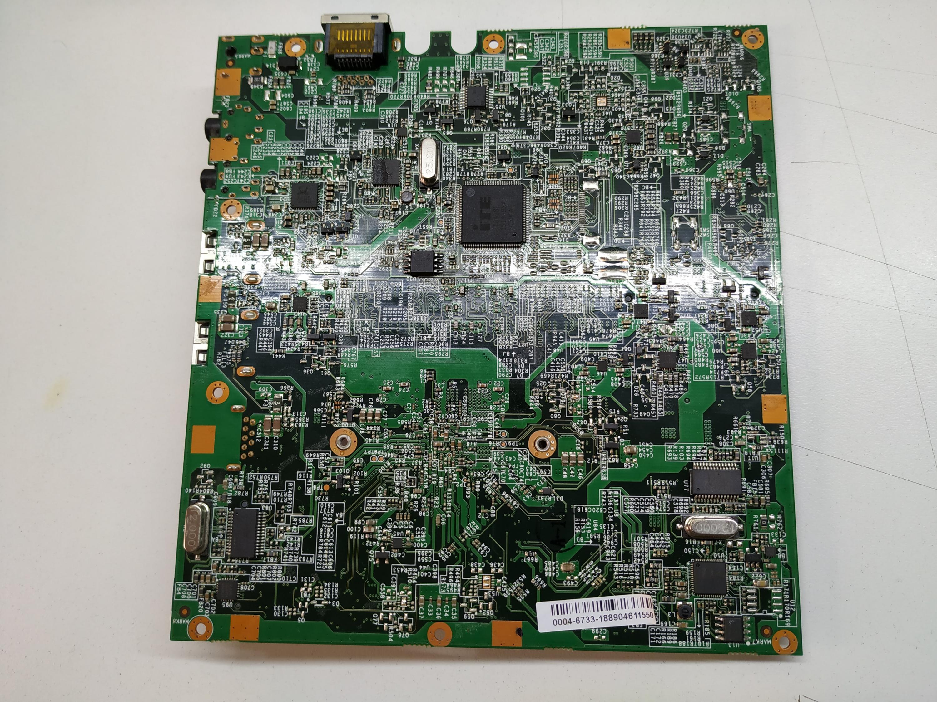

    I have this AIO, ADMIRAL DESK-UM30B, the problem is that it is asking for password as soon as it boots, it wont load windows, after typing 3 incorrect passwords it only shows a message "Invalid Password" and nothing else on screen, looks like a rebrand of LENGDA UM30B, motherboard is the same in DEXP AQUILON O103, IRU L1903, the motherboard model is UM30B_MAIN_PCB
    I have tried to flash a DEXP Aquilon o103 but the display wont turn on, also i have tried to clean the ME Region from my dump, but stills asks for password, hope you guys can help me, thanks!

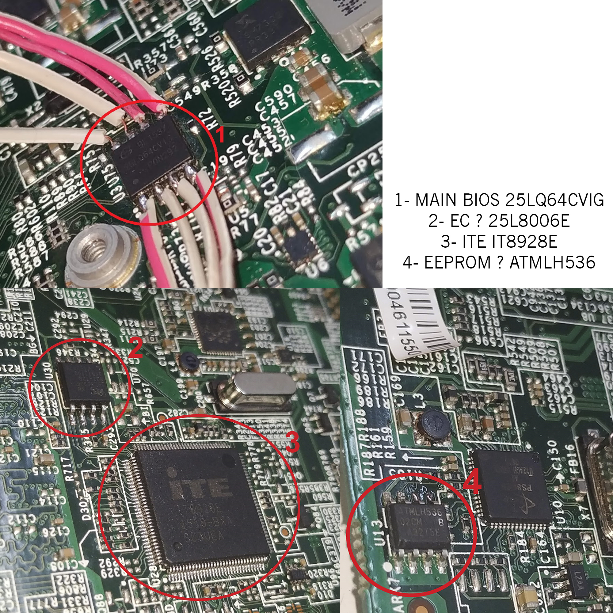

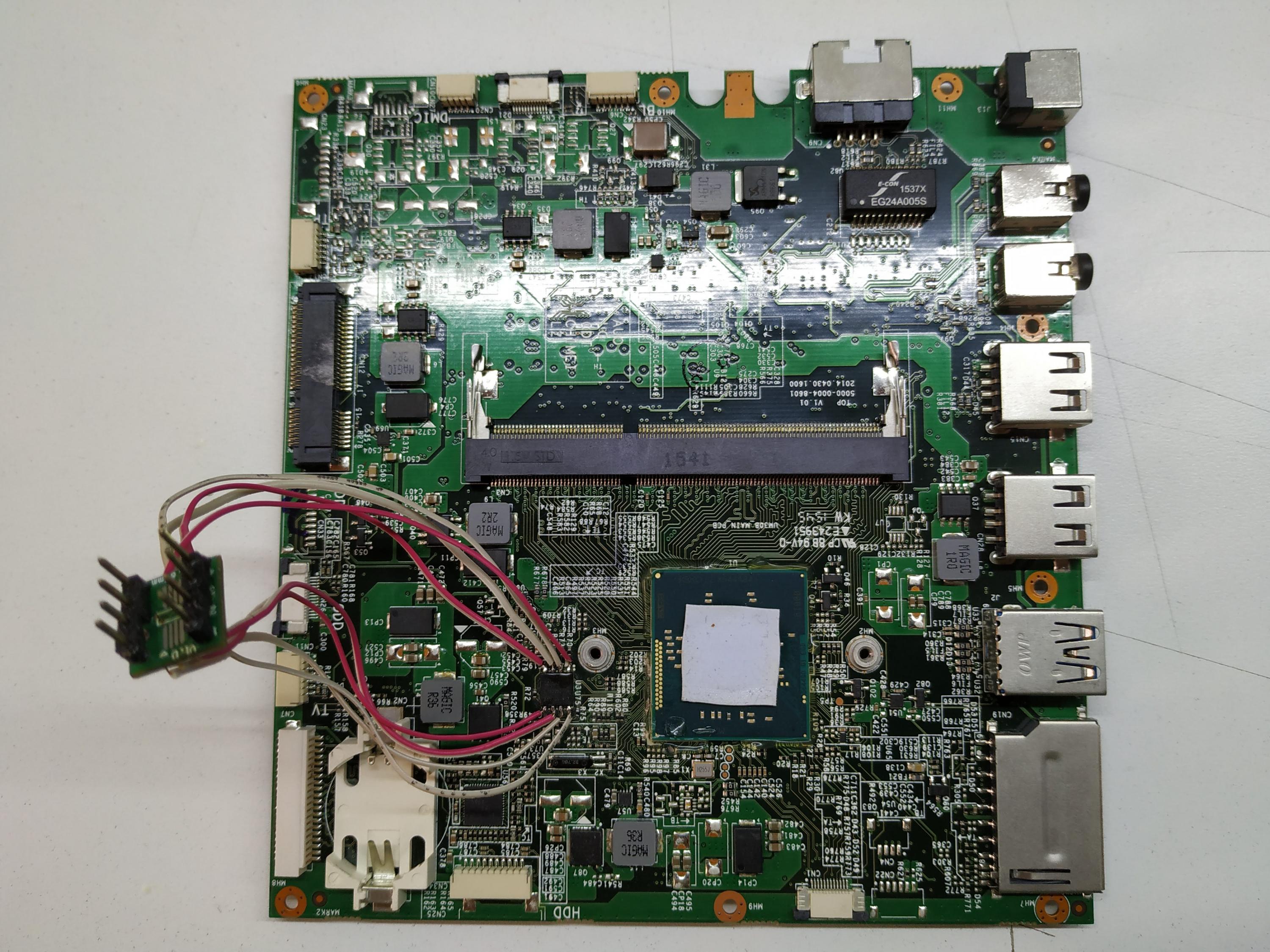

        can you dump the 25L8006E and ATMLH536
        • nax1694
          • Mar 2018
          • 17
          • Argentina
          Re: Need help to ged rid of UEFI password UM30B
          Thank`s for the help, much appreciated
            • 20966
            Pasword LUCAS.1234
