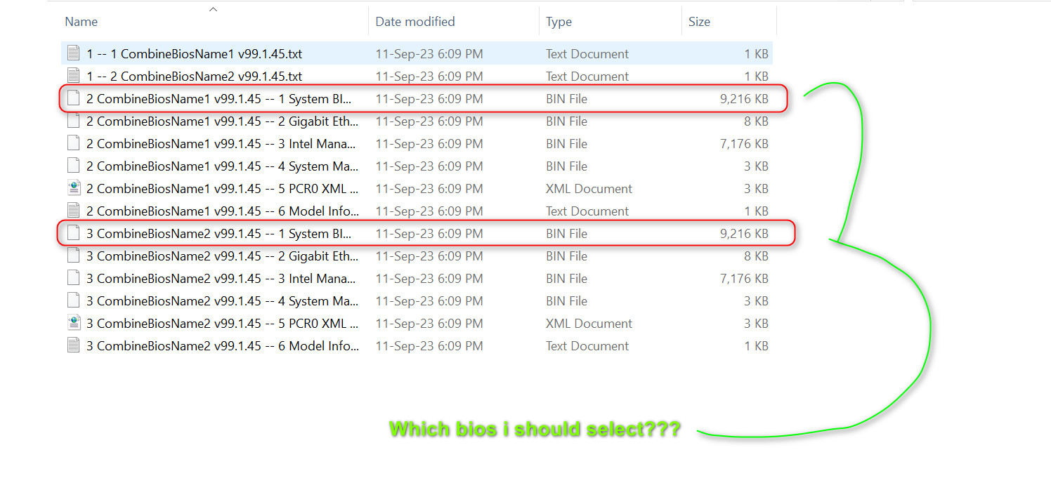

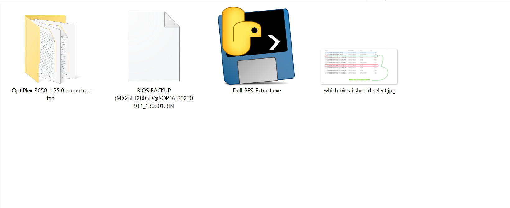

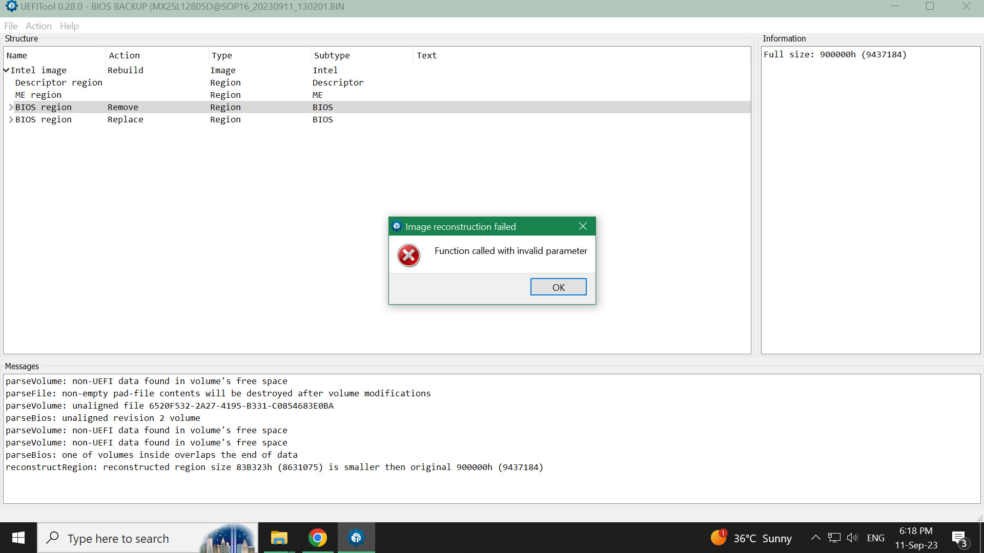

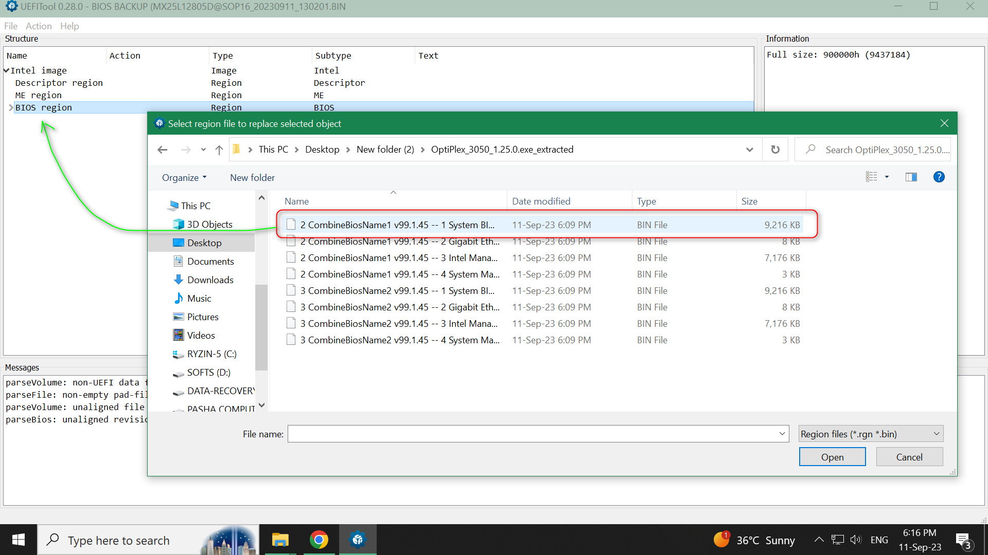

                  Re: Dell optiplex 3050 bios need
                  sir cleaned bios backup but no display
                  after
                  i tried to make a new bios through UEFITool Replacer.exe
                  i extracted bios by Dell_PFS_Extract.exe
                  Successfully extracted but there are 2 bios in the folder
                  but when i tried to replace both of them 1 by 1, i got error every time
                  i want to why this is happening
                  Any help will be appriciated
