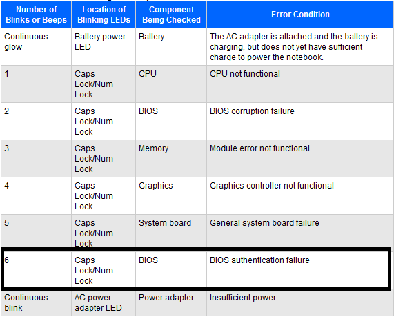

      Re: HP COMPAQ 8100 Elite SSF BIOS
      6 beep

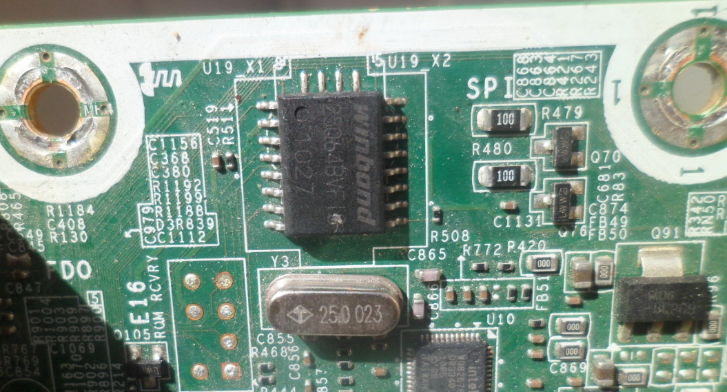

          I can take it
          i haven't the adapter or the adapter d'ont working for me
          i have minipro TL866CS
          • kadi144
            • Aug 2015
            • 690
            • algerie
            Here is the chip bios
            can i use the chip bios with 8 PINS ؟ how can i to place it
              The board is
              MS-7557 VER 1.0
              here is my backup :
