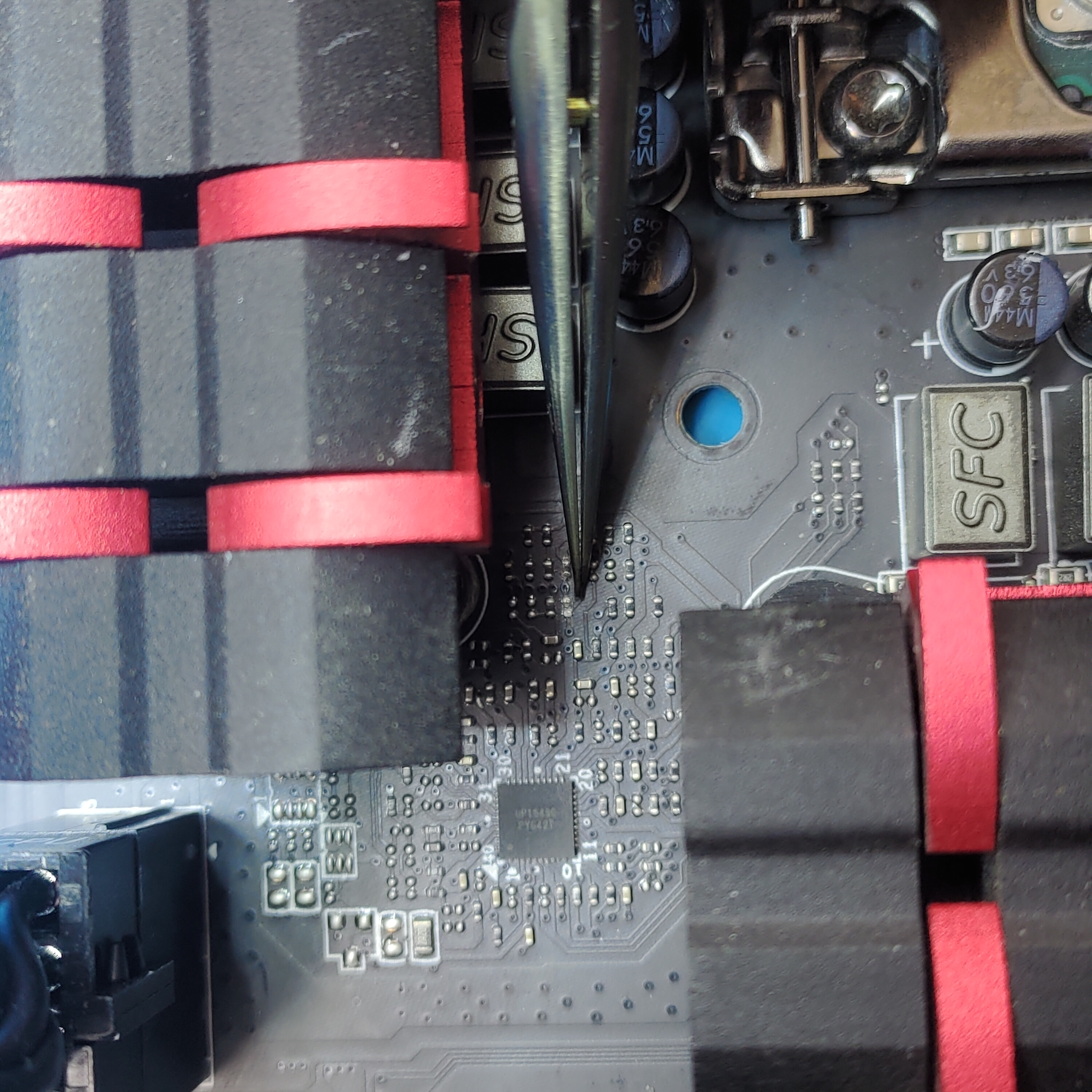

          Re: MSI Z97 Gaming 5 D0 post code
          I have same code, also got no vcore. I seem to be missing a resistor
          Anyone have a clue what value?
