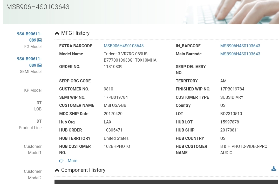

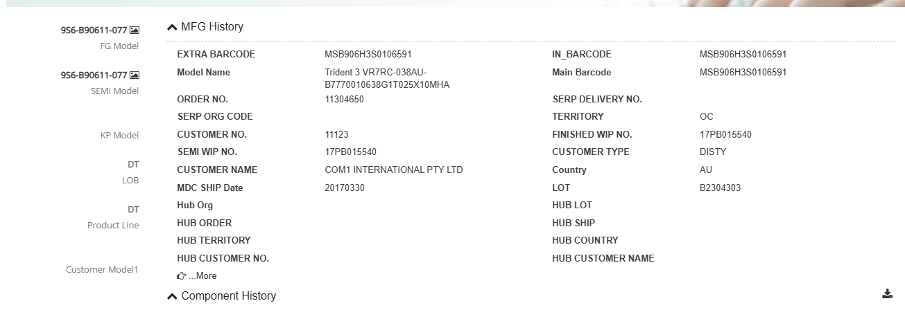

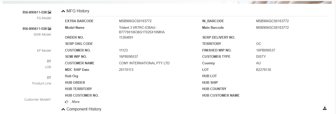

          S/N
          MSB906GCS0103772 / PCBv1.0
          MSB906H3S0106591 / PCBv2.1
          So motherboard is different.

                  want exact. you need to provide s/n back of case
                  or sticker on pcb
                  • Spider1211
                    • Oct 2019
                    • 532
                    • Mauritius
                    SN: MSB906H4S0103643
                    • noname2024
                      • Aug 2024
                      • 291
                      • CỎ MỸ XỊN
                      Ec is 256kb.​
                      Click image for larger version  Name:	Screenshot_2025-02-21-22-54-50-35_e4424258c8b8649f6e67d283a50a2cbc.jpg Views:	0 Size:	175.0 KB ID:	3577826

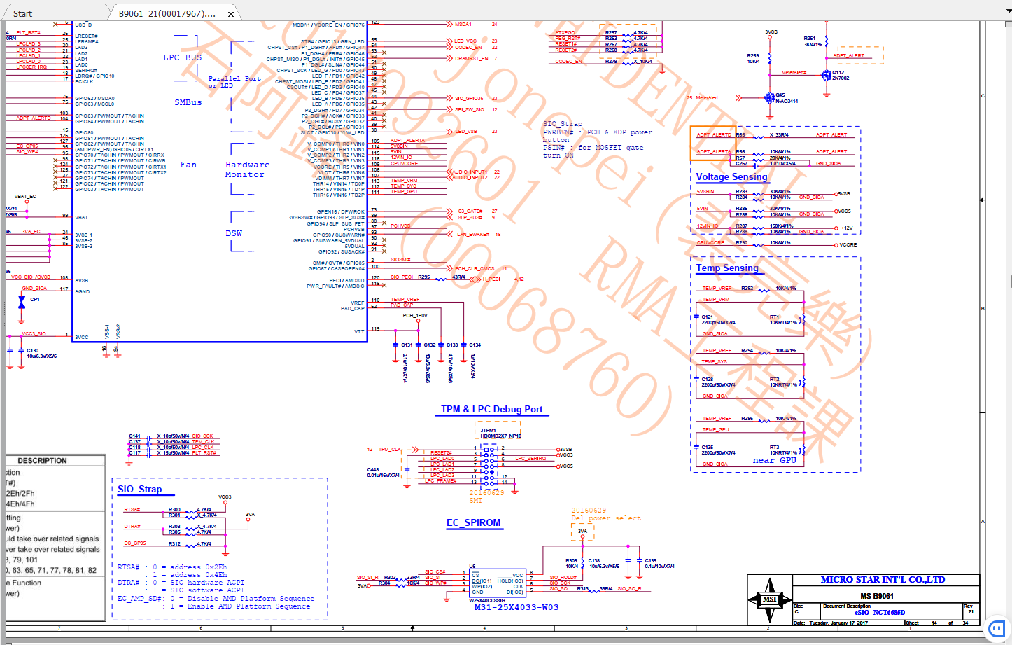

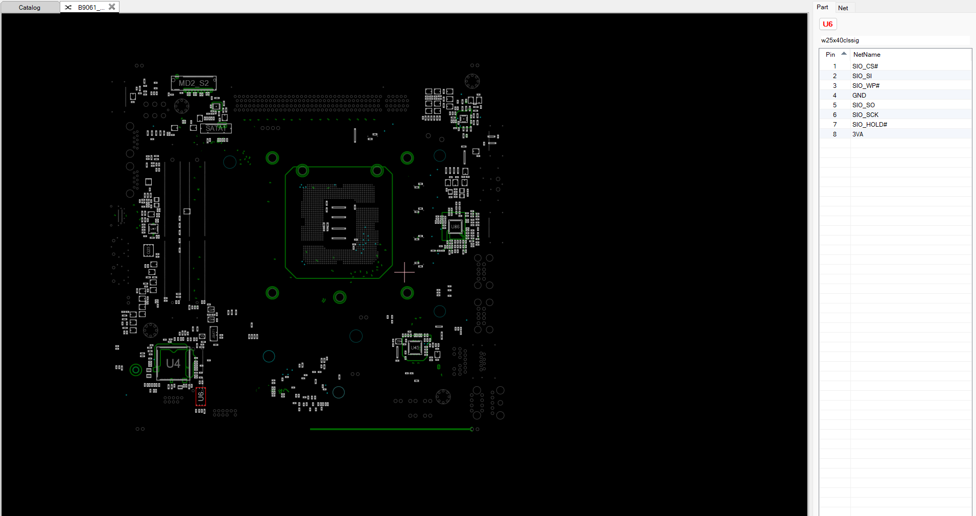

                              noname2024Just tried. no change. Guess time to dig further. Any chance you can share boardview and schematic please?
                              currently: board idles at 84-110mA. When power button is press, current goes to 305-311mA. Most voltages are present except core and 12V (pcie is think). No light on power button when pressed.
                              • noname2024
                                • Aug 2024
                                • 291
                                • CỎ MỸ XỊN
                                Sorry. this is msi confidential information. i can not share schematic or boardview. there are some people who take data from badcaps and post it for sale on some russian - ukraine forums
