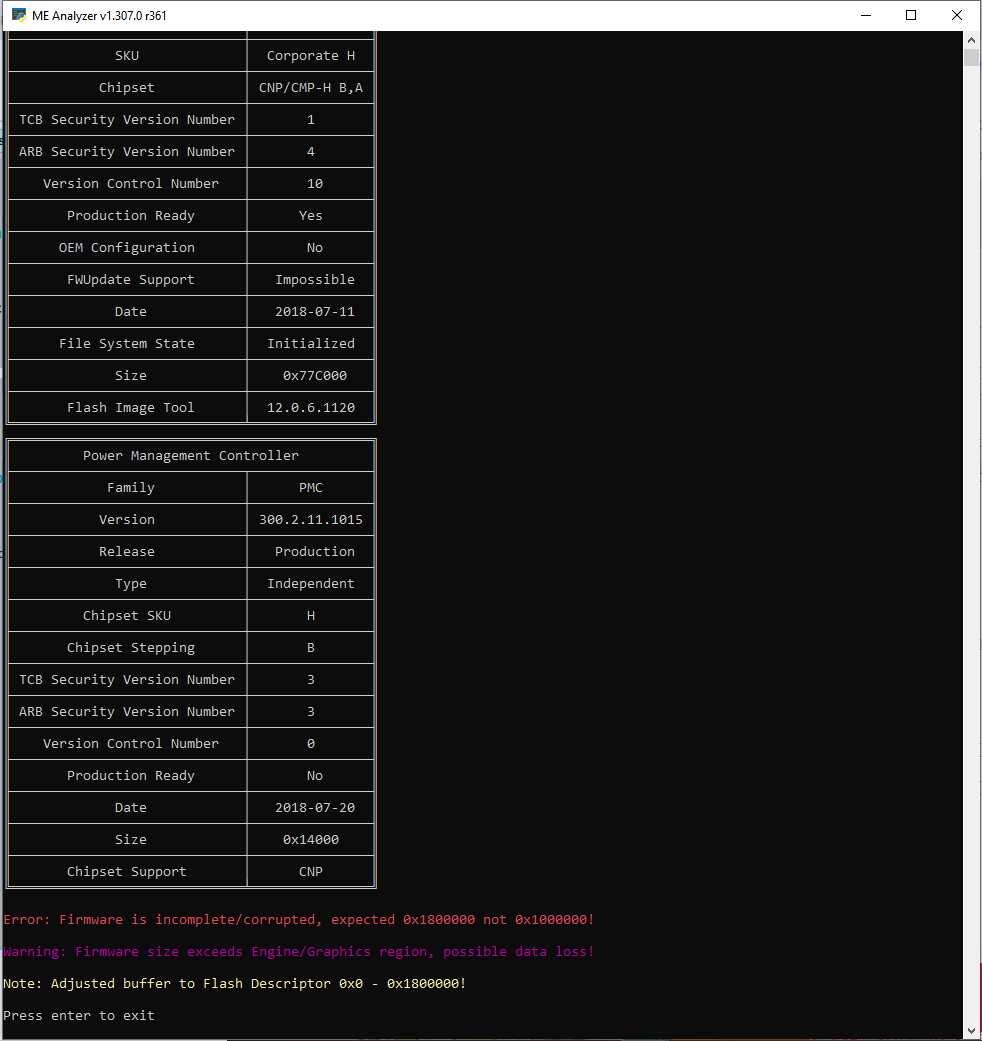

    power on & no display
    S.N: PC152D96
    M.Type : 10SG
    my backup
  • samsung12
    • Sep 2015
    • 10
    • egypt
    I tried the file in this topic and it worked well, but it took 45 seconds to display the data
    https://www.badcaps.net/forum/troubl...tre-m720s-bios
    Do you have any advice?
      https://www.badcaps.net/forum/troubl...22#post1622422
      • samsung12
        • Sep 2015
        • 10
        • egypt
        thx bro
        I already cleaned it, but after flashing the motherboard does not read any sata hard drive ☹
        can you help me fix my backup?
            hello any help?
            Read chip again , backup fault.
            • samsung12
              • Sep 2015
              • 10
              • egypt
              Thank you brother, the problem has been solved​
