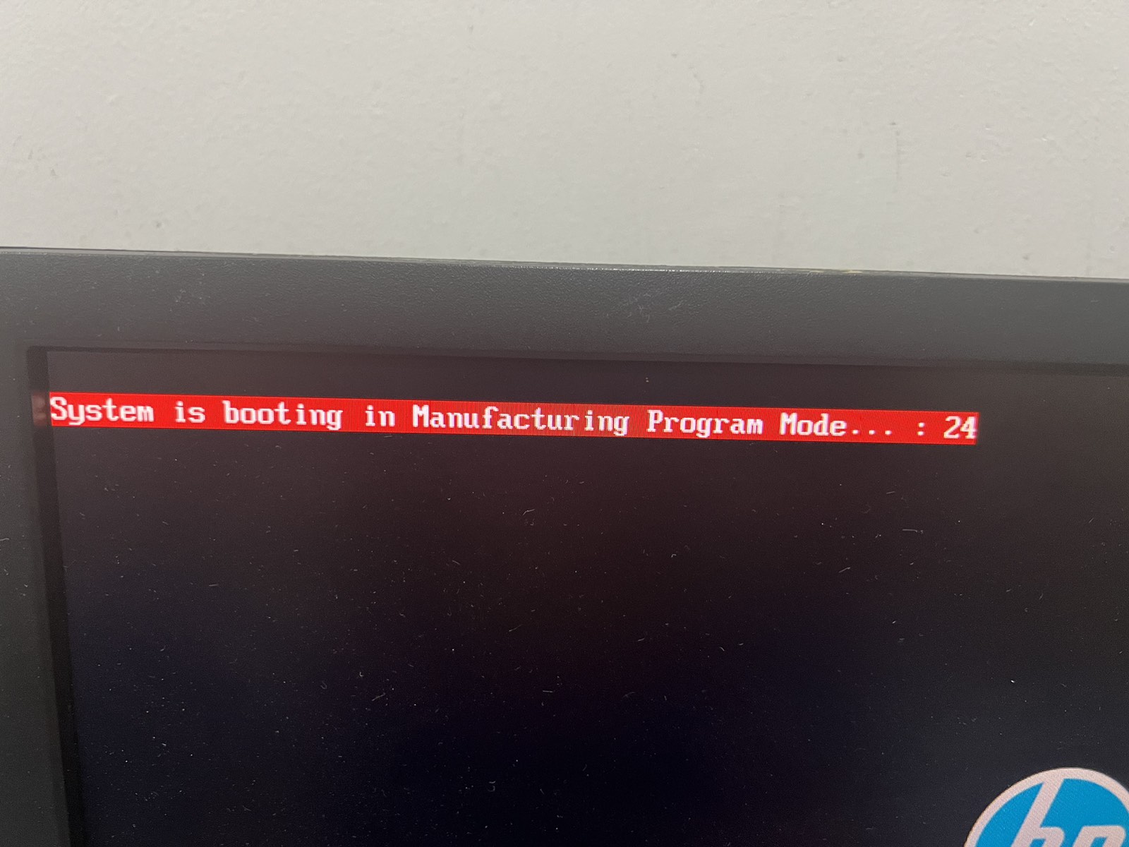

    Hi everybody !
    I met the issue "HP Endpoint Security Controller Problem" after updated the latest firmware. I tried to rollback the old firmware but it did not work.
    Model : HP Elitedesk 800 G4 mini (35w)
    16mb bios attached
    Please help !
    Thank you so much

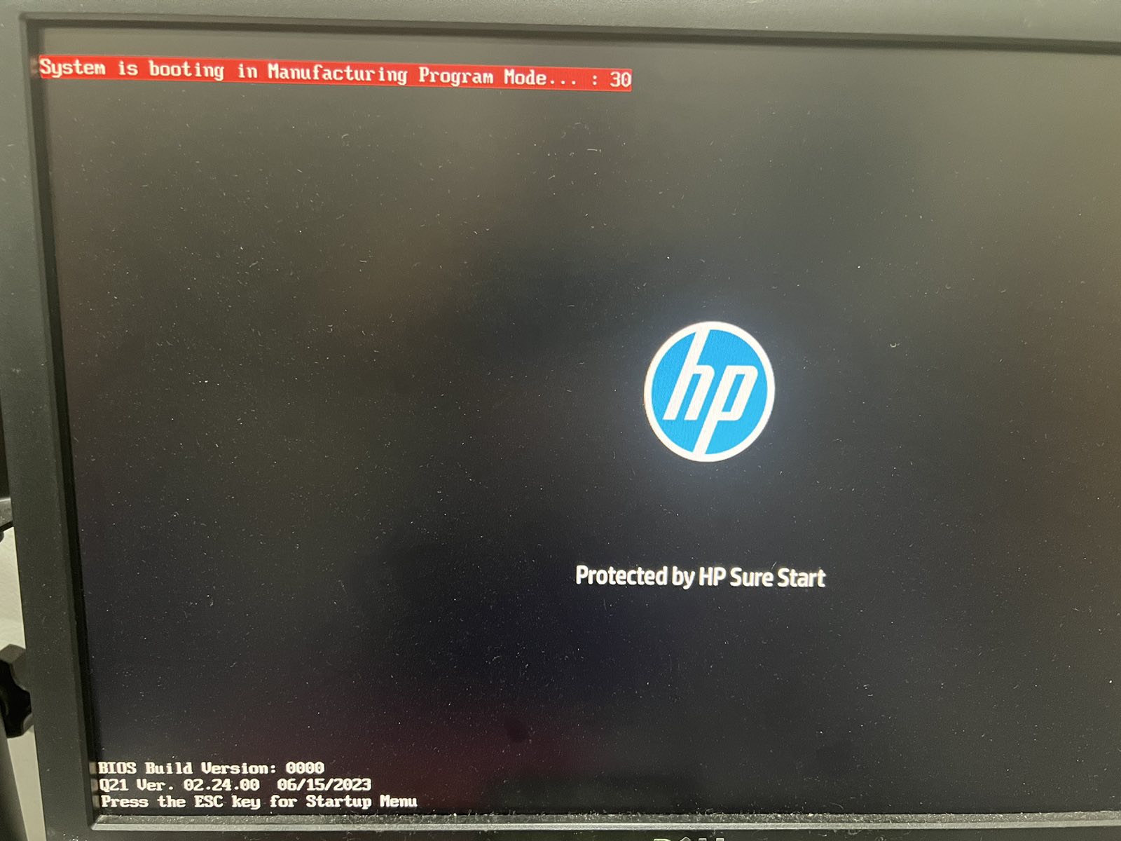

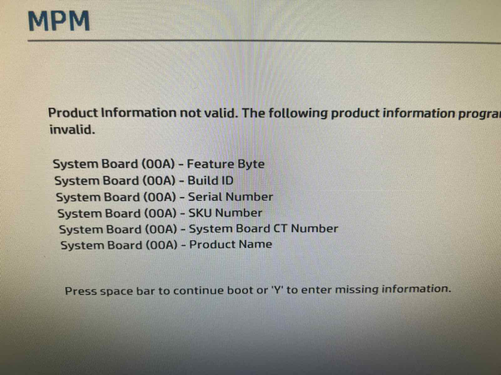

        Hi !
        After flashed 16mb and 32mb bios files, the system boot but I met another errors .Also the SKU and the serial number disappeared.
        => errors attached.
        Thanks man

          Finally, I go to the bios and put all the informations (can find out on the label at the bottom cover) as the request and now it work perfectly.
          Thank you so much to Hoaca388 and Badcap forum.

            hi,did you flash 16mb to 8pin chip ?oteher one to 16pin ?
            thanks
            • vuiquata007
              • Jan 2022
              • 14
              • Vietnam
              thanks
              Correct, 16mb to 8 pins bios chip and 32mb to 16 pins bios chips
