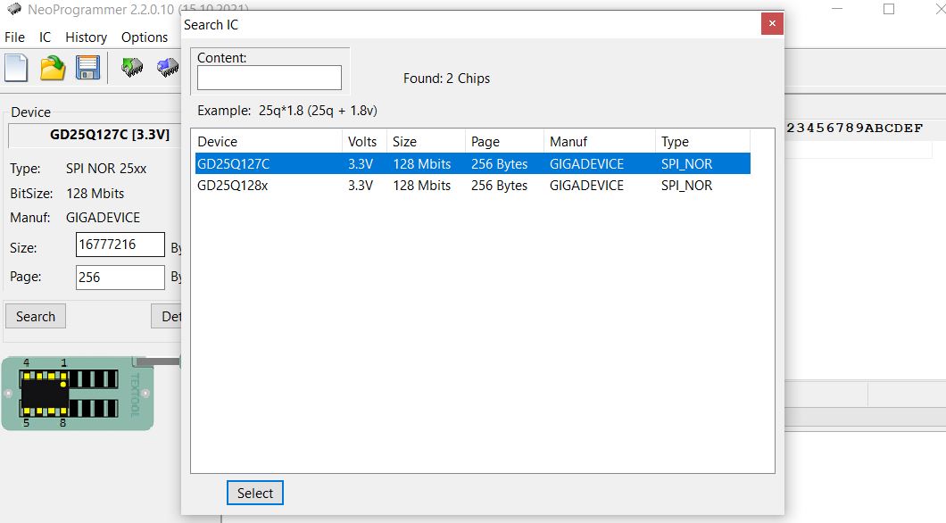

                    • hiroshxd
                      • Jul 2023
                      • 4
                      Re: Help HP Elitedesk 800 G6 Mini PC LOCKED BIOS
                      Originally posted by Arrow16
                      Upload your dump file
                      I do not know why. But the program shows me 2x 16 mb chips. I checked the connection twice. Doesn't look right to me? I've uploaded both. I'm a total newbie sorry.
                      maybe the wrong chip.
