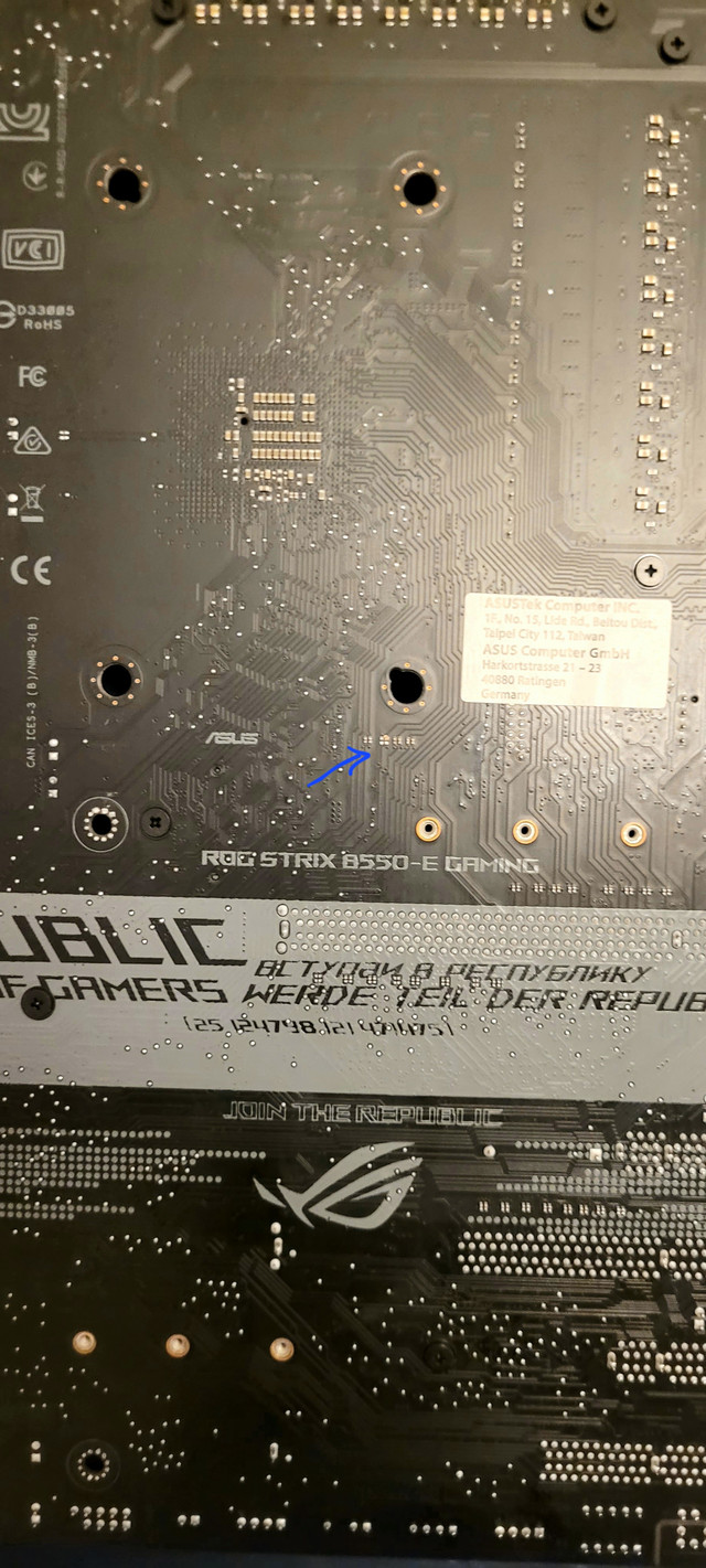

    Can you post the full motherboard picture showing these caps?

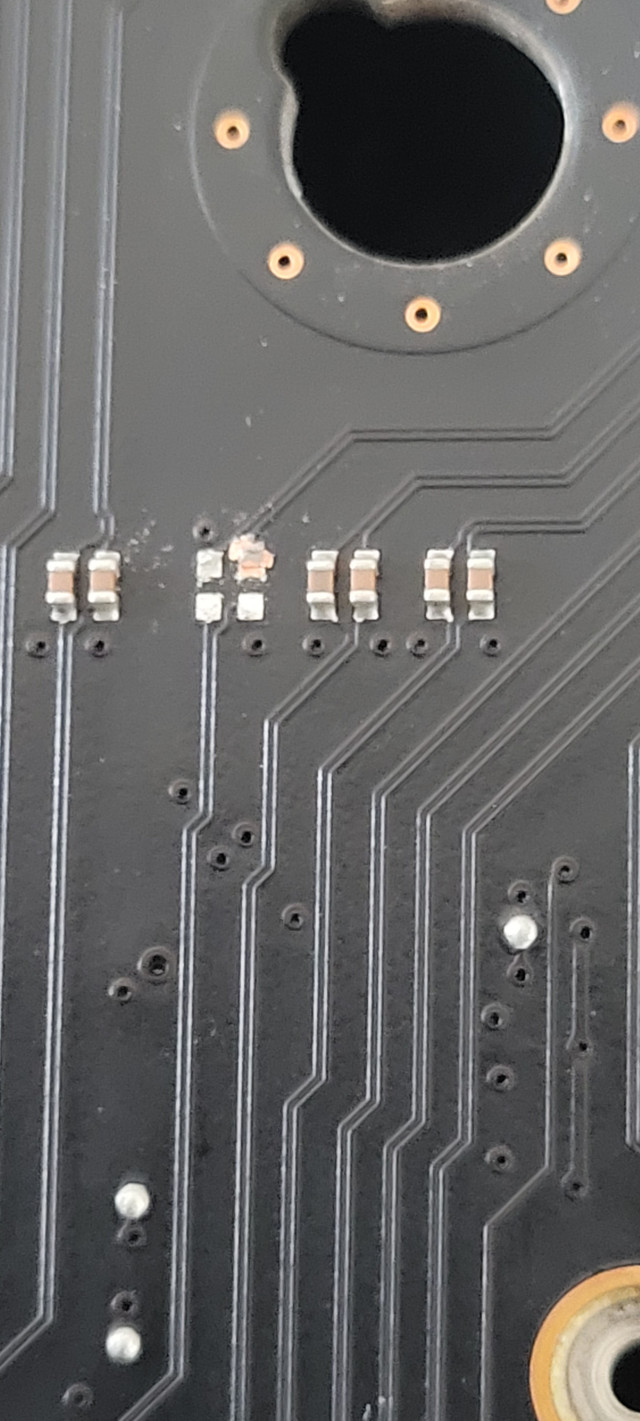

      It is on the backside of the MoBo.
      Channels that seem to power up the cpu.

        The capacitance of these capacitors will be the same as those of the adjacent ones.

          I thought aabout that, but how to know what their capacitance is?
          I have read that there are capacitymeters, but i have no knowledge about these things.
          That is why i am asking if there is a schematic or some info about these capacitors capacity.

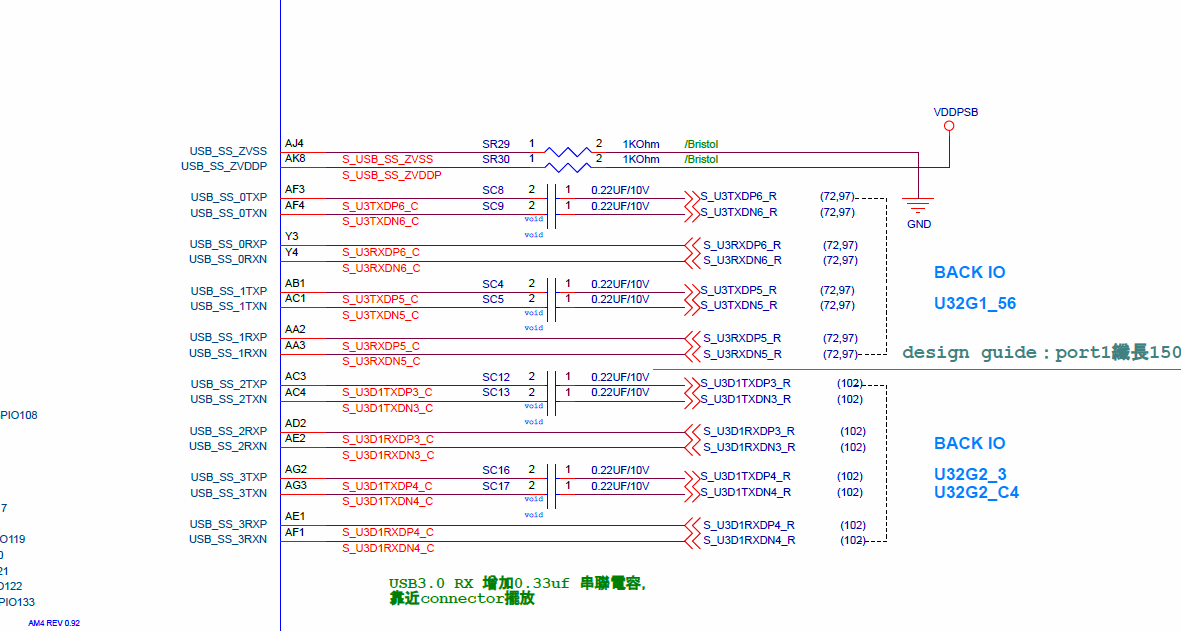

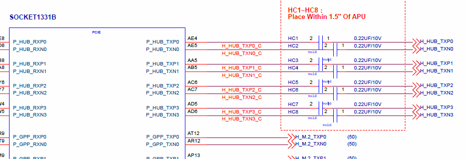

            Rather, focus on 0.22UF / 10V.
            • Blackdeath
              • Jan 2023
              • 6
              • Belgium
              Re: Asus B550 E gaming
              Many thanks! Will buy ones and fix it as fast as possible.
