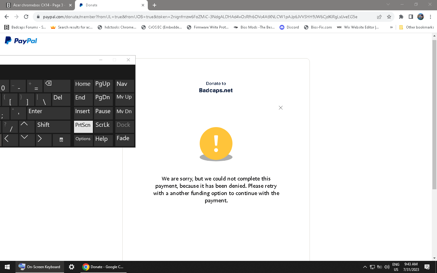

    unlock this pls
    and send me other side to donate maybe not pay pal where not using always pay pal
    thanks advance

      The Admin only accepts paypal donations at the moment. Try again later, if you ca`nt its no problem at least you tried.The Admin is always happy to receive a thank you message

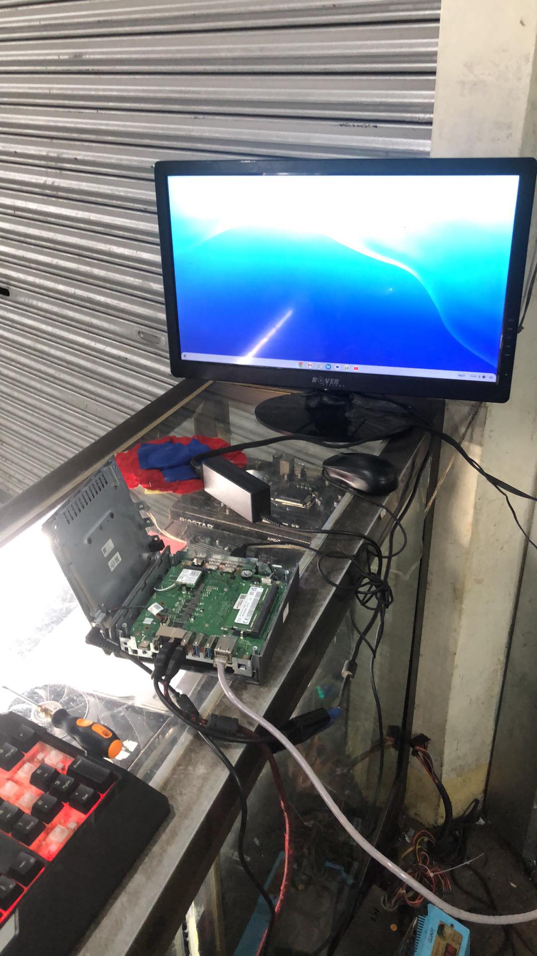

          acer CXi4 built EMMC chromebox
          unlock this pls built in EMMC
          thanks advance

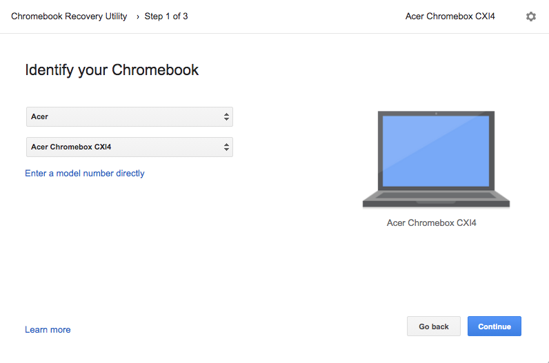

            reinstall from USB stick made for your model with Chromebook Recovery Utility after write new bios.

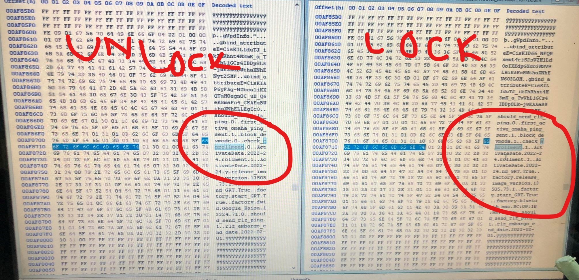

              #46
              Re: acer CXi4 built EMMC chromebox

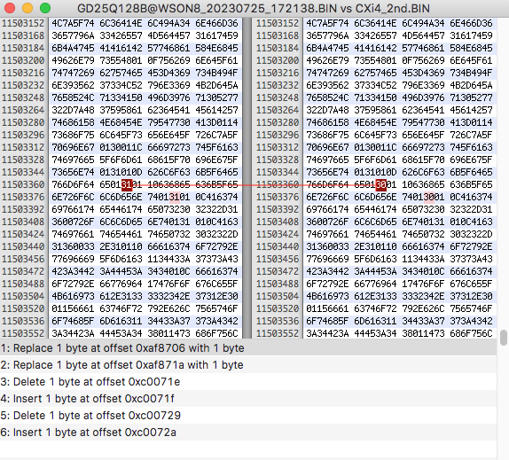

              you are greatemaster thank you
              i try manual HxD editor master i
              enable dev mode and disable enrollment
              but i can't install recovery
              i compare the 2 BIOS
              UNLOCK YOU GIVE AND LOCK BIN
              HOW CAN I MAKE IT RUN TO OTHER UNIT
              THANKS YOU

                #47
                THANKS YOU
                compare again, there are 6 modifications ... Create USB disk as indicated and insert it in USB port then power on laptop, it will start recovery itself.

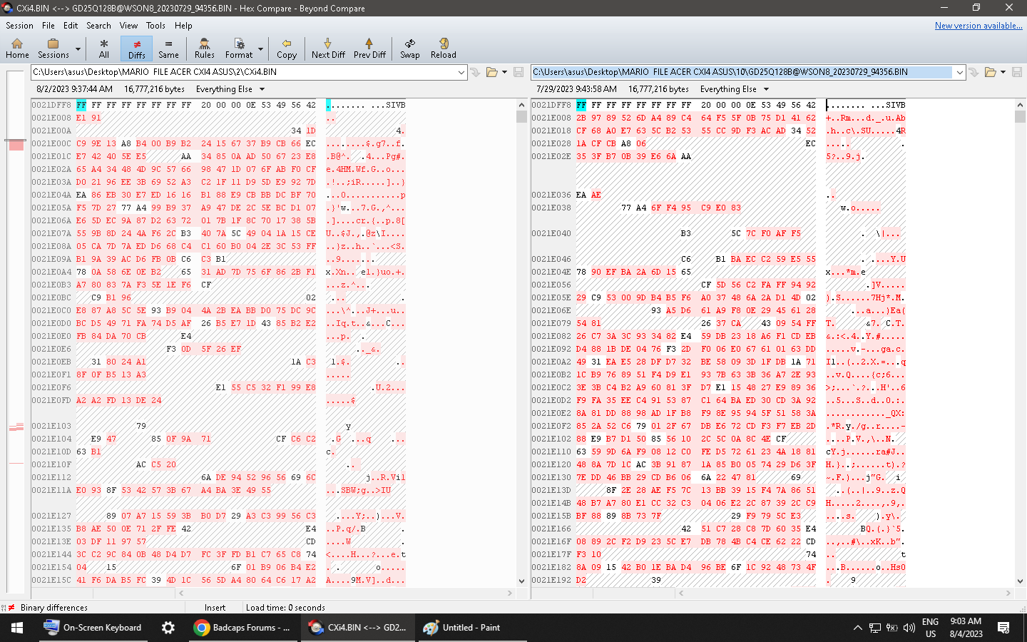

                  i try to edit mater but i try same model
                  so many different may i be need a clear dump file for cxi4 i extract the ME in other working
                  bin you send but if i copy your bin to other not display and restart pc
                  how to edit so i cant make my own help me pls thanks advance master

                    #49
                    dosn't work that way, you have to modify each bios.

                          reinstall as you made with 1st one. If you want to LEARN (and not doing something mechanical) how to deprovision a chromebook there are a lot of threads in this great forum about this, you just have to read them. This is how I learned.

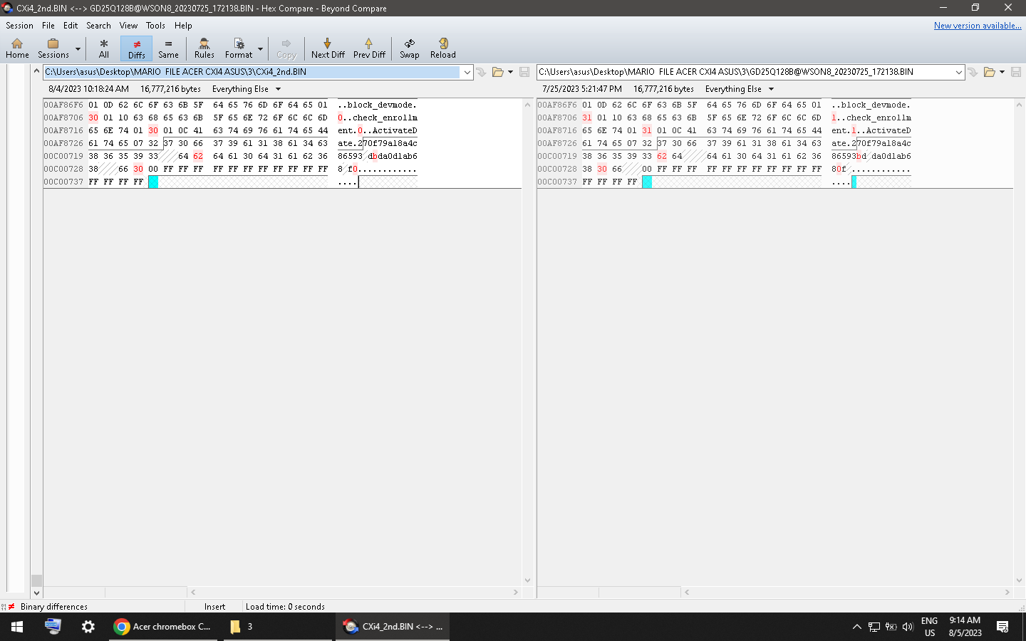

                              #54
                              this is the cxi4 2nd that you give i compare to stock bin
                              you make 6 different how ? only
                              but if i compare the unlock you give to other unit but same model lock there's more different hehe challenging i want to do it give me some tips master hehe
                              im searching i want to make this so i cant help to other tech newbies
                              thanks advance

                                          #60
                                          thanks advance
                                          you have to compare original .bin file against modified .bin file for THE SAME LAPTOP!
