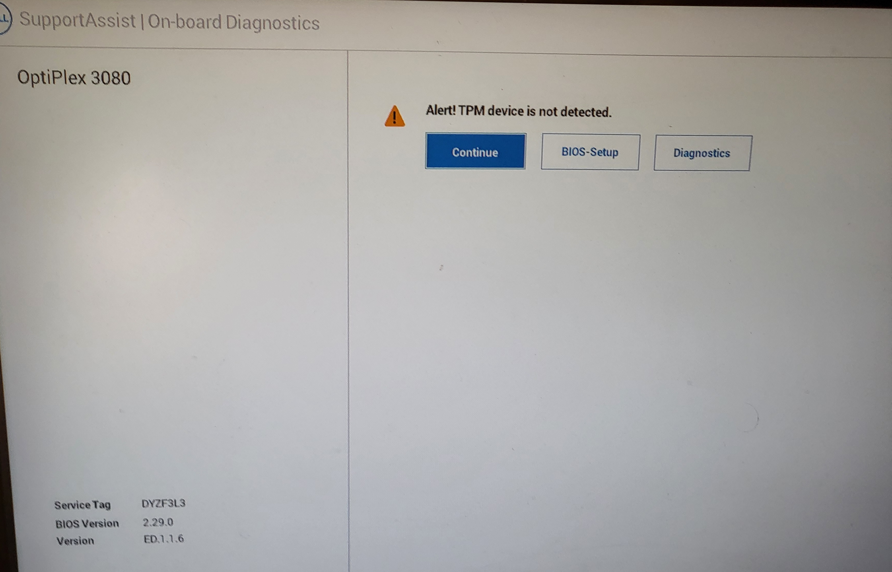

                        • kuiri
                          • Jun 2024
                          • 11
                          #53
                          Originally posted by hoaca388
                          Unlocked
                          Hello, I had a dead 3080 Micro (No video, no lights, no fan spin) and I flashed the bin above, it worked and I could write the service tag now, however the computer takes a very long time to start. Upwards of 15 seconds to show video output and the dell logo.
                          Also it shows the error "TPM Not Found" I tried to remove the CMOS Battery, held the power button for 30 seconds and the BIOS settings reverted to factory, Absolute was enabled and TPM was visible in the BIOS.
                          I disabled Absolute, rebooted and TPM is not showing in the BIOS anymore but I don't get the error in the picture anymore.
                          Is also running windows 11 normally, drivers installed, latest bios and firmware from dell.
                          Do you recommend reflashing a different variant or BIOS?
                          I still have the original dump where no video no lights, etc.
                          • hoaca388
                            Badcaps
                            • Jan 2022
                            • 11286
                            • Viet Nam
                            #54
                            Post the bios that worked for you along with the Service number.

                                  • kuiri
                                    • Jun 2024
                                    • 11
                                    #58
                                    The BIOS that worked for me was on the reply #17 of this post:
                                    https://www.badcaps.net/filedata/fetch?id=3228706
                                    That's the direct link just so I don't upload a duplicate file
                                    ST: DYZF3L3
                                    • hoaca388
                                      Badcaps
                                      • Jan 2022
                                      • 11286
                                      • Viet Nam
                                      #59
                                      ST: DYZF3L3
                                      Try
