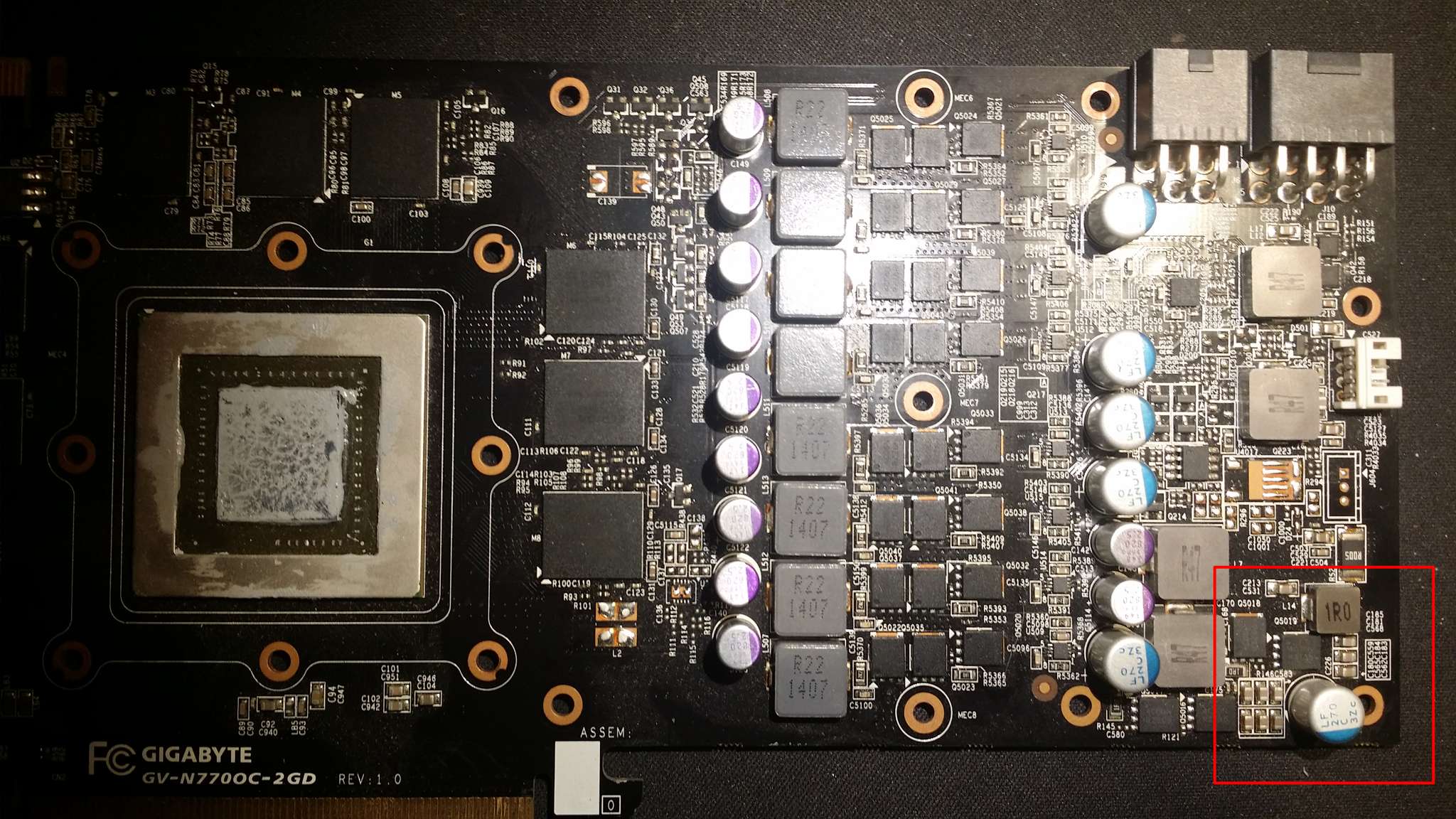

    Hi folks, a GPU repair newbie here, kindly asking for a help with my GTX770,
    - the PCI 12 and 3V (kOhms to GND) as well as VCORE (~ 25 Ohms to GND, maybe too low?) seems OK
    - there is a short (<1 Ohm to GND) in bottom-right section of the card (see image), both the inductor and capacitors around.
    What is this powerline? 5V, PEX?
    Can I just inject voltage, say 1V?
    Or is it one of the mosfets? Can I test them in circuit?
    Thanks for your tips, JP

    Re: Gigabyte GTX770 repair attempt
    Test mosfets in circuit: red probe on ground and black probe on pins !
