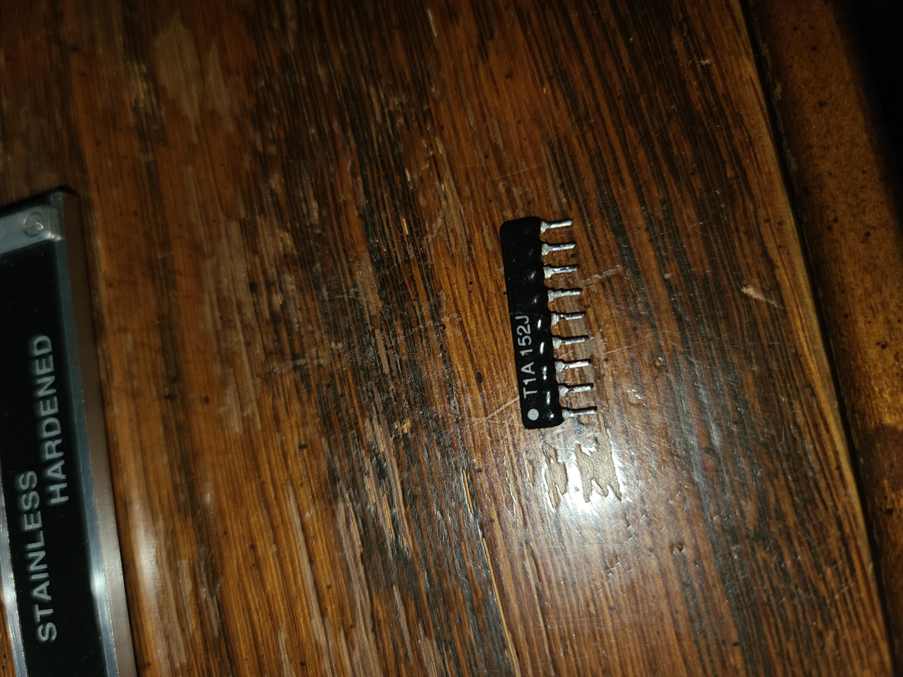

    Long time, no post for me.
    I was hoping I could lean on you to help me identify a component.
    I know that this is 9 pin SIP resistor array, I am guessing it is 1.5kOhms. The markings are so generic though that I cannot glean any further information about it. Google searches have not revealed any useful information.
    I am hoping somebody here might be able to tell me a little more about it, is it isolated, bussed, circuit configuration, etc?
    It came from a Shuttle HOT-433 486 motherboard, I noticed that it was cracked while I was doing a visual inspection of the board. It was from RP10 on the board.
    Thanks for any help you can give.

    Check it with your meter, likely pin1 is common and each other pin will be 1.5k
