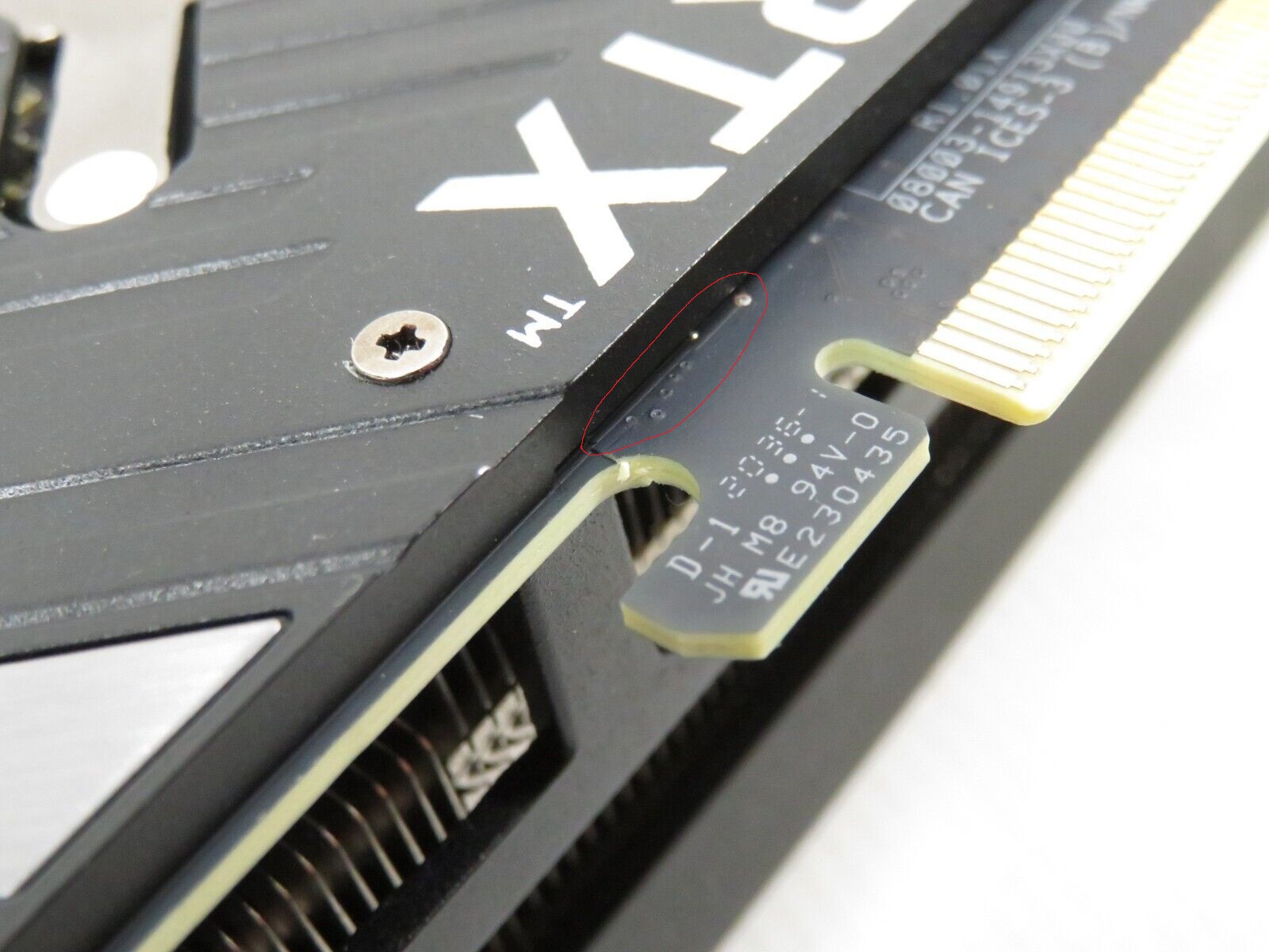

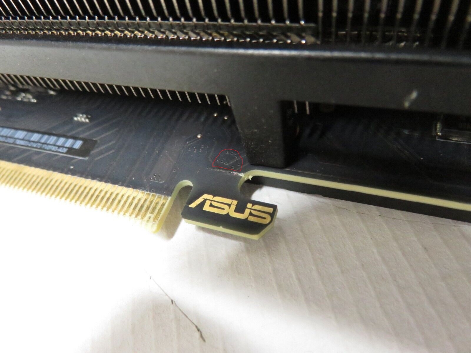

    Hi all. I got my hands on a stryx 3090 with a cracked PCB. Sadly I don't know its history. On initial tests there was very low res on the 1.8 inductor. After working around the damaged area the res has risen to around 280 ohms. Not sure if this tells me anything yet as some tracks are open still atm.Before I add voltage would like to know where the vias go (please see pics)if possible. Thanks for any correspondence.

    Ok. Decided to leave the VIAS around the damaged area alone for now until more data is available. However I have tested a short on gold finger B10 which I believe is the 3v3 AUX CON. I only have a TUF 3090 pdf schematic to work off which has been handy for some tracking but not so much for the strix variant (can't find U517) Any help would be much appreciated. Thankyou.

      Can anyone tell me what type of readings to expect on B10 gold finger pcie 3v3 aux con? Please....Anyone?
