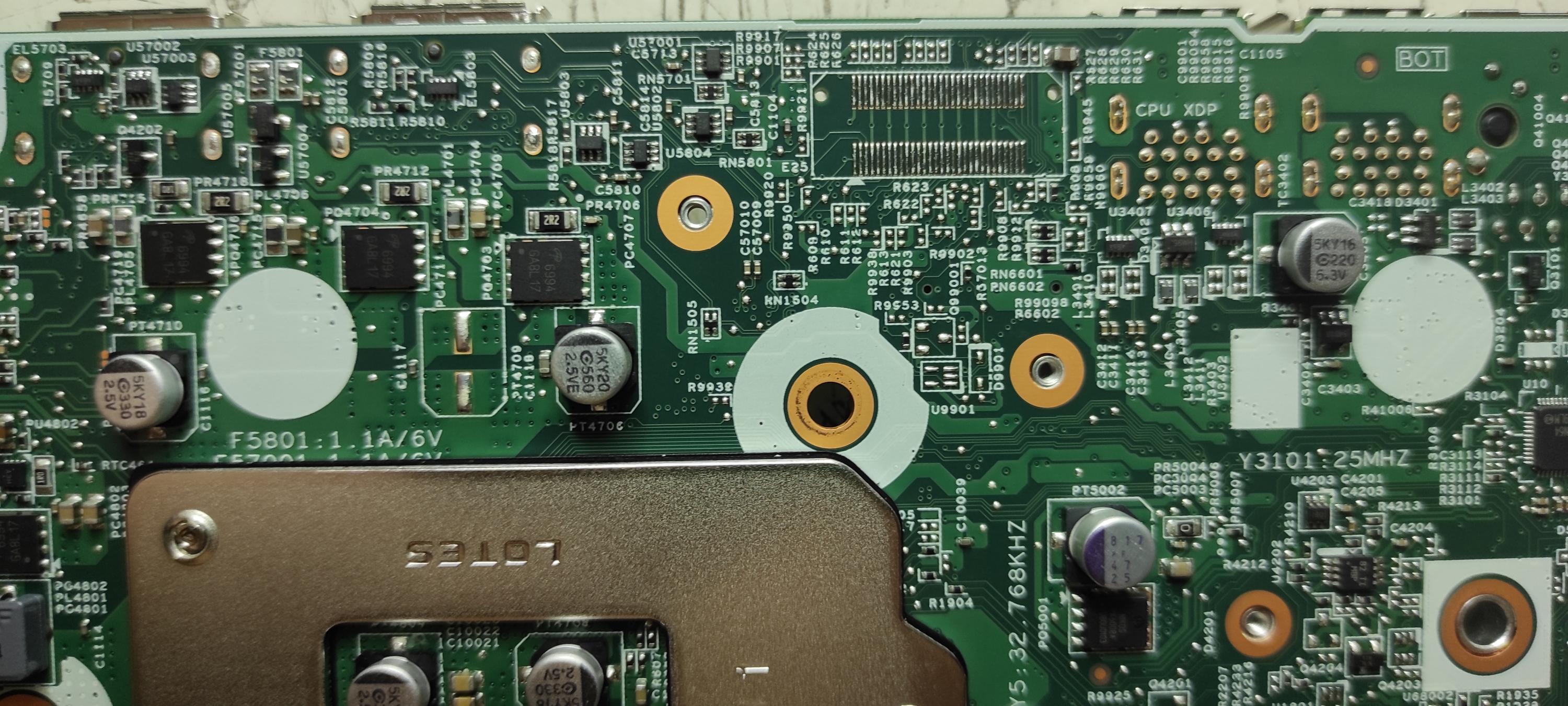

    HP 800 G3 mini No cpu fan detected
    Hello!
    I received a 800 G3 mini with "no CPU fan detected" error, i already tried 4 fans for this particular model with no luck, so the problem is on motherboard, furthermore there are no schematics available for this MB and i'm blind here.
    I attach close MB pictures and fan wiring too.
    Perhaps if i follow the id cable i'll get somewhere?
    First picture is opposite the fan connector.
    Any advice welcomed.
    Thank you!
  • Andreasbest
    • Aug 2014
    • 1163
    • Hellas ( Greece )
    Re: HP 800 G3 mini No cpu fan detected
    All good, repaired, the first SMD right after pin 3 (tacho & id) had broken solder.
    Closed.
