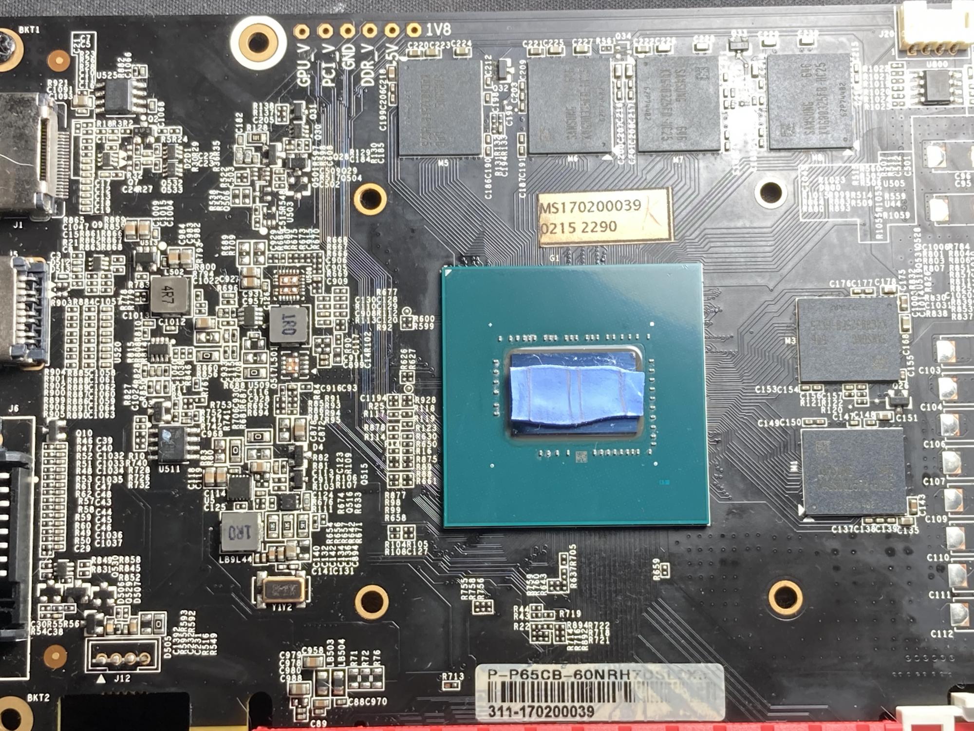

    Hi all. I was decluttering my storage room the other day and came upon my dusty dead gtx 1060 and 1070. The 1070 is a Zotac 1070 mini and have since repaired it (mosfet short). Now all I have left to repair is this Galax GTX 1060 6gb OC (it died about 2 years ago). One day I turned on the pc and no display, but it did boot into windows. Tried on another rig then and still no display. So gave up and bought another replacement for it.

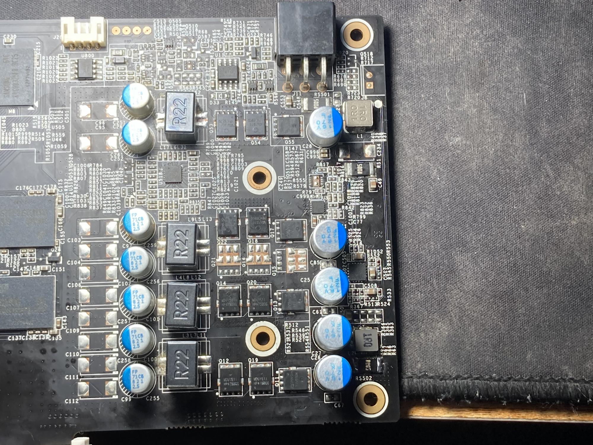

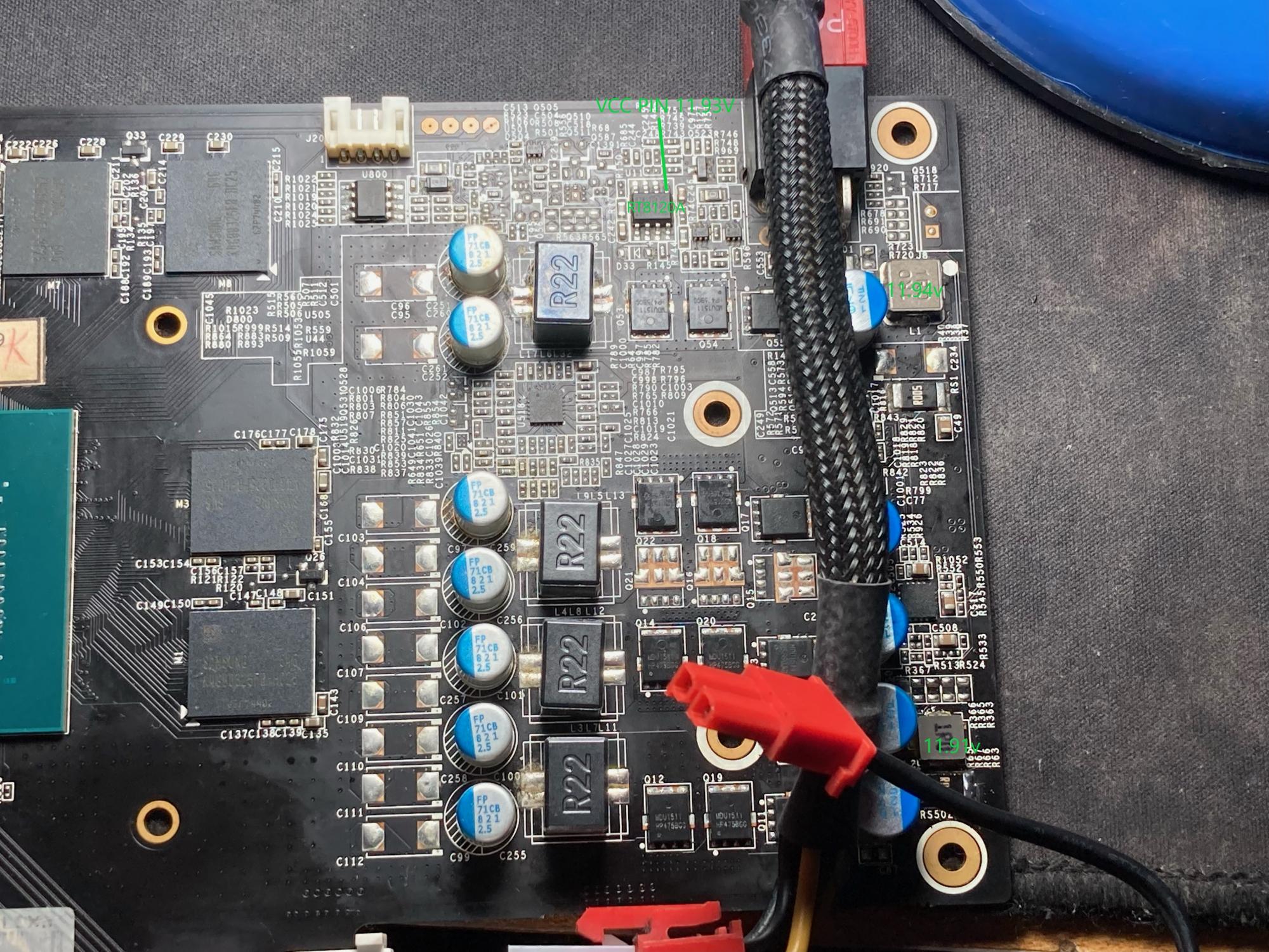

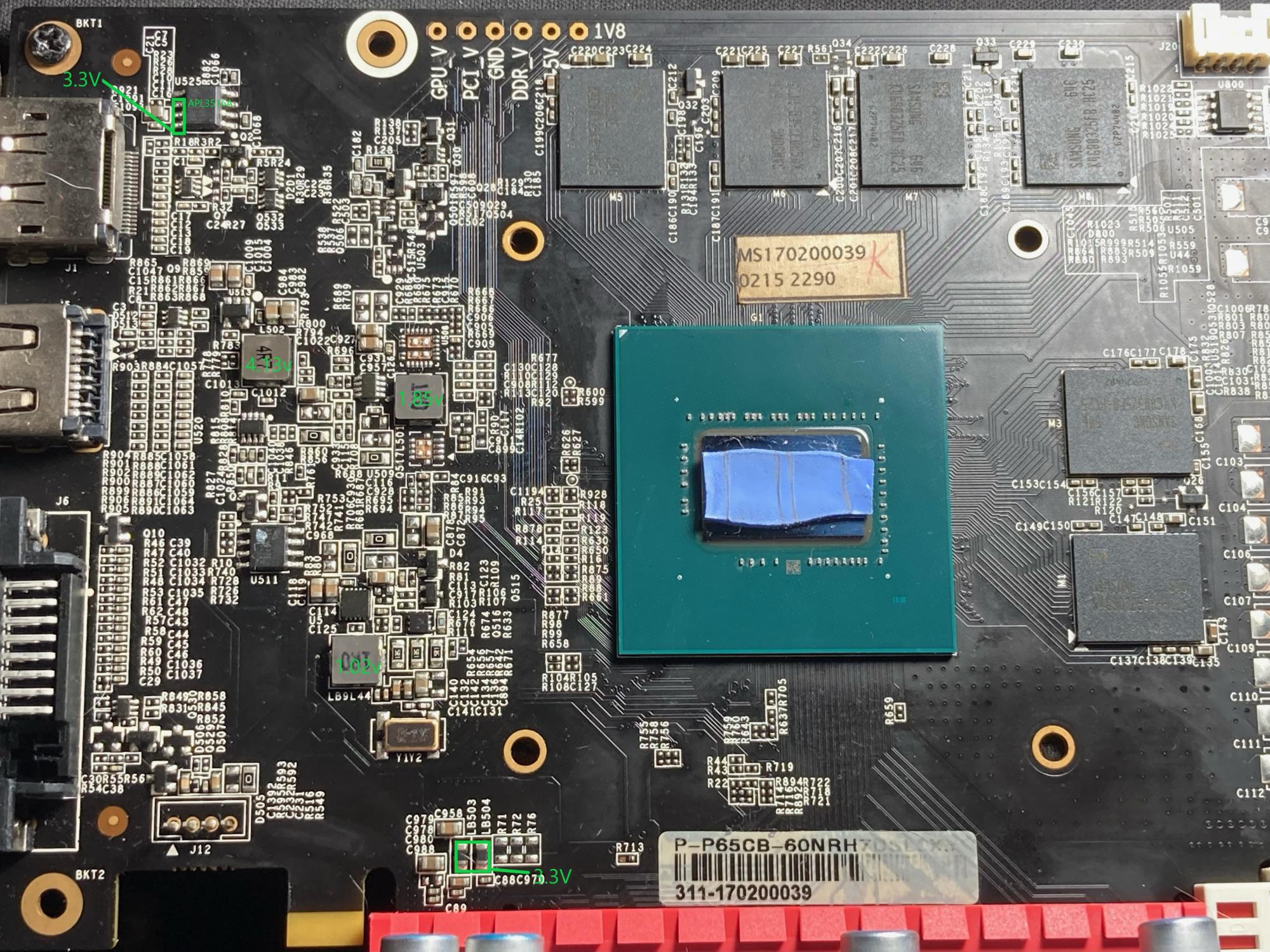

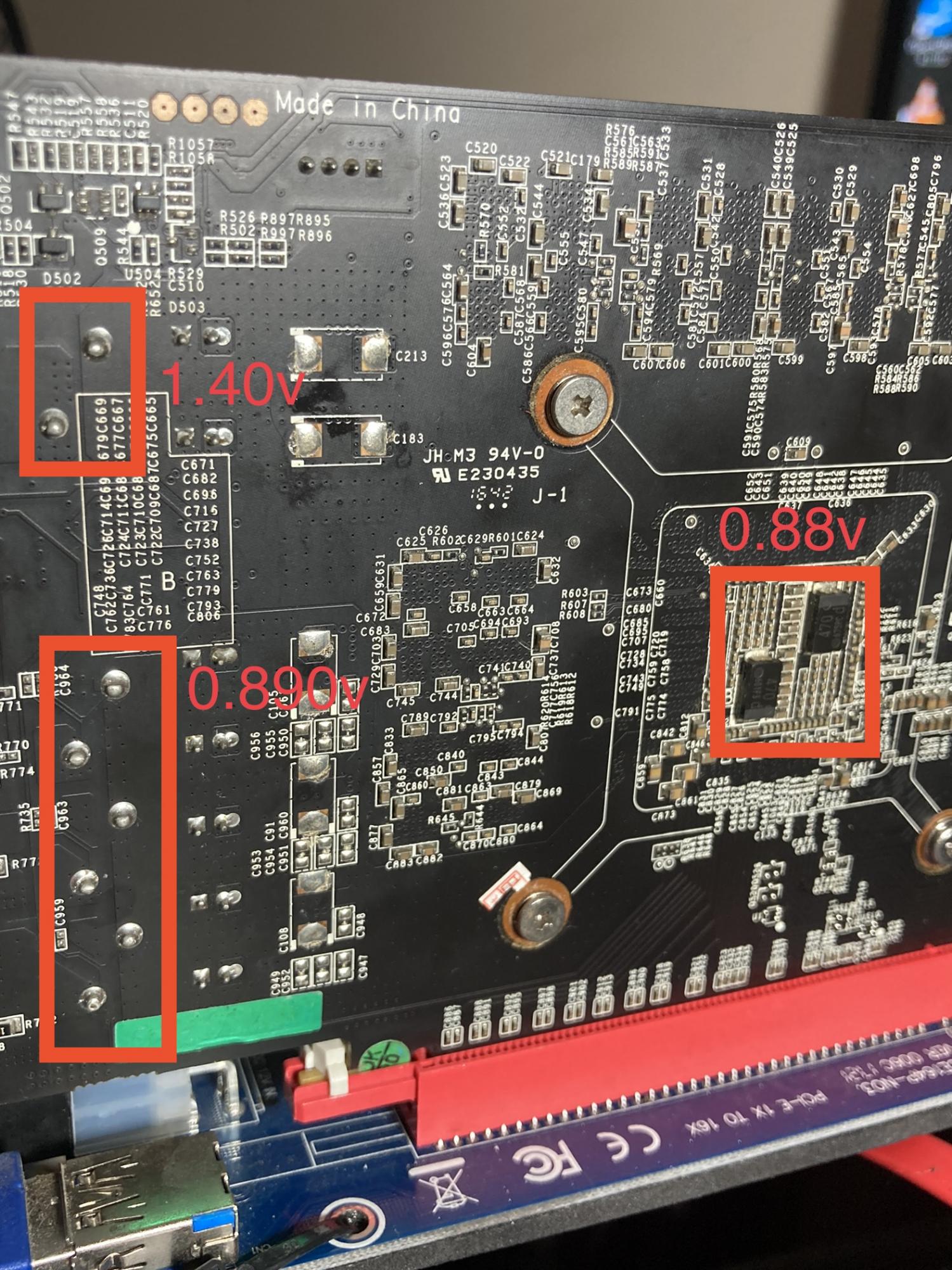

    I'm a beginner when it comes to gpu diagnostics and repair, but trying to learn as much as I can on here and elsewhere where I can soak up as much knowledge as I can. Okay so with this 1060 the gpu core gets warm as does the vram chips, both fans spin, but no display output. Pics attached are voltages I've measured so far. I'm probably missing a lot more areas to measure, so please let me know where else to measure. Thank you for any help and advice!

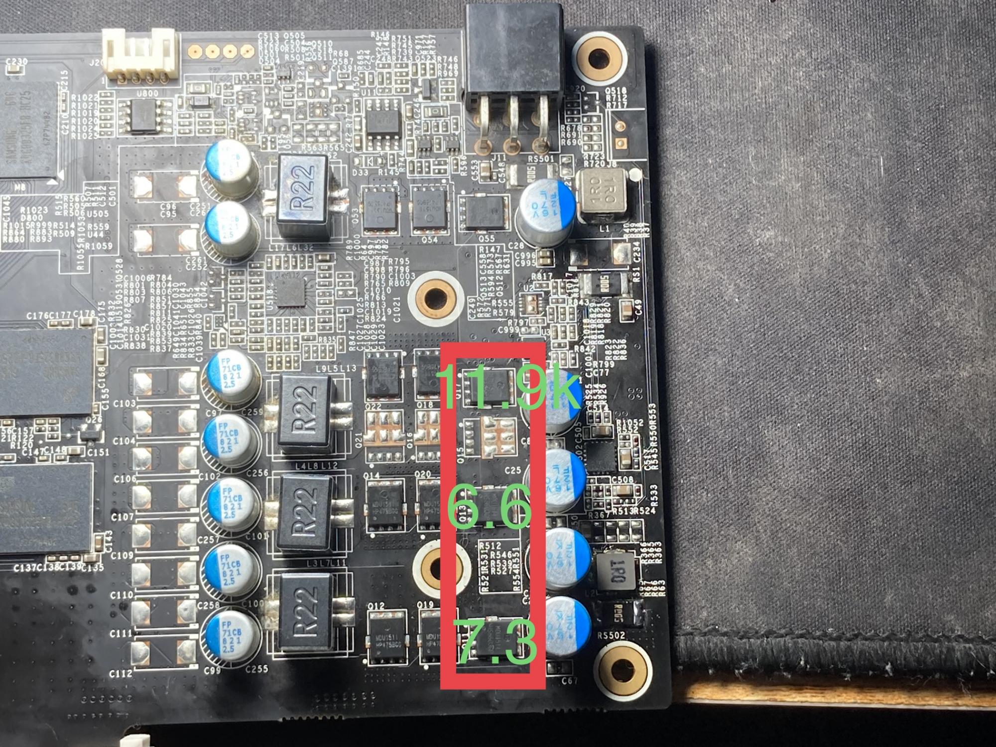

    I measured the vcore mosfet and 2 are showing 6.6 ohm and 7.3 ohm. Other one shows 11.9k.https://drive.google.com/file/d/1cV_...w?usp=drivesdk

      so why dont u replace it. it is basic mosfet that are everywhere

        As far as I see the pictures you sent. You do a pretty good job of measuring the base voltage. But personally. I see your GPU has cracked. Usually it doesn't live, and if it does, after a few years of use it will also throw an error on its own!
