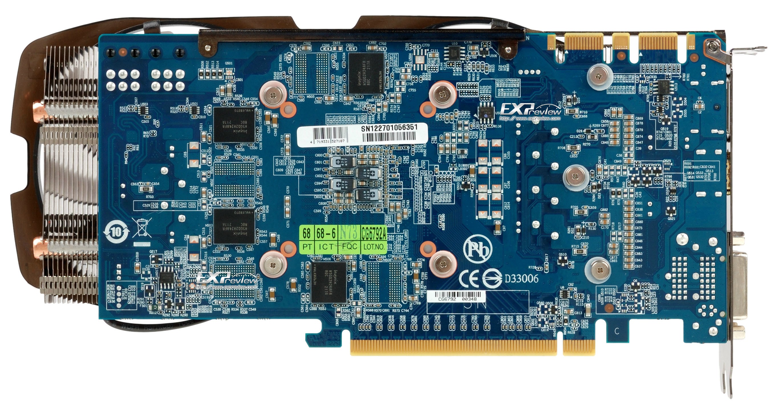

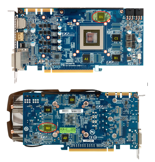

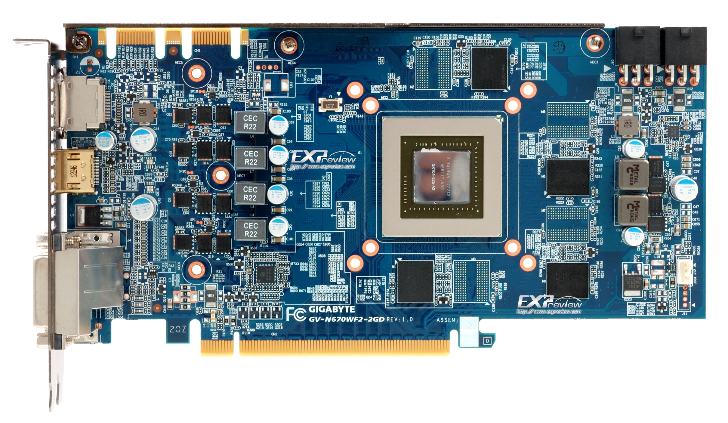

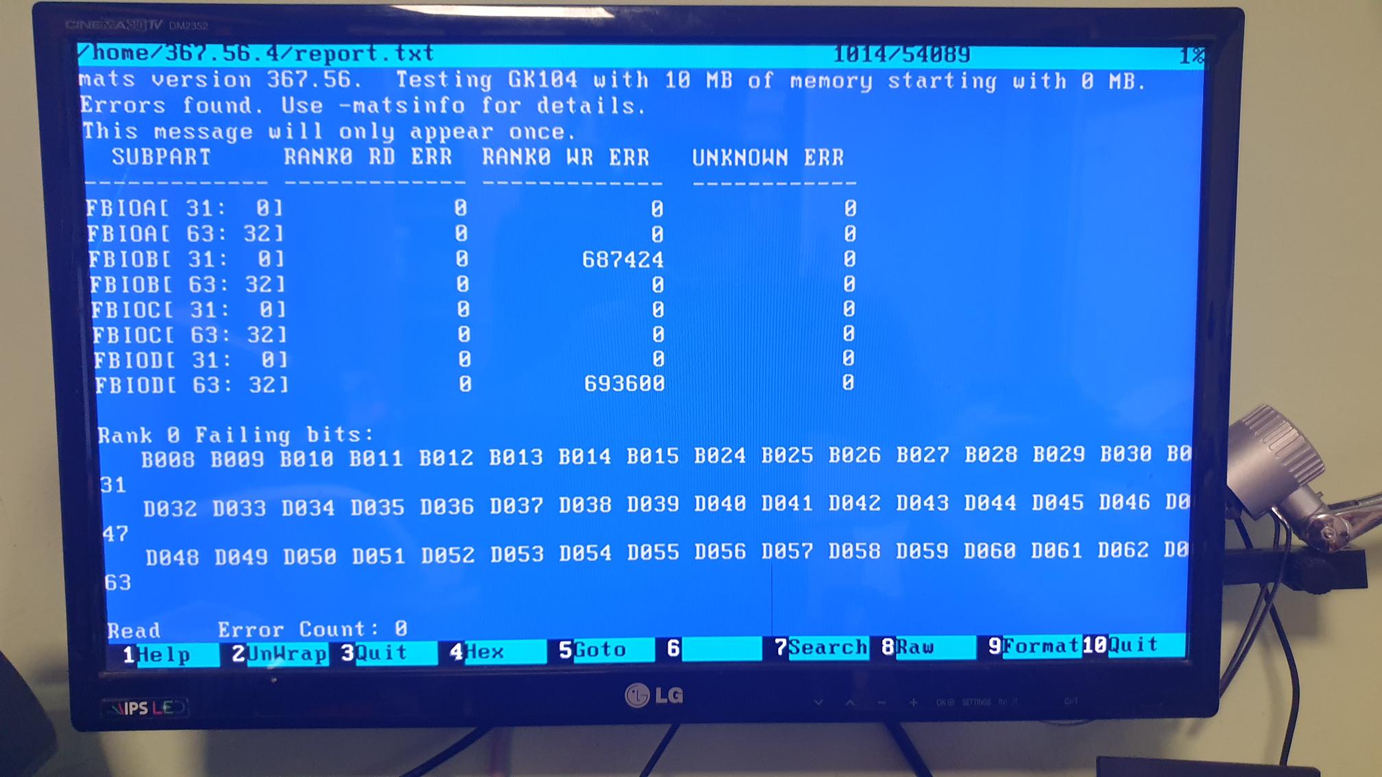

    I have a Gigabyte GTX 670 2GB gpu with memory problem.
    (gv-n670wf2-2gd)
    I ran MATS and I got result as you can see on the attached picture.
    Anybody can help me to identifying what are the wrong chips on the PCB?
    I does not have boardview or schematics for this card.
    Thanks in advance.
