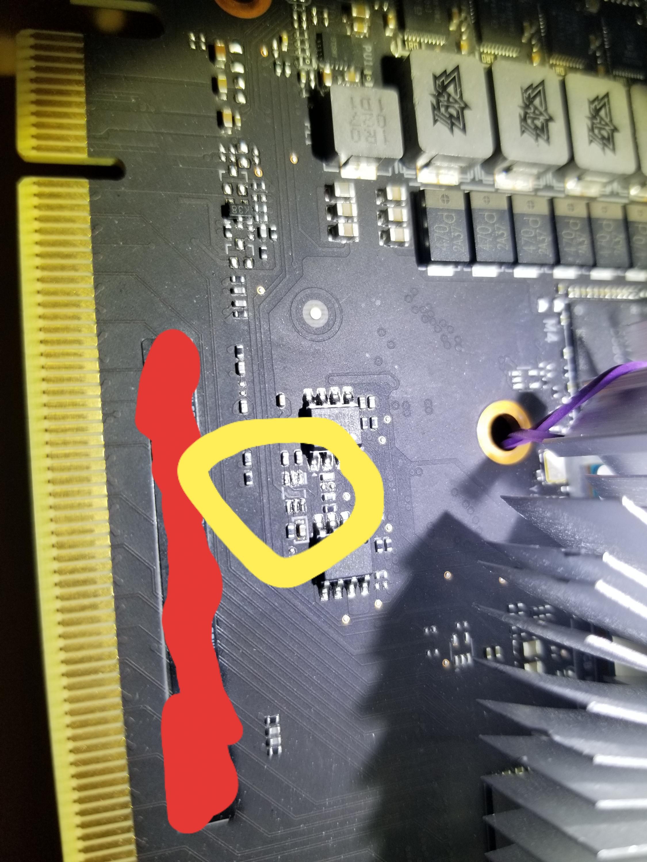

    Hi guys as the title says can anyone help me identify this missing chip (yellow circle) ?
    As comparison here is photo from techpowerup
    https://www.techpowerup.com/review/a...ages/front.jpg
    Thanks in advance

    Re: Asus ROG Strix rtx 3090 missing component near bios chip
    Could be a mux such as NC7SB3157 to switch bios chips?
    • ss45
      • Jun 2019
      • 119
      • Brazil
      Benwaterson
      Oh thank you that fixed it !!!!!
      Success !!!!
      Thank you very much !!!!
