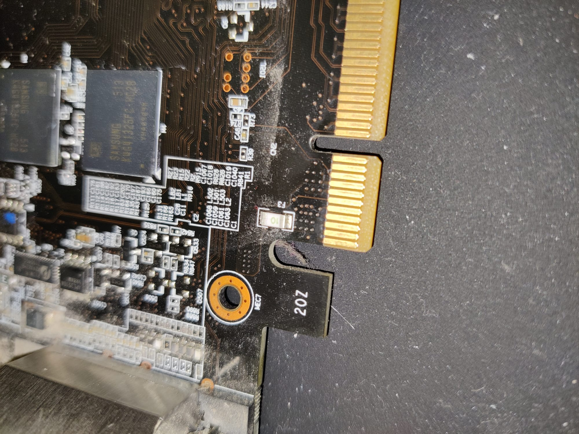

I have a GIGABYTE Windforce 980TI with a blown fuse. I have already found the root cause for the fuse blowing.
I need help getting a replacement fuse - I'm fine with waiting some time for some cheap ones from China.
The fuse says 10A on it. And I'm not sure what package size it is exactly. Also, how do I know if it is a fast or slow fuse?
I have a GIGABYTE Windforce 980TI with a blown fuse. I have already found the root cause for the fuse blowing.
I need help getting a replacement fuse - I'm fine with waiting some time for some cheap ones from China.
The fuse says 10A on it. And I'm not sure what package size it is exactly. Also, how do I know if it is a fast or slow fuse?
