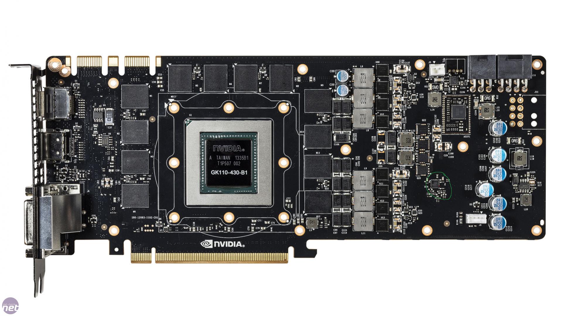

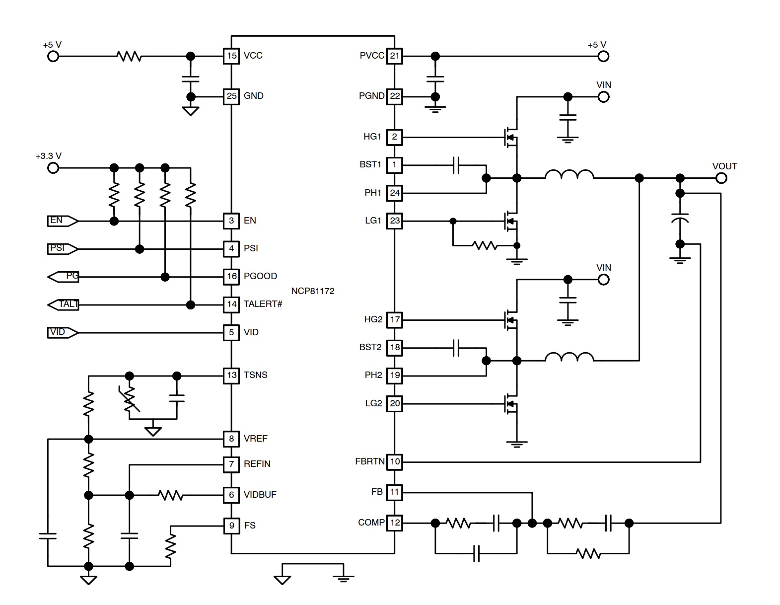

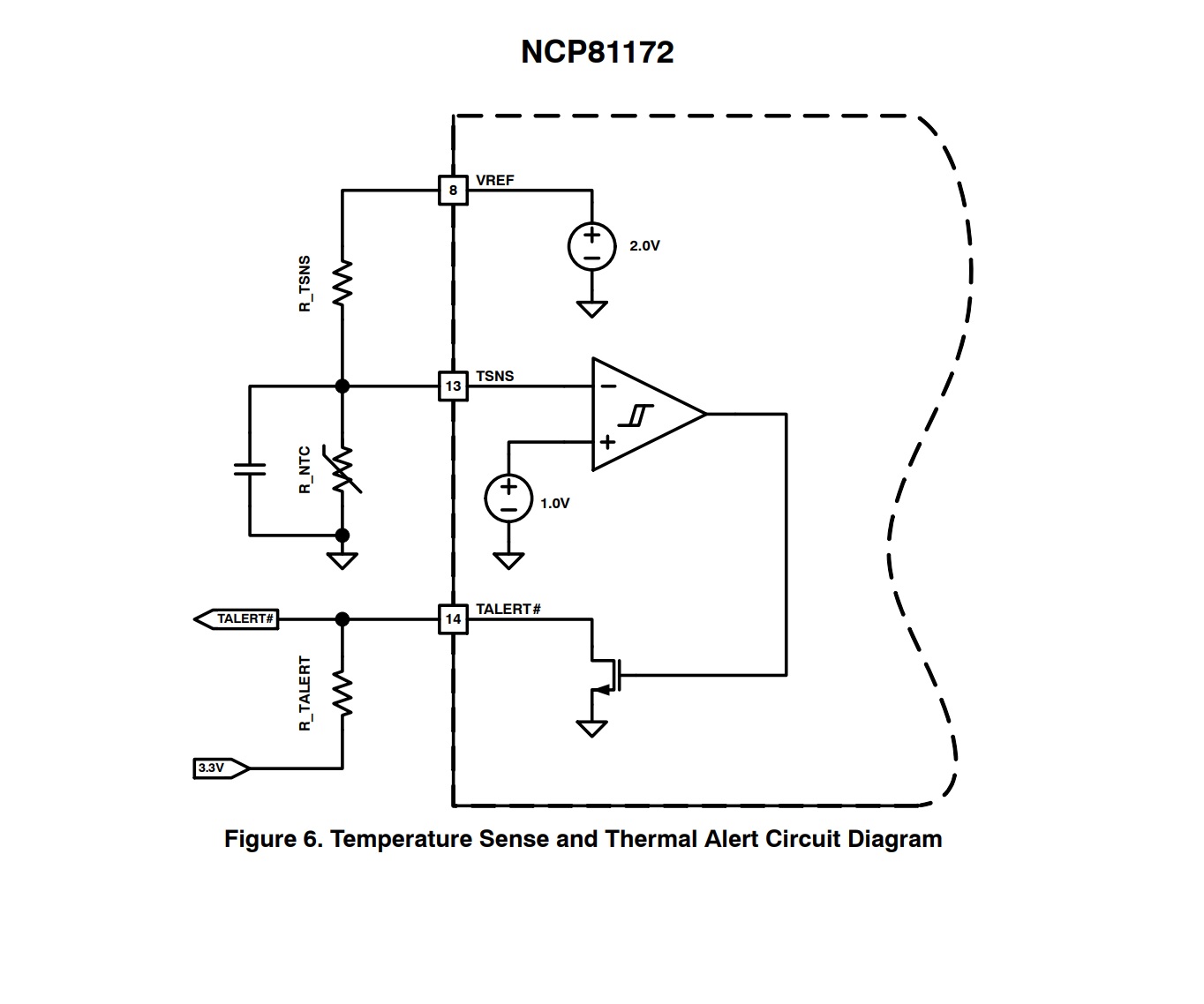

    I need help finding the NTC thermistor used by NCP81172 on the Titan Black. Pin 13, Which is TSNS, temperature sensing, is shorted to ground. The only thing connected to this pin is a cap and thermistor. I don't have another card to test if it's supposed to be shorted. I've probed the entire card and no luck finding it.
    NCP81172 is the synchronous dual phase buck converter for the memory.
    I've circled the chip with green and colored pin 13 in red.
    If anyone has a boardview or schematic this would help me greatly.
