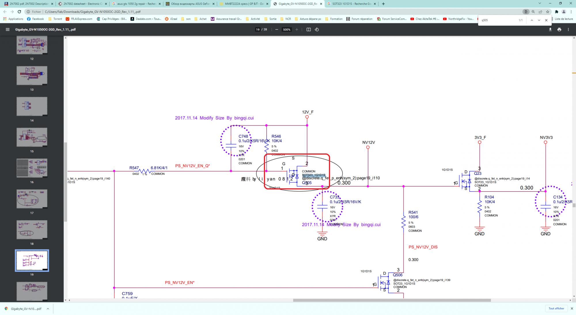

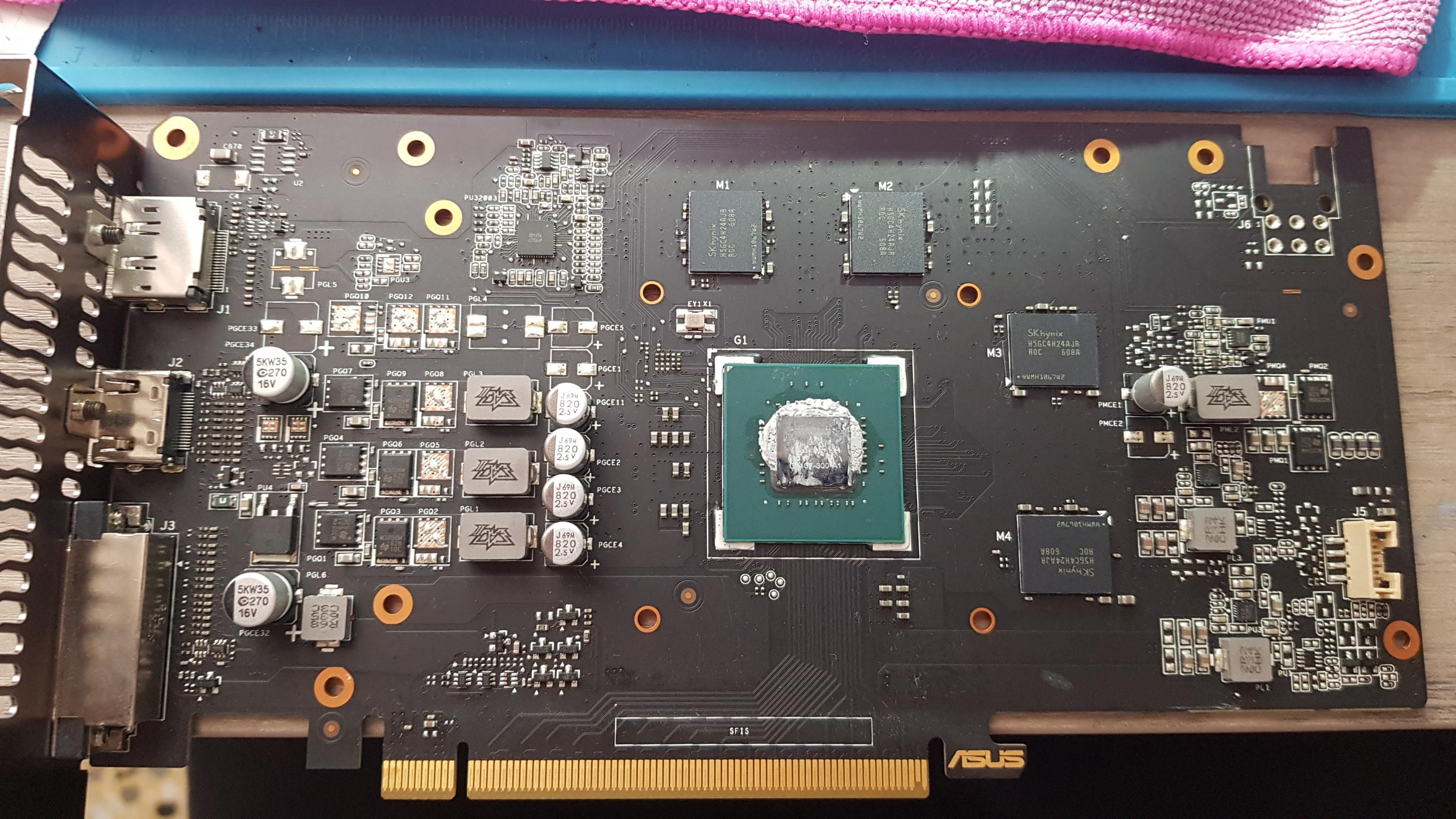

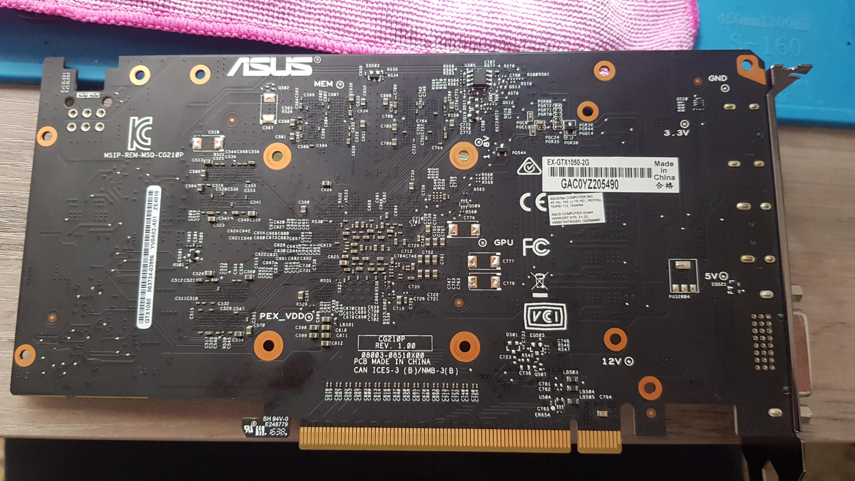

    Hello to all =D

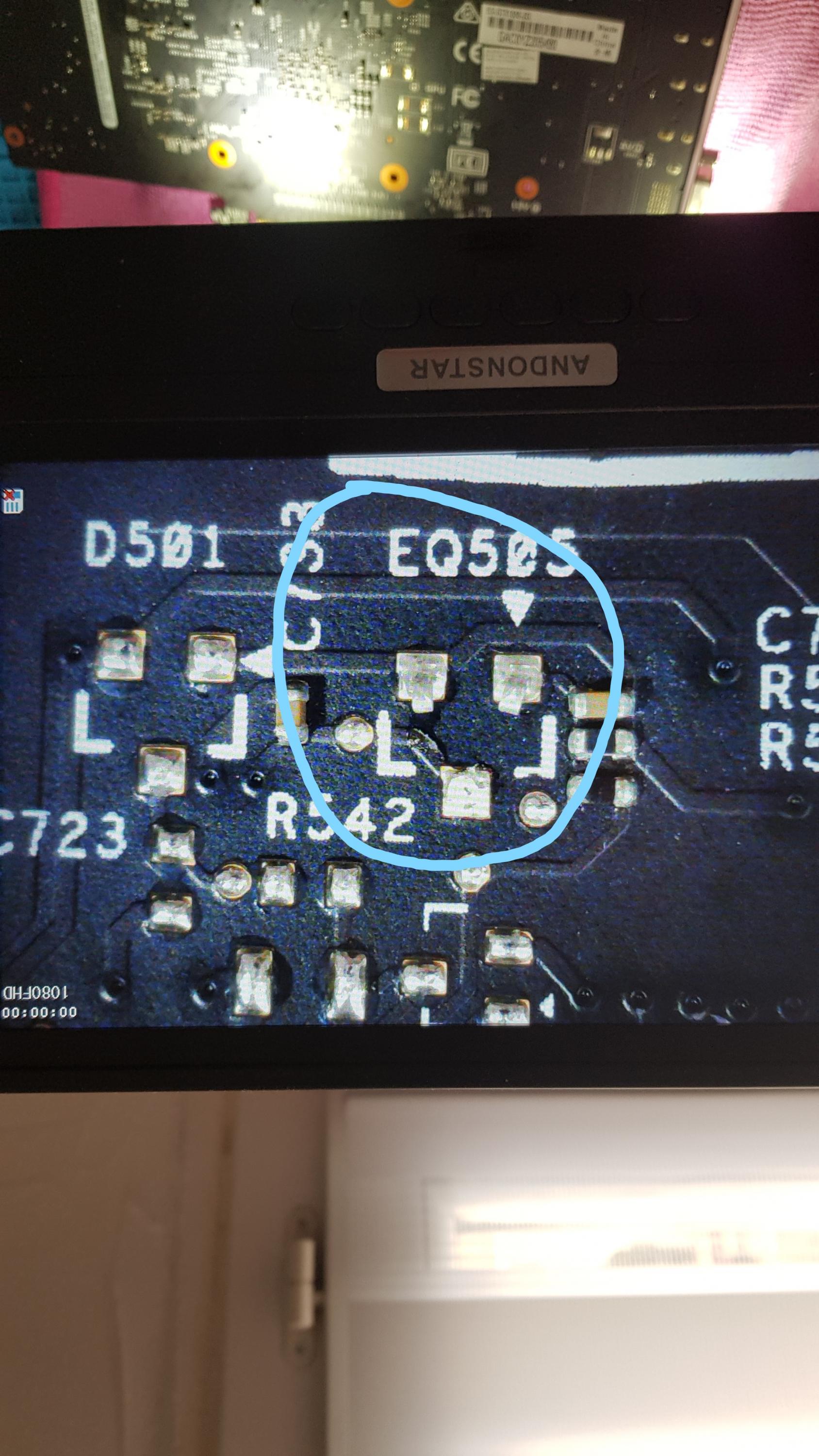

    After inspection as you can see this component is missing the only concern is that there are different on the card.
    For example for the 3V there is the transistor with reference s72H7 .
    Which transistor do you recommend?
    There is 0 short circuit nor other missing components.
    Only this one to restart the card =D
    Thanks a lot

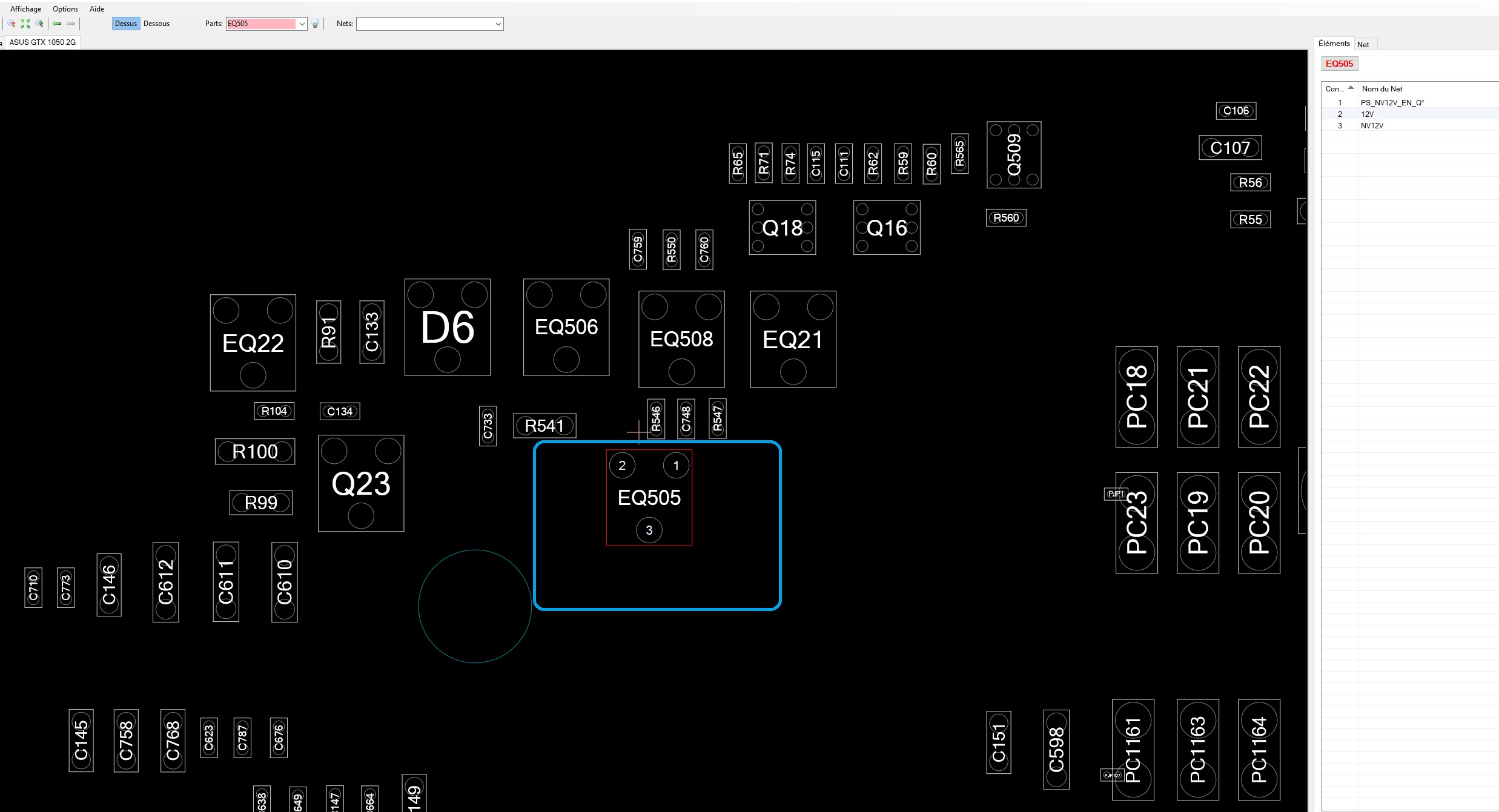

    I just found the schematic for a gigabyte GTX 1050 2GB and it seems to be approximate.
    Here is the component in question possibly missing
