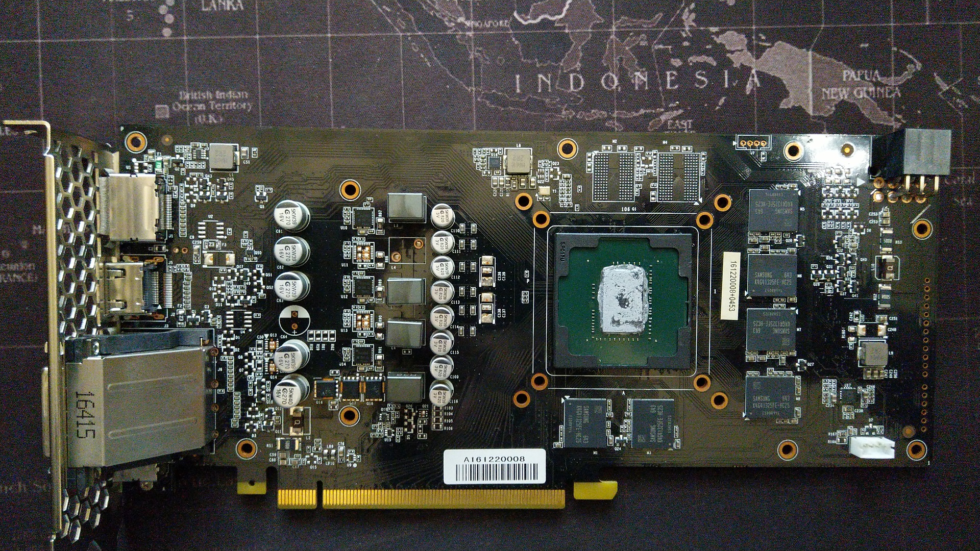

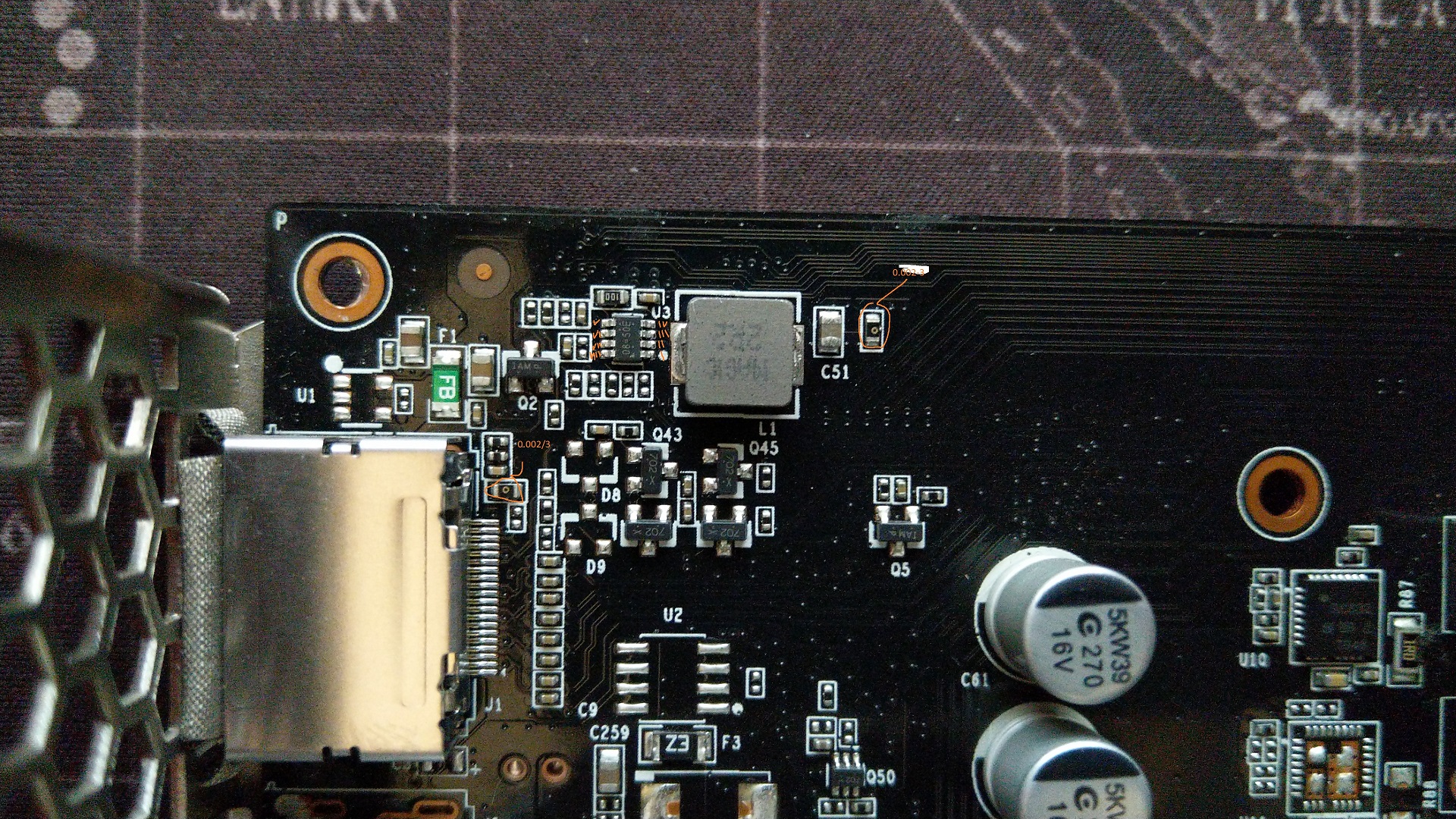

    Hello, I have faulty 1060. I'm missing 5 and 1.8 v. 12 and 3.3 seem fine. I need schematics or board of of this card or of a similar one so I can trace the 12 v rail to the 5v buck converter.
    Also If someone had dealings with such a card, I will appreciate the assistance.
    Thanks in advance!

    Re: Need schematics/boardview of Palit GTX 1060 3gb
    Hi, 1060 has the same boardview and schematics as the 1080, look for it and if not found i can upload later.
    12 and 3.3V are external power, 5V is generated form 12V in the card, 1,8 and PEX comes when 5V is generated.

      Yes, I know that about the voltages. But I have 0 v. to the buck convertor that should start the 5 v rail. I have 0 v. on all 8 legs, which should means that nor the 3.3, nor the 12 v (VIN), are getting there. I'd like to know why is that. I need to find the 3.3 way to the convertor and the 12 v to the VIN pin, right?
      I have few boardviews from 1070, but if you have something closer to mine, I will very appreciate if you share it with me.
      Also any advice on what should my steps be in diagnosing the whole problem are welcomed.

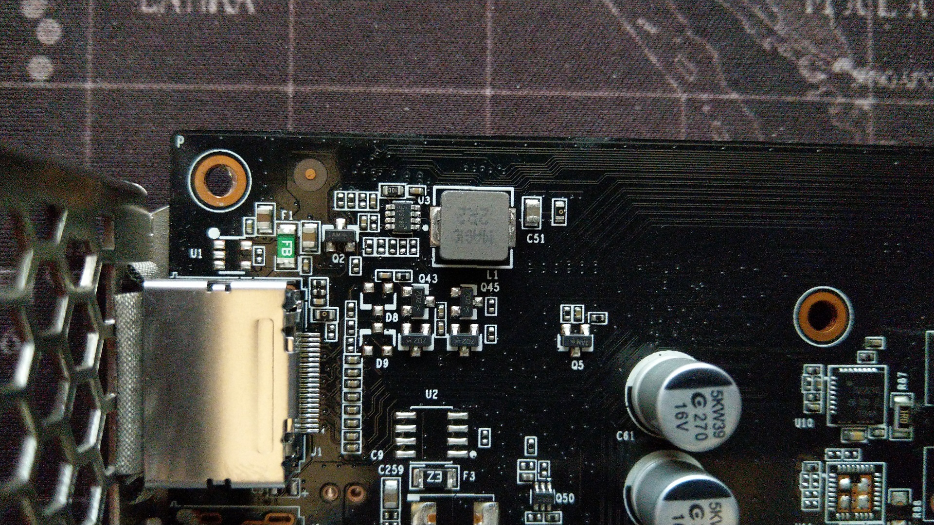

          So, my units 1 and 3 are empty. The buck convertor in question (the one I think does the 5 v) is U3.
          The BC itself is 08-50E and I was unable to identify it more specifically.
          I tested 2 of the 0 Ohms resistors near (marked on one of the pics) - they both shows values between 0.002-3. On the other hand, some times they read O.L. I read a little bit and even on 0 ohms resistors 0 or 0.001 is different from O.L. Not sure if my multimeter (Mestek DM90A) has some problems though.
          On the buck converter (the numbers on the legs I gave is random, because I\m not sure 1). When I use the beep mode, I get beeps only on the right side - 1, 3 and 4. When I measure resistance to GND I got: 1 - 19 Ohms; 2 - around 80kOhms; 3 and 4 - 0.002 Ohms; 5 - 6 mOhms; 6 - 13.5 kOhms; 7 - 200 kOhms; 8 - 22.8 kOhms.
          Thanks!

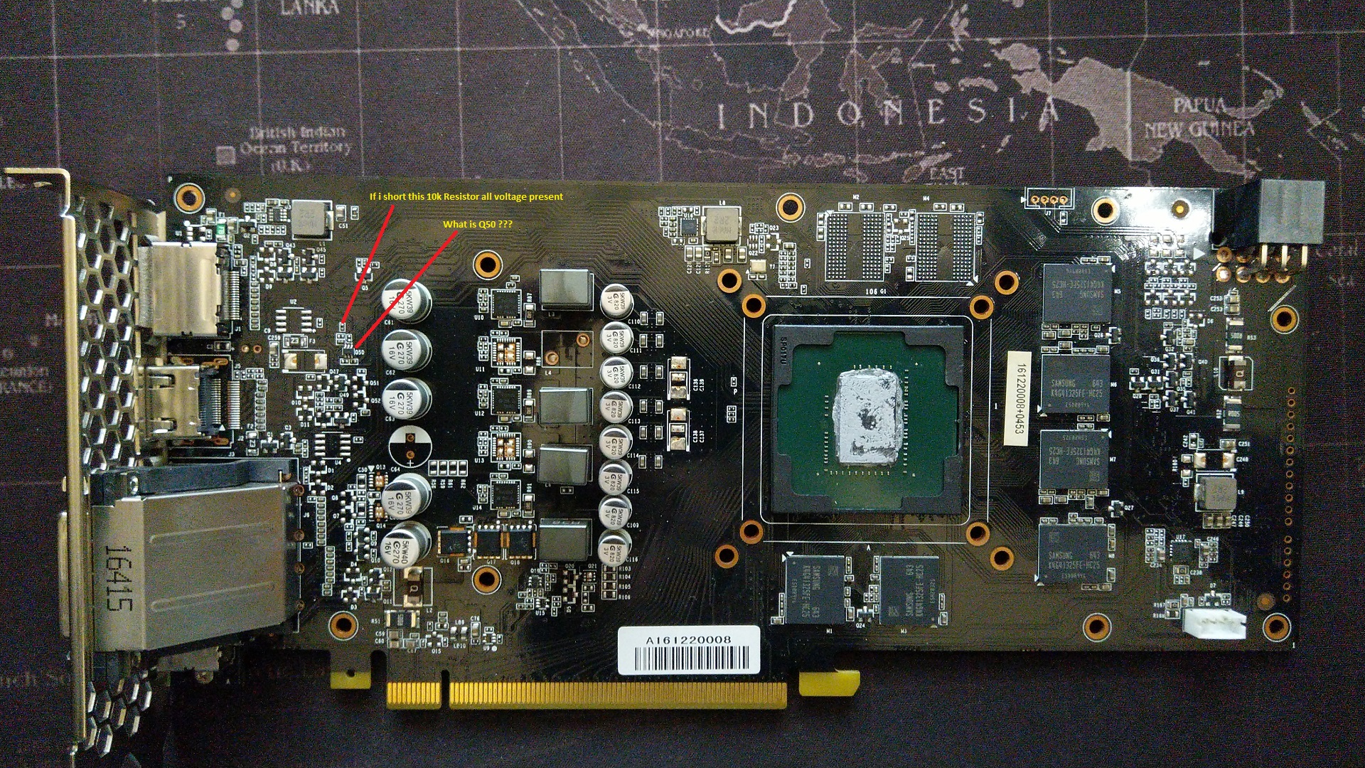

            Hello, I the same faulty palit 1060.
            I'm missing 1,8V.
            I found out if i short the 10k Resistor near Q50 all Voltage are ok then, but the card do not start.
            I would like to know what is this Q50?

              Boardview or scematics of the card would help a lot.

                I think the coil L1 is the 1.8v line because of the 10th generation model. The u10 fet is a 1.5v vram line. The u12 fet is a 0.9 Gpu line. IC u17 is the 1.1v vBoot line
