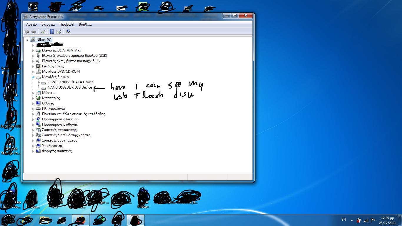

    Hello
    I used an external drive with usb and I had to do a repair recommended by windows and I stopped it abruptly
    After that this disk does not appear in my computer window
    I see it as a usb disk but as 0 gbyte capacity of 1.9 tbyte which is real
    Is there a case to fix it again and make it work? I went
    cmd open like administrator i used command chkdsk e: / f
    and tell me message cannot open volume for direct access

      I had downloaded this program too
      the problem is that we see usb flash normally in disk management but with a capacity of 0 mbyte instead of 1.9 tbyte that it normally has
      but in the window my computer does not see it nor the program you gave me does not even detect it as a disk
      has it been completely destroyed?
      can I recover it somehow?

        Is it a flash drive,if so its likely to have fake capacity.What make and model is it,are there any part numbers on the casing, where did you buy it

            Re: problem with external usb disk
            Understood
            Just at the beginning when I got it it normally showed me 1.9 tbyte capacity
            just the problem I was having was when I was copying 140 gbyte from a disk it stopped after 60 gbyte and I got an error 0x80070570 then putting it in and taking it out of the usb port they asked me to have windows scan and repair and because it was late I took it out the usb port and now it is 0 mbyte and my computer does not appear in the folder at all
            i can see it only in diskpart in dos but in situation no media o mbyte
            what do you think can i repair this disk ?

                    Im sorry to say that for 22€ you can not expect 2TB, so I think its a fake USB flashdrive for sure. Post some photo, and make and model of the drive
