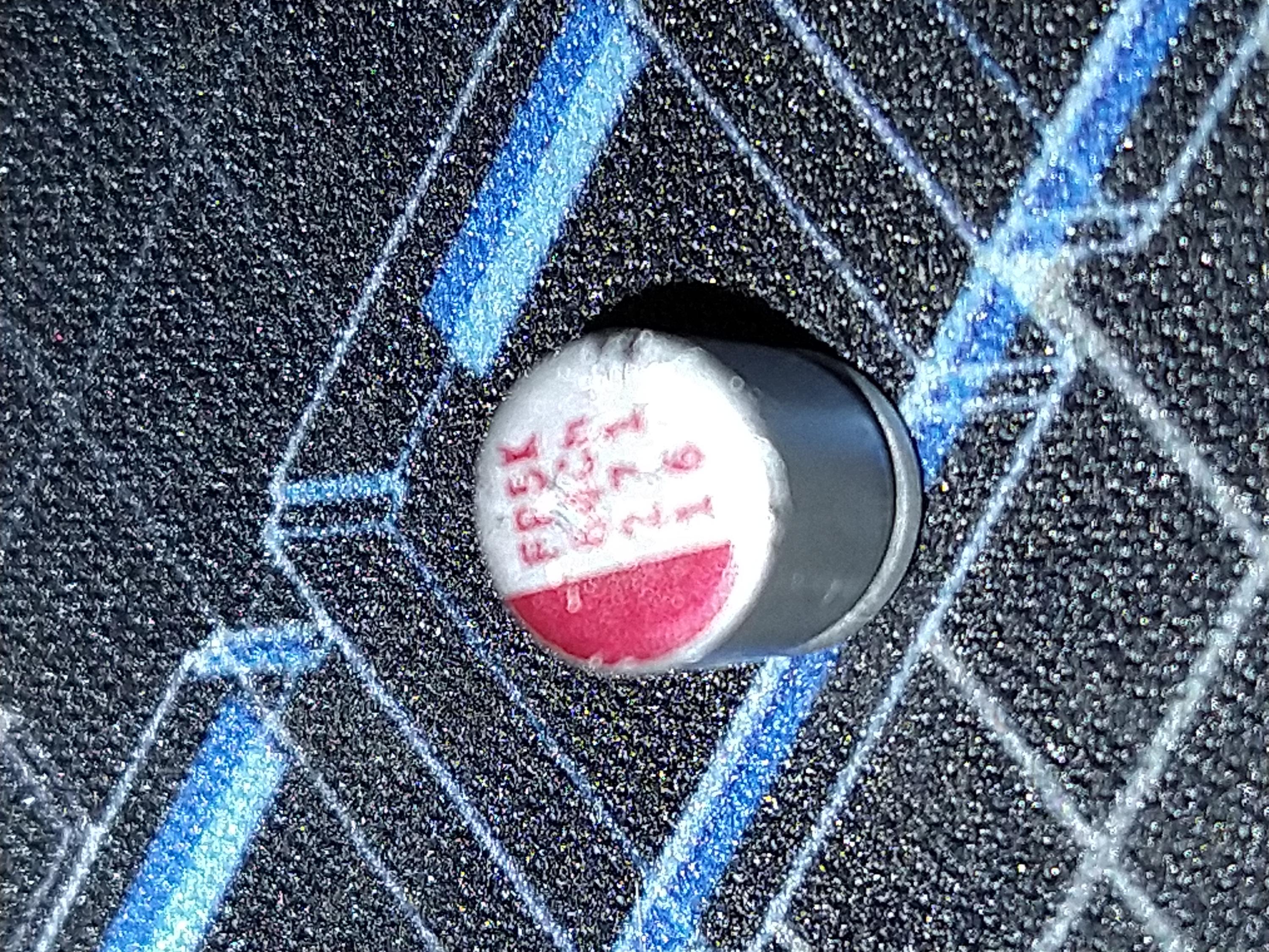

    Hello fellow electronics techs.
    This little guy broke off one of my junker cards that I normally do protein folding. Leads stuck to the card and yanked out of the cap.
    I can probably solder a new one without much trouble if I can decipher what these markings are. I'm guessing 16V 271 uF but really I have no idea. It doesn't have to be an expensive cap, just one that will do the job on an open test bench with plenty of air flow. I believe it was a filter cap for one of the VRAM ICs.
    It reads
    FP5K
    64Ch
    271
    16
    Thanks for looking.
    - Luke

    Re: Need help ID graphics card cap
    It is a Nichicon FPCAP rated at 270uF and 16v
      https://eu.mouser.com/new/nichicon/nichiconfpcap/
      Thank you Per!
      I ordered a few from Digi-Key since Mouser wanted to charge like $20 to ship.
      I'll post a picture of finished project.
