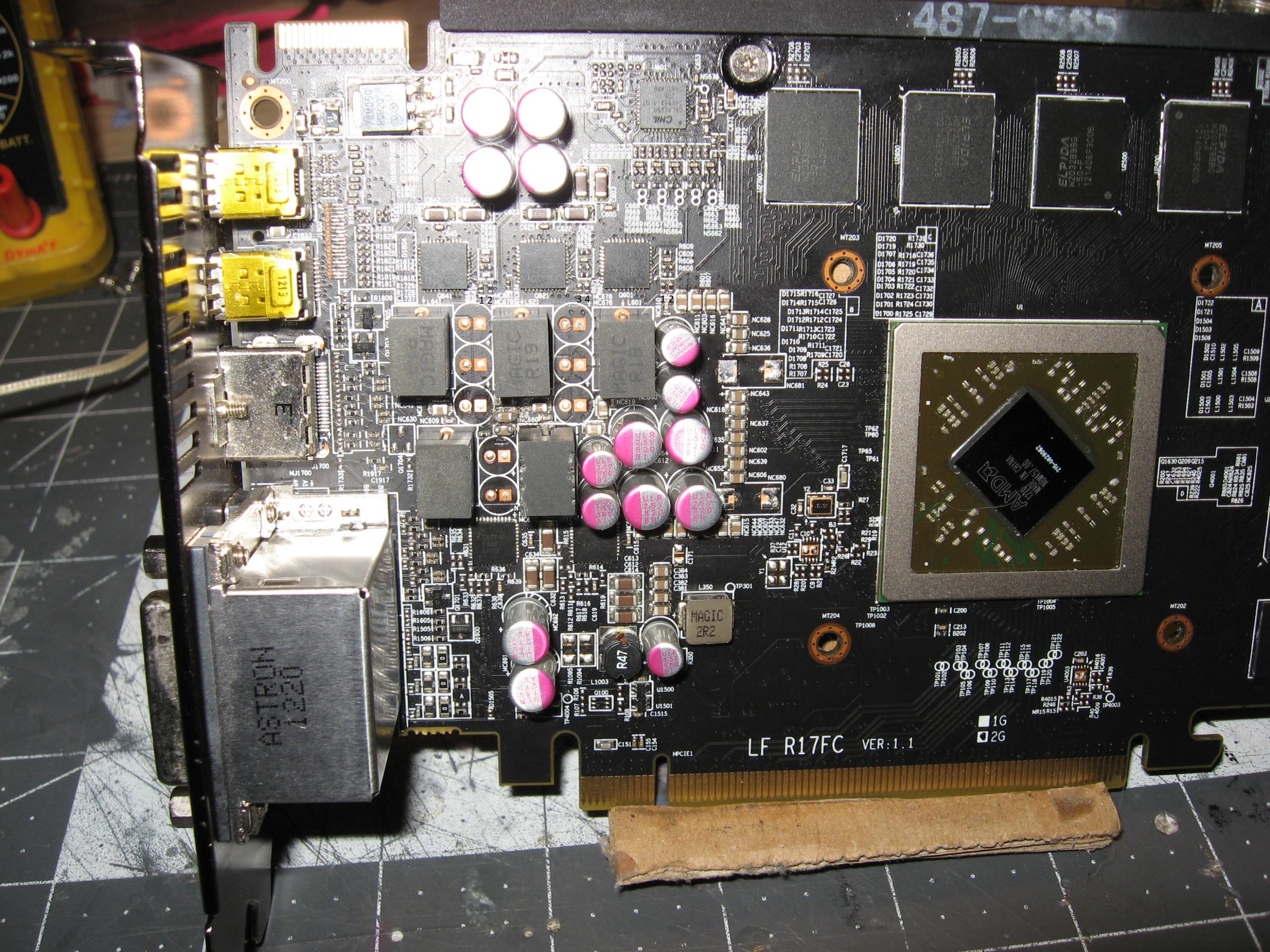

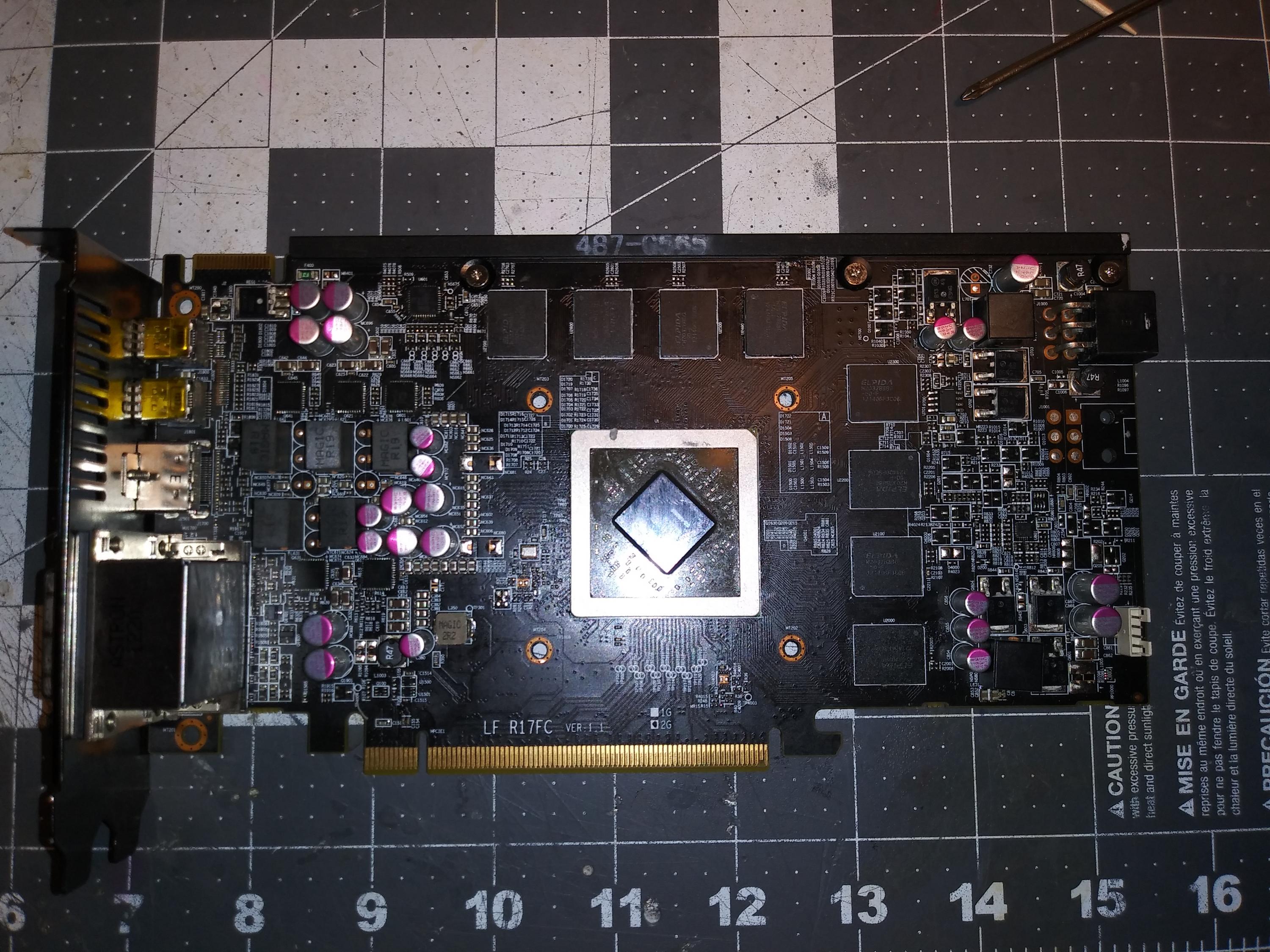

    HD 7850 - Powers on, fan spins, no video....
    Bios reads fine with programmer (ch341a).
    Found an area of caps showing short-circuit 4.6ohm. Normal?
    Here are some pics:
    Refernce: https://www.badcaps.net/forum/showth...t=35004&page=2

      Re: HD 7850 - Powers on, fan spins, no video....
      That 4.6 Ohm resistance does look normal, as it appears to be your GPU V_core (which can sometimes be as low as 1.x Ohm on some really big GPUs.)
      Check the RAM Vdd rail for short circuit too - that should be either generated by the buck circuit near the PCI-E connector (where the square inductor is) or near the fan connector on the bottom-right (again, where a square inductor is.)
      If none of these are shorted (and they likely aren't if your card can still turn on without shutting down the PC), then I suspect you just have a dead GPU chip, given that the BIOS is OK too... which shouldn't be surprising. The HD7k and R9 2xx series aren't known to be very reliable - in fact, they are notoriously unreliable, based on what I've seen on the used market (mostly following them on eBay.) The number of dead/defective cards I see from the HD7k and R9 2xx series relative to how many working ones there are offered is quite high. Even the GTX 4x0 and 5x0 series don't seem to be that bad, and they were quite far from reliable too, given how hot they ran (especially the GTX 470/570 and 480/580.)
      You can try giving the GPU chip a reflow or two to see if it will come back... and if it does, it most likely will be a temporary fix. However, you *may* be able to extend that a little if you make sure to keep the GPU core temperature under 53-55C at all times under load (preferable to keep it under 52C, even, if that's possible.) I use MSI Afterburner and set my own fan profiles on my cards so that GPU fan = max when card is at 57-60C... which makes the card really loud when stressed hard. So to avoid that too, I also frame-limit games to make sure the GPU isn't under 100% load, which helps lower the heat and noise. Do that to any GPU and it should last much longer. The downside is, you may not get the best game performance. But that's how these things go. Modern GPUs simply aren't built well enough to whithstand 24/7 on max load... which is why mining usually kills GPUs so quickly. The ones that do still work after being used in a mining farm were probably just the "better-made" silicon wafers. As with any manufacturing, there are always tolerances to how things are made, and some of these GPU chips just barely make it out of the factory working 100% normal, and some make it with flying colors... hence why sometimes GPUs last, and sometimes they don't. Of course, keeping a GPU cool and under a lower workload will no doubt extend its useful life.

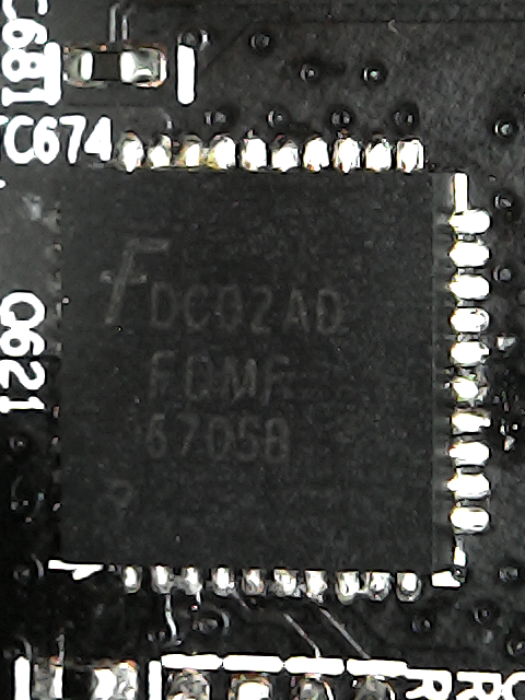

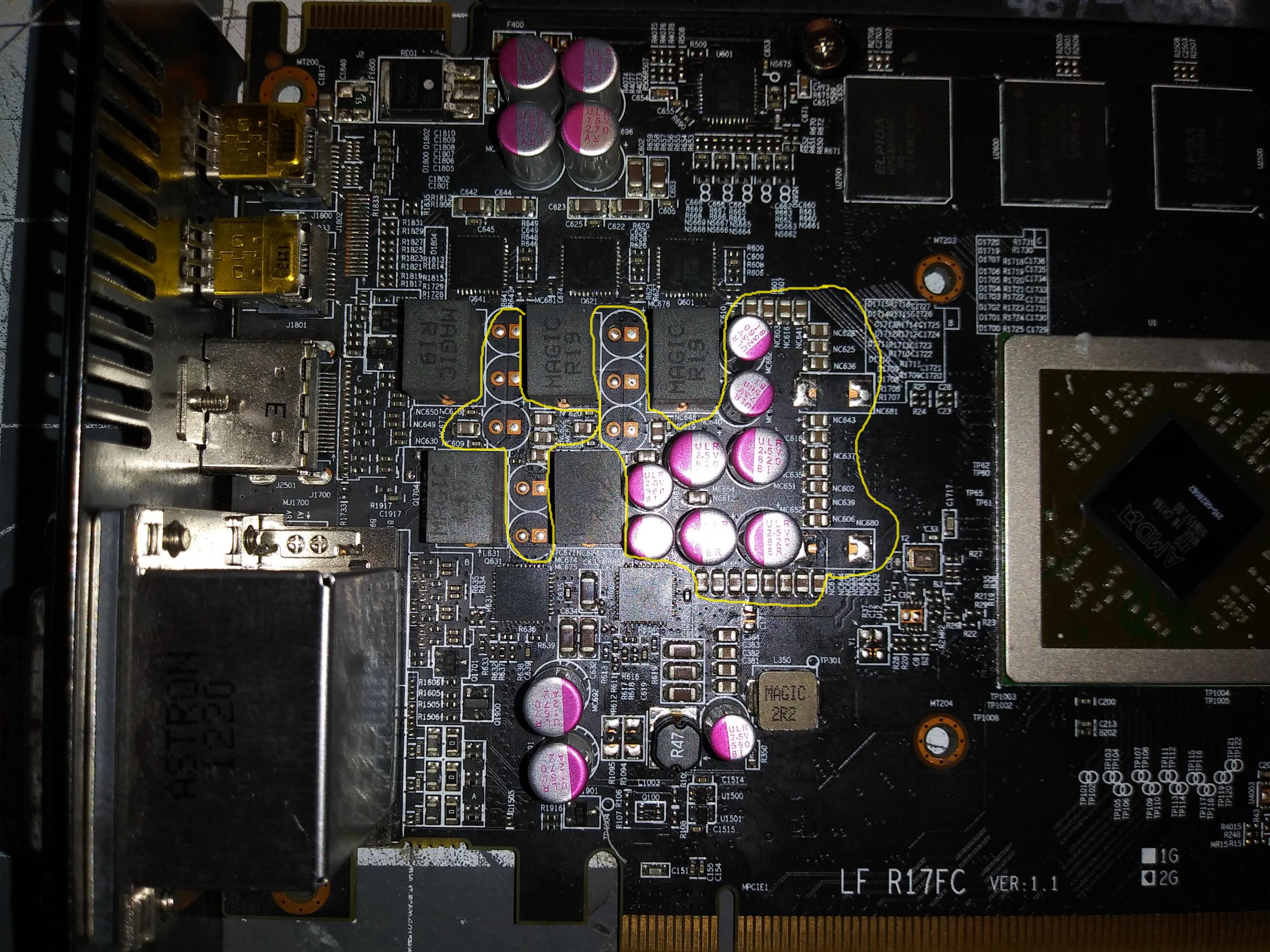

        Thanks for the response. I probed around in the regions mentioned and didn't find a short.
        I did find pin 3 of Q621 (FDMF 6705B) is 1ohm. In this image I have marked the 2 adjacent fets laterally; Q641 bad Q601 which are both are 211ohm to pin 3. SMDs marked 1&2 are 10k and 2 ohm respectively. Those marked 3&4 corresponding to the suspect fet (Q621) read 272ohm & 209ohm respectively.
        C649, C629 and c609 all 100nF.
        Pulled R626 and short to ground for Q621 VDRV (pin 3) gone.
        Pin 3 is VDRV-power for gate driver.
        Q621 shorted maybe? VDRV is shorted to ground. FET itself or accompanying ICs?
        Marked: F DC02AD FDMF 6705B.
          Based on the block diagram I do not see that VCIN and CGND should be .9ohm (out-of-curcuit) for these DMF6705Bs. Can anyone confirm/reassure me on this? The other FDMF6705Bs are open pin 2 to 37 in-circuit.
          Pulled Q621- Short from pin 2 to ground is gone on PCB. Pin 2 to CGND is .9 ohm on Q621 (FDMF6705B) out-of-circuit.
