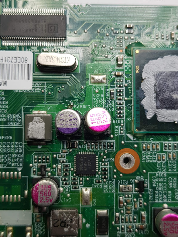

    Hi There got a shuttle in for repair with no display checked all voltages an there is no voltage for CPU so I checked the MOSFETs q19 q15 q16 and there is no voltage on the gates the controller ic for these is u15 I have taken voltages but not sure what is supposed to be there I will put them on here and hopefully someone can point me in the right direction
    u15
    pin 1 ovp =0/99v
    pin 2 test =0.98v
    pin 3 vin = 17.42v
    pin 4 dslp - 0.00v
    pin 5 vod0 = 0.00v
    pin 6 vid1 = 1.04v
    pin 7 vid2 = 0.00v
    pin 8 vid3 = 3.33v
    pin 9 vid4 =0.00v
    pin10 vid5 =3.33v
    pin11 vid6 = 0.00v
    pin12 vr_on =3.33v
    pin13 vddp = 5v
    pin 14 ldr =5v
    pin 15 gndp = 0v
    pin 16 bst = 5v
    pin 17 hdr =0v
    pin 18 lx = 0v
    pin 19 pgd =0v
    pin 20 comp =1.48v
    pin 21 slew =0v
    pin 22 csp =0v
    pin 23 csn =0v
    pin 24 rsp =0v
    pin 25 rspll =0v
    pin 26 rsn = 0v
    pin 27 imon =0v
    pin 28 vdda =0v
    pin 29 vr_ttb =5v
    pin 30 clk_enb= 3.33v
    pin 31 vref = 3.33v
    pin 32 vbt =1.48v
    pin s1 agnd =1.18v
    If anyone can explain what they mean as I couldn't get a pinout which tells me which voltages should be there I Have attached a schematic of the board

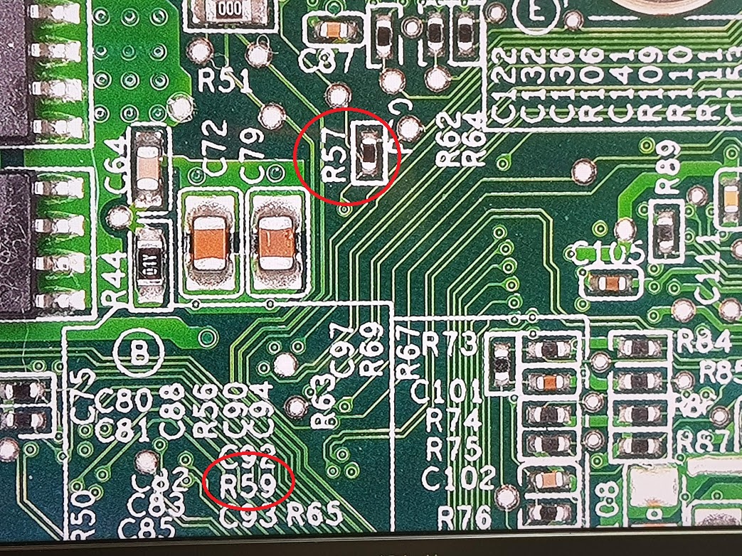

    Pin 28 VDDA should be 5V, probably an issue with R58.
      Re: shuttle xs35v2
      Cheers anyone got a board view I can't find resister R58 anywhere found 57 and 59
