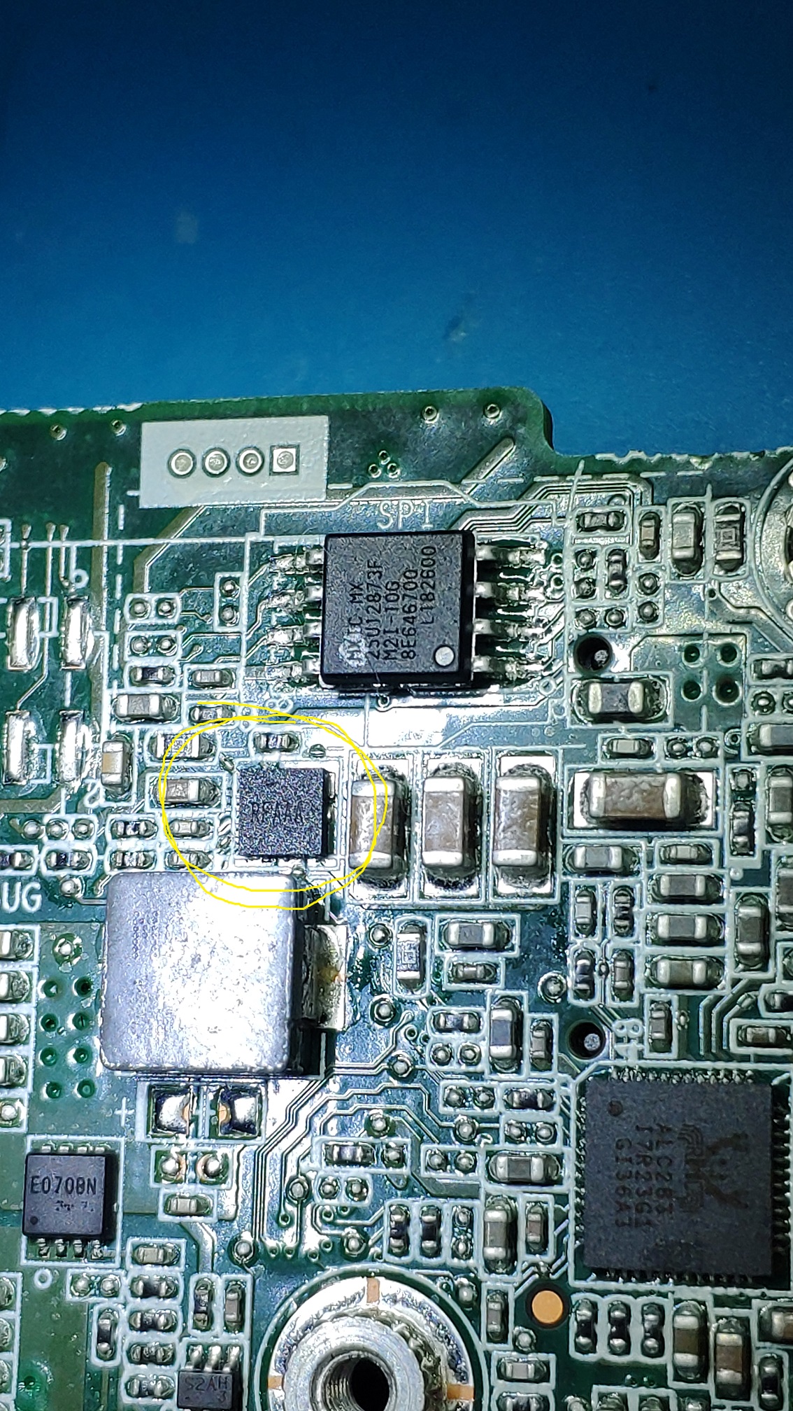

    Hi All,
    Could somebody help me to identify attached compoment ? On it says RFAAA. I think it is some kind voltage regulator. Google or aliexpress did not find it
    Thanks all.

    Re: intel nuc mini pc nuc6cays - identify component
    https://www.badcaps.net/forum/showthread.php?t=90619
    Originally posted by SMDFlea
    RF*** SYX198BQNC - No Datasheet,Use NM-A561 Schematic
      I love you. Solved and can be closed.
