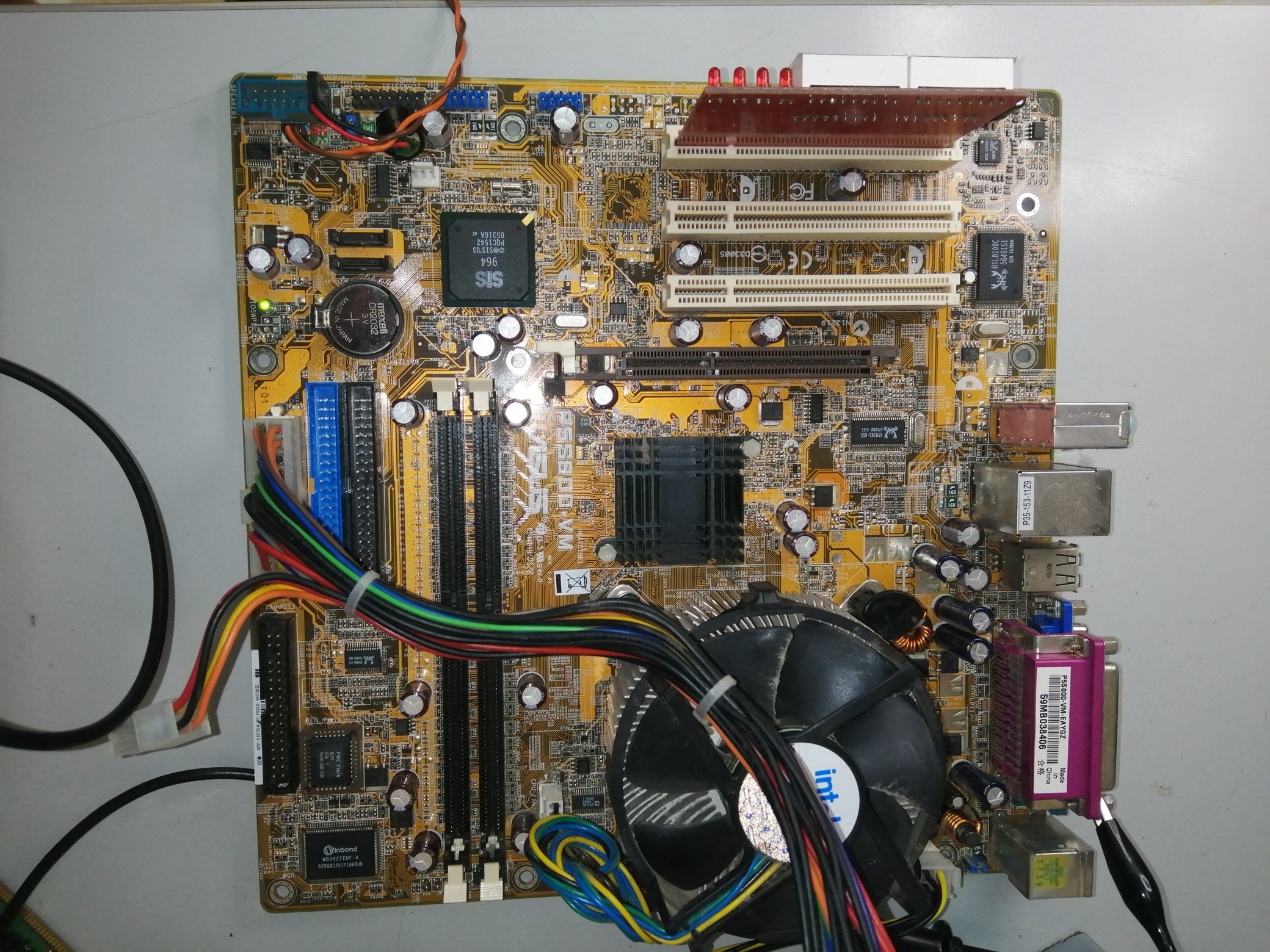

    Hi guys, here is the latest motherboard I'm trying to fix just for the hell of it
    ASUS P5S800-VM
    It turns on/off with the ATX power switch, but it doesn't boot (POST 00 on my diagnostic card)
    I tried another P4 CPU, no difference
    I tried with or without DDR. No difference
    I have Vcore 1.4V, Vram 2.6V, 3.3V to the BOIS, 5V, 12V etc. I'm using a known good PSU
    I reflashed the BIOS - no difference

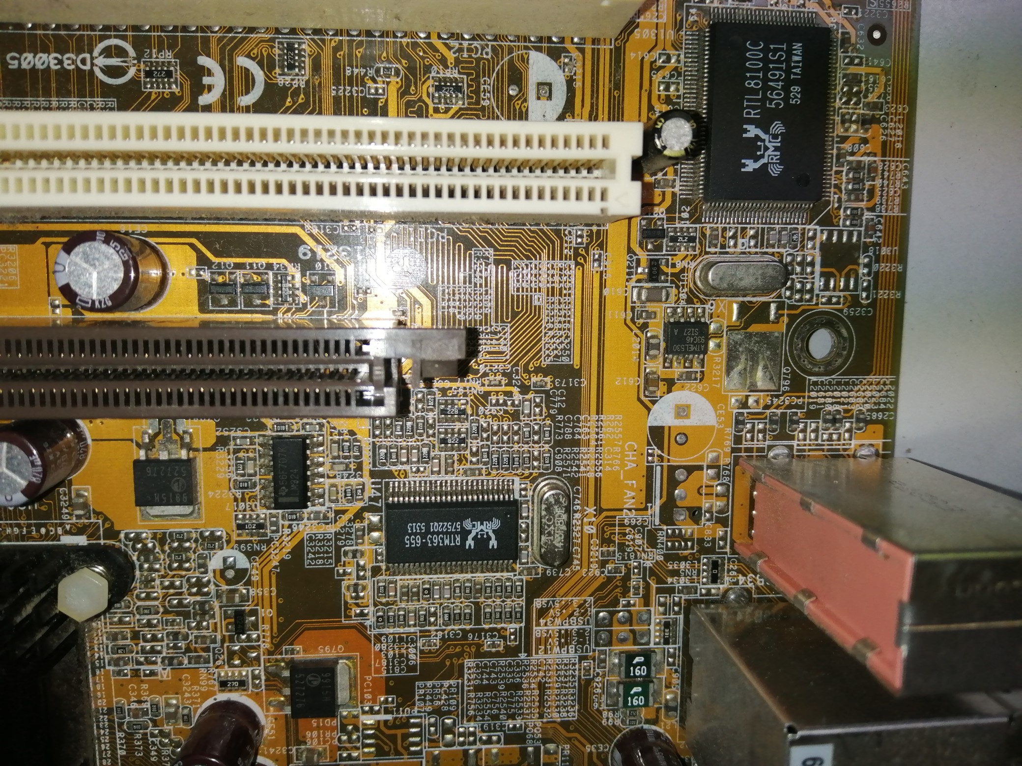

    From looking around with my scope I think i have no system clock. I'm looking at the RTM363-655 which I am sure is the clock generator. The crystal doesn't seem to be oscillating (just some high frequency noise on one pin probably from the PSU). I have 3.3V supply to this chip. Nothing seems to be happening on the outputs.
    I couldn't find the exact datasheet. I found this one https://datasheetspdf.com/pdf-file/7...K/RTM363-210/1 for the RTM363-210
    Does anyone know if the -210 and -655 version of RTM63 have the same pin out & functions?
    Are these clock generator ICs known to fail?

        I had a look at the RTM363-210 datasheet again - link in post #1
        Assuming that is basically the same as the RTM363-533 then i have #PD is high 3.3V so according to the datasheet the IC should be active.
        #RESET is low but the datasheet says that is an open collector output
        According to the datasheet Block Diagram 4, there should be control inputs for #PCI STOP and #CPU STOP but those don't appear to relate to any pins on the IC.
        On the Xtal I have 1V on one pin and 1.5V on the other pin but it isn't oscillating.
        Clock Outputs such as pin 21 and 22 are low. So it isn't working.
        Should I now order an Xtal and RTM363-533, or is there some other possibilities I am missing here?
        Also i notice there are some control registers and a serial interface to program the RTM363 output frequencies. But how does that happen unless there is a clock to drive the CPU in the first place, unless it is supposed to oscillate at some frequency like 100MHz by default at power on?

              I've come back to look at this again. Thanks for the board view files - I got them to open in Boardviewer and they helped me.
              As far as I can see there is no system clock, I've looked around the clock generator IC RTM363-655 using board view as a guide and it is enabled (reset is high) it has power on all the pins it should have according to board view, the crystal is oscillating, but nothing comes out of the IC. All the pins (other than xtal) are static either 0V or 3.3V
              Unfortunately I don't have a datasheet for RTM363-655. I do have datasheet for RTM363-210 but it is clearly not the same chip, even some voltage supply pins do not match the board view. Also I can't find a supplier for this 655 chip on aliexpress. I found one on alibaba who would sell me five at a reasonable price but the postage is killing the deal, and this repair is only for educational purposes.
              So I could possibly assume that chip is faulty. However I apparently have another problem. I've noticed that a power FET on the board gets quite hot and from board view it is clearly feeding VTT which I measured at approx 1.2V.

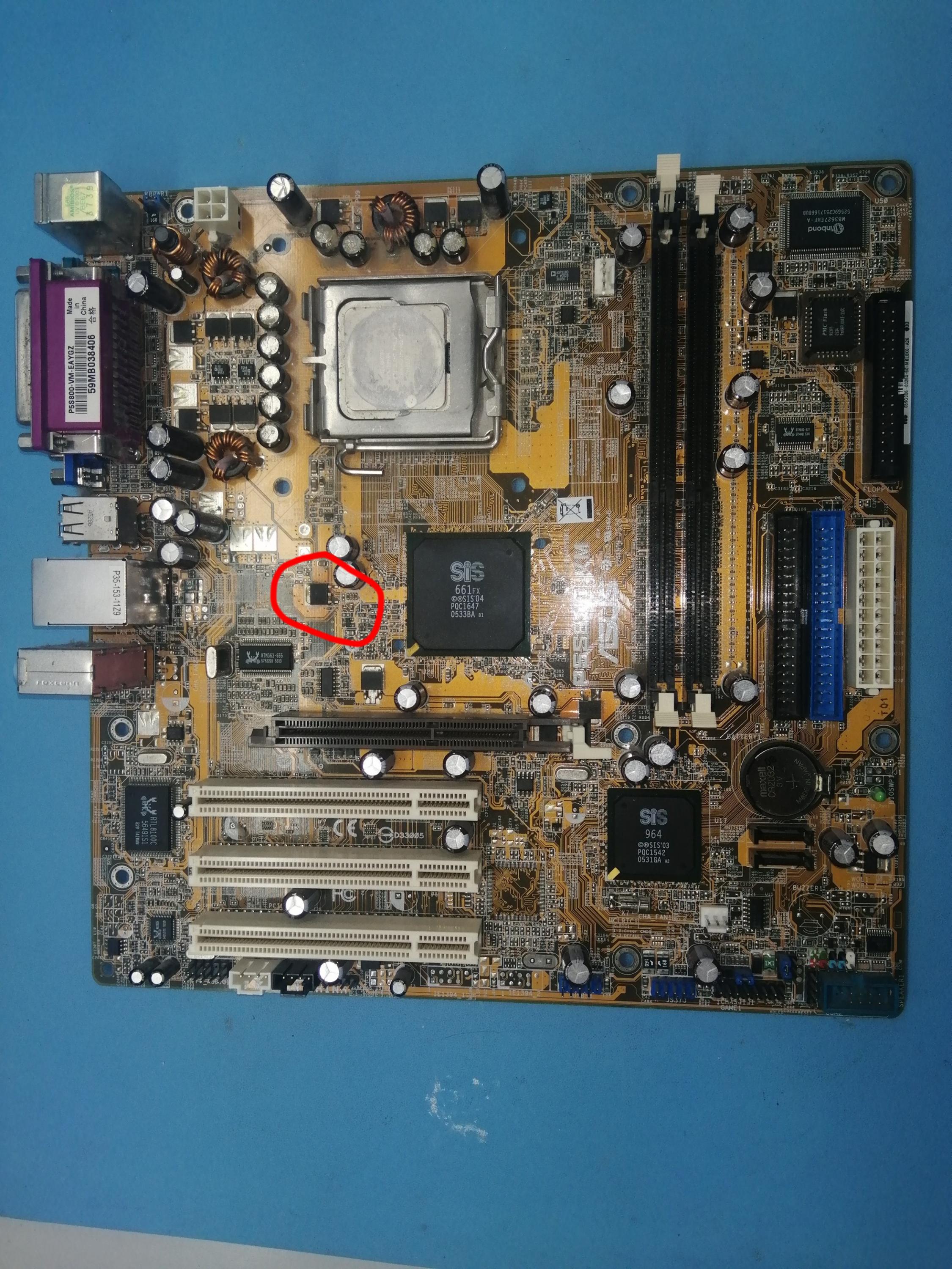

                You'd need a oscilloscope with a decently high bandwidth to be able to check those clock signals (they'll most likely be 24MHz, 33MHz, 48MHz, 66MHz, 200MHz and maybe others). Clock generator can fail as any component can fail, but not really the first thing I'd suspect.
                Can you post a picture of the board identifying the VTT MOSFET you're talking about?

                    Actually I was using my 20MHz LG scope but I will look again tomorrow with my 100MHz Tektronix scope.
                    Vcore and VRAM are OK. I will have a look to see where the CPU reset signal comes from. Probably the SIO?
                    I've added a pic as requested
                    I agree the hot MOSFET is likely outputting the correct voltage. a 2.7 ohm load would be about 500mA at 1.2V so it is not excessive - it just seems very low resistance compared to the LGA775 Intel chipsets I compared with
                    The FET doesn't get very hot but it's still 65C according to my temp probe and that is with the board doing nothing.

                        I tried running the board without the cpu heatsink. It isn't a problem as the CPU only goes up to 45C even after the board has been powered up for 20 mins
                        I tried pushing on the CPU when starting the board but it makes no difference
                        I noticed on my POST test card that the CLK LED lights extremely dimly
                        I don't have any clock, checked on my 100MHz scope. Using boardview to guide me I checked some clock signals. CPU Clock, SATA Clock, NBH Clock - all missing. The 14MHz crystal to the Clock Gen IC is running
                        I also checked some reset signals to the CPU (with CPU fitted)
                        CPURST# (LGA pin 532)
                        DBRESET# (pin 63)
                        HTRESET# (pin 154)
                        all low
                        I noticed that I can turn the ATX PSU on with the power on switch but can't turn it off again by holding the switch down.
                        Without the heat sink on the North bridge it gets quite warm 47C. The South bridge is cool.
                        And given the low 2.7R resistance to ground on VTT with no CPU fitted, the hot VTT MOSFET and what Piernov said about the CPU reset coming from the north bridge, and the fact you also found much higher resistance on VTT with similar SiS boards....
                        All this to me is pointing towards a faulty north bridge BGA. And maybe that is somehow also stopping the RTM363-655 clock gen from running (even though CLKRST# on pin 4 is high)? The lack of a datasheet for this IC is not helping me here :-(
