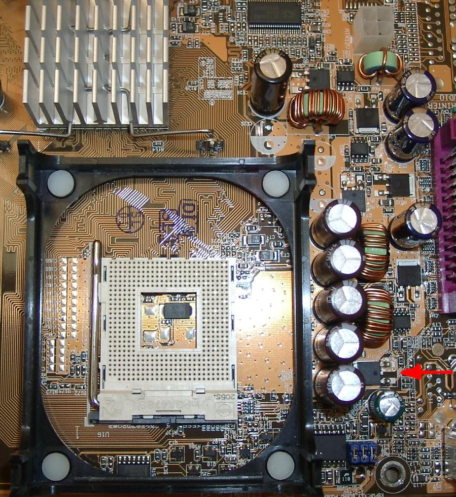

I am not having too much success lately with recaps....
This board won't POST.
Actually, when you press the power button, first the P/S (pretty sure where the noise was from), makes a few short ticking noise (like keyboard held down).
Then the single beep from the speaker but no video...and then the ticking noise continues. I even pulled out the keyboard and mouse but the noise continues.
I looked at the major caps and they are:
Taicon 1200uF/16V (3 pcs)
Taicon 3300uF/6.3V (6 pcs)
I checked this forum and see that I need to replace them.
So I replaced them with Rubycon MBZ 1500uF/16V and 3300uF/6.3V MBZ.
(Note: These Taicon caps were then brought to work using the ESR meter (analog type) and they are less than 0.1ohm (hard to tell, depends how hard I push the test probe on the cap legs). So I think the caps were not the problem.)
When I start up again, it took longer (maybe 2-4 sec) before the ticking noise starts again. Still no POST. I haven't touch this board in over a week as I turned my attention to the Gigabyte board.

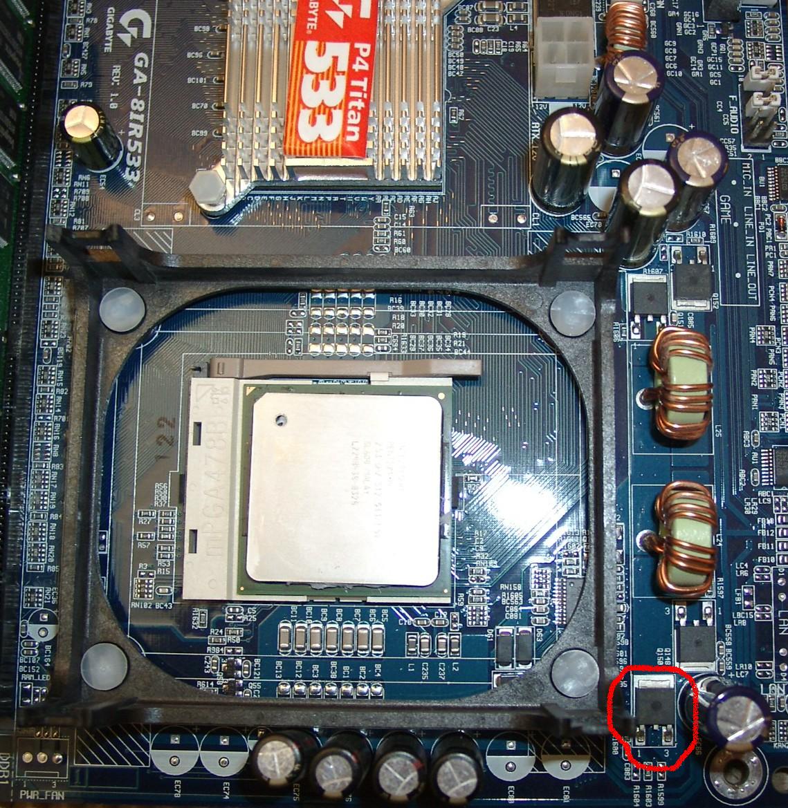

Then I see that this mobo perhaps uses a 2phase VRM too like the Gigabyte.
So I ohm the MOSFET again between Drain and Source and again I find it to be very low ohms.
With CPU in, I get 11.3ohm (this is better than the Gigabyte where I get 0.2ohm)
With CPU out, I get 63 ohms.
I use magnifier and checked for shorts on where I had soldered but found none.
I think both my problems are related?
