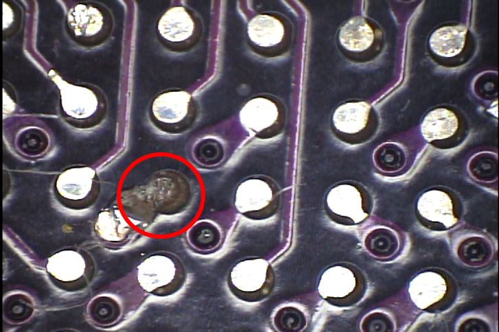

      Always nice to see the final results on a repair project, and this motherboard is no exception. Most boards can be fixed by replacing bad capacitors, so most of the capacitors on this board were replaced. Didn't help, same problem. Using a POST tester, I was able to determine that the reset line on the board was always staying high. I downloaded and studied the south bridge data sheet, 82801. All of the reset functions are located in this chip. So I spent more than a year looking for a company that could do south bridge BGA replacement. No company was willing to do this kind of work for an individual, but only for a commercial business. I now have access to a MetCal MRS-1100 rework station. I was able to remove the BGA southbridge chip. Using solder wick and no clean tacky flux (the type recommended for BGA rework) I was able to clean the motherboard in preparation for the replacement chip. Inspecting the board I was able to determine what the problem is.
      This board has numerous circuit traces broken where the BGA chip solders to the board. The picture shows three broken traces close together. Most likely, someone before me tried to remove and replace the southbridge BGA chip but did not have the right equipment for the job. The heat distribution for removing and replacing a BGA chip is critical. Circuit traces can be repaired (see www.circuitmedic.com). With so many traces to be repaired, I decided the board is not worth the effort. So this project came to a halt. As far as I am concerned, the board is not repairable.

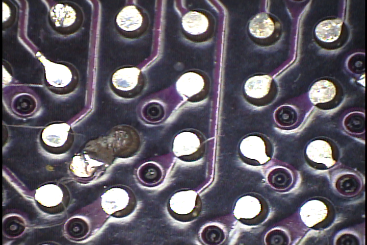

        Here is another broken trace. I made a picture with red circle to show the broken trace, and a picture without the red circle to get a closer perspective.

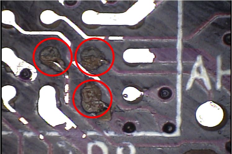

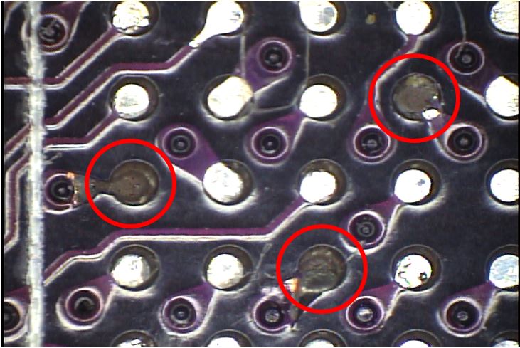

          I counted twelve broken circuit traces. This shows a group of three. Some boards are simply beyond reasonable repair. So what do you think?

            Ah yeah indeed this one is not in a good shape. The chip was pulled while some balls were not fully melted. When removing a dead chip, better overheat it that remove it when it's too cold.
            Desktop boards are not always easy to rework because they are fairly large, use fairly large BGA chips and have a high thermal mass. They are also heavy so they bend easily.
            Apparently the vias are still there so it may be repairable, but would be tedious.
