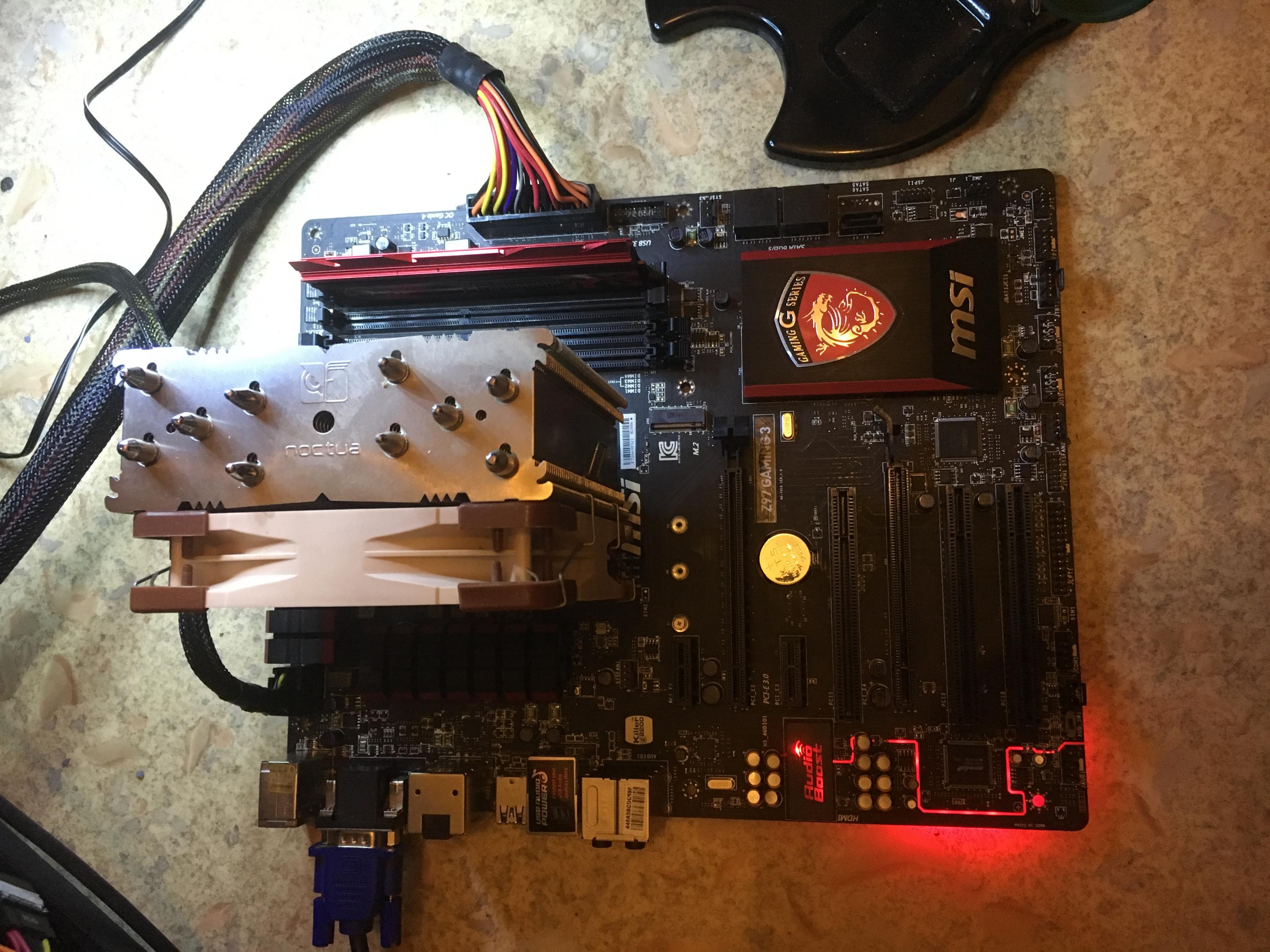

    Hello BC Forum ;
    i have a motherboard MSI Z97 Gaming 3 with no post
    i have couple the motherboard with I7 4790 and 4G of ram TridentX
    i have been desolder the bios chip and flash it with a latest one but still have no post .
    any help about this motherboard please
    thank you in advance

    First, do you have VCore?
    Also, as always, try to clean up the CPU socket contacts, the RAM slot contacts, and try with different parts if possible (RAM and CPU). And a known good PSU obvisouly.

      Hello
      Thank you for your replay
      So the cpu work good on the mpower z87 ram and psu too the motherboard start normally juste no poste dark screen nothing
      Reset bios too .

        Re: MSI Z97 Gaming 3
        here is picture
