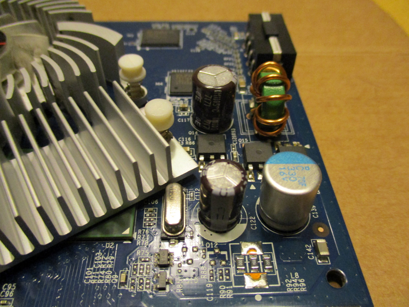

    Trying to revive an old card. It's a GeForce 7600 GS (circa 2008). I use it as a backup card (not used much), and it was working until recently. The card fan spins, but the computer won't boot. Nothing on the screen either. Motherboard gives me a diagnostic code indicating video trouble.
    All the caps look ok from the outside. No breaks or bulges. But might as well replace them insteading of buying a new card.
    I see three brown KZG caps:
    6.3v 1500uF, 10mm
    Another brown KZG cap:
    16v 470uF, 8mm
    Two silver caps:
    16v 330uF, 10mm
    I have some questions. The brown caps have vents on the top, but the silver caps don't. Guessing that has something to do with their temp. rating of 70F.
    Do I have to replace a non-vented cap with a non-vented cap? Is there a special name for these non-vented caps? Or should I just leave them alone?
    Digikey cap replacement suggestions are welcomed.

    The silver caps do [most likely] have vents but the vents are not visible do to the markings being on top of the caps.
    And no, you don't need to replace a non-vented cap with another non-vented cap [i don't think anyone sells new non-vented caps of the 10mm size anymore.]

      The 330uF 16v capacitors are polymer capacitors, which don't have a liquid or semi-liquid electrolyte in them which would produce gas when damaged. So there's no risk of explosion, so there's no need to create a vent on top of the capacitor, so that's why there's no grooves at the top.
      70F is either a code name, a series code of the manufacturer, or just some code telling the manufacturing date or batch number of the capacitor, something not relevant or helpful to us..
      Based on the tiny logo, it's an "United Chemi Con" polymer capacitor, but off the top of my head I couldn't tell you the series.
      You can replace with any low esr 330uF 16v polymer capacitor if you really want to, but they're unlikely to be bad.
      KZG is known series to go bad even without swelling. Replace with low esr polymer capacitors if you want (same capacitance and voltage, actually with polymers you could probably go with 1200uF or even 1000uF if you want, it would probably be fine), or replace with low esr electrolytic like Panasonic FM or Panasonic FR series (keep capacitance of 1500uF, but if you have room on the video card, height and diameter, you could go for 10v or 16v rated versions without any problems)

        I forgot to mention about a month ago, my card overheated and stopped working after about 30 min of use. I noticed this happened because my fan stopped spinning. Apparently, it got gunked up by an acculumation of dust over the years. After putting some oil on it, I got it spinning again, and everything worked as before.
        But, this overheating must of had some effect on the board. Probably accelerated the death of its components without showing any signs?

          those are chemicon psc polymers, one of the best polymers around. the gpu will probably fail first before the poly caps, so no need to replace them.
          however, it could also be the gpu died because it overheated. never let a gf6/7/8 series gpu overheat or run hotter than 60°C because they are affected by something called the bumpgate scandal in which faulty materials were used in manufacturing the gpu chip. this faulty material kills the gpu slowly if it runs over 60°C. above 80°C, the gpu dies a fast death. reflowing wont "fix" that. the chip is dead *permanently*.
          so what u can try is to just solder caps to the underside of the board, on the legs of the current caps to see if that gives some signs of life to the video card. therefore, dont spend too much money on caps. just buy the cheapest electrolytic caps that were suggested by mariushm, in case it wasnt the caps but the gpu that died. i myself am hoping its the caps that died not the gpu as the gf7 series was the last agp series by nvidia so its a nice card. i'm hoping the gpu chip is still alive.
          in the event, the card does come back to life, i suggest replacing the heatsink with something better. the stock fan is just crap and will fail again.

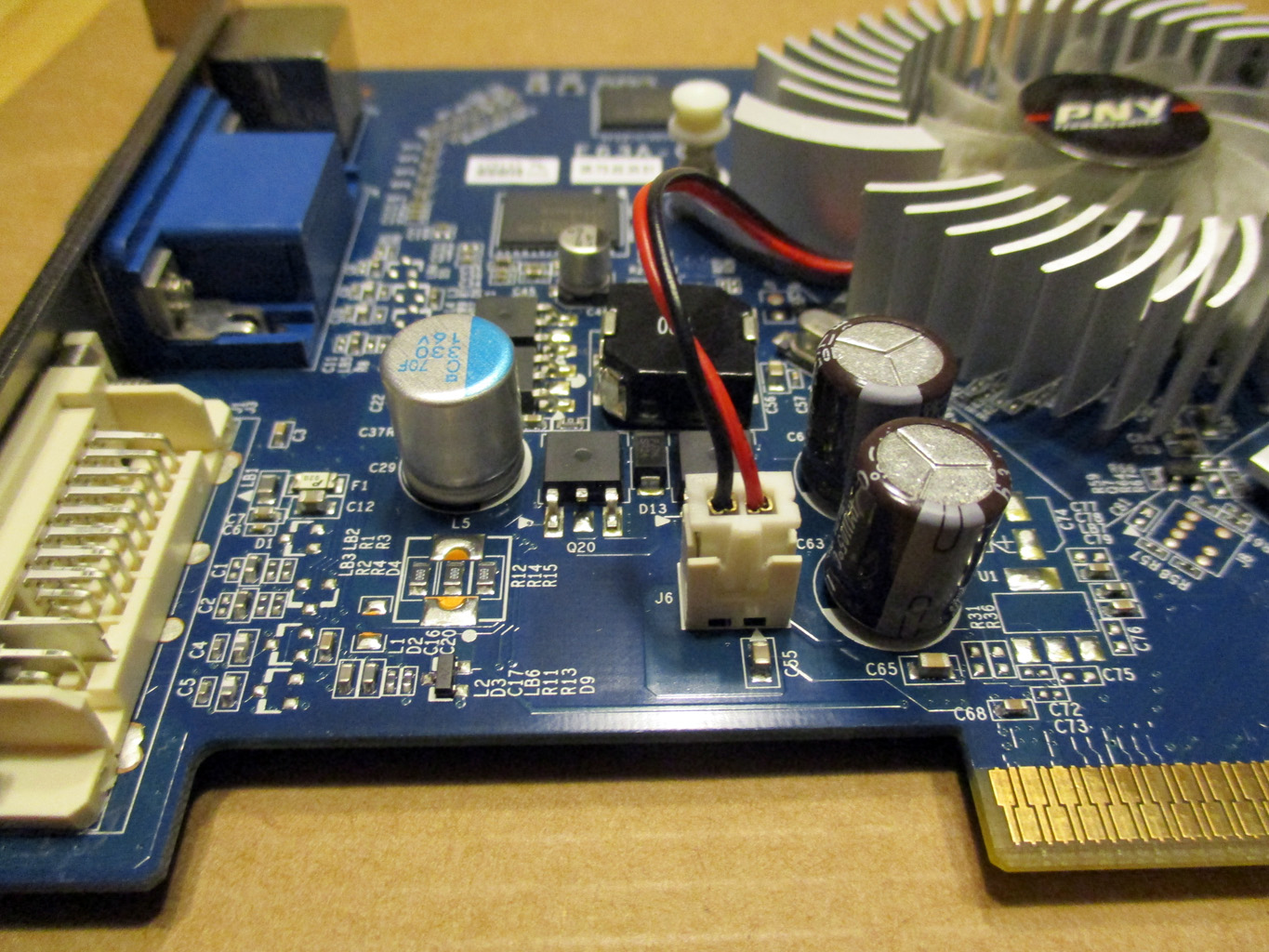

            I'm hoping the card is still good. It's getting power and the fan is spinning. It's just not outputting video. And it did work a couple times after overheating once, so something must have slowly failed.
            I will replace all the brown caps first, try it out. If it doesn't work, I will replace the silver caps and hope for the best.

              Just an update. I tried everything, but I can't get the card to work.
              First of all, I couldn't remove the caps. I think the holes were too small, couldn't get enough heat in them, so the solder wouldn't flow. I just have a 45-watt hobby Desoldering iron, btw.
              So, I tried soldering the caps on the back of the board, as suggested, but I still get a black screen on startup.
              I guess it's not a cap problem.

                the board looks like its a multi-layer pcb and uses lead-free solder. for those kinda boards, u need a 60-80w or maybe even a 100w soldering iron to melt the solder due to the higher melting point of lead-free solder.
                since the problem symptoms did not change, yes, quite likely it isnt the caps. when u pulled the fan to re-oil it, did u reapply the thermal paste as well? many stock thermal pastes are just crap and would have dried out by now. if thats the case, pulling the heatsink and putting it back without reapplying the paste would have accelerated failure of the gpu through higher running temperatures.

                      If you have the proper tools, i would try a reflow, it won't be a long term fix, but it's better than using the card as paperweight.

                        The card is probably dead due to the bumpgate issue, as ChaosLegionnaire mentioned. Sometimes, you can bring back these video cards with a reflow (as the high temperatures required for reflow can also temporarily fix the bumpgate issue between core and substrate solder), but chances are slim. And if you do get it working, you need to get a much better heatsink to keep the temperatures under 60C under any load (preferably under 50C, if possible). Otherwise, it will fail again.
