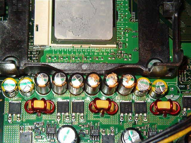

Intel D865GBF has bad caps
  • billgerr
    • Mar 2005
    • 2
    Dell 400SC 820uF Nichicon HN(M) caps
    caps on Dell 400sc board. Note convex bulges on 3 left ones, leaky vent
    residue on 3 right ones.
    • willawake
      Super Modulator
      • Nov 2003
      • 8457
      • Greece
      hard to miss them. funny those marker pen marks on top of the caps. i have seen that a lot and assume that they are marked as having been tested before installation. testing was prolly ineffective for long term failure identification though.
