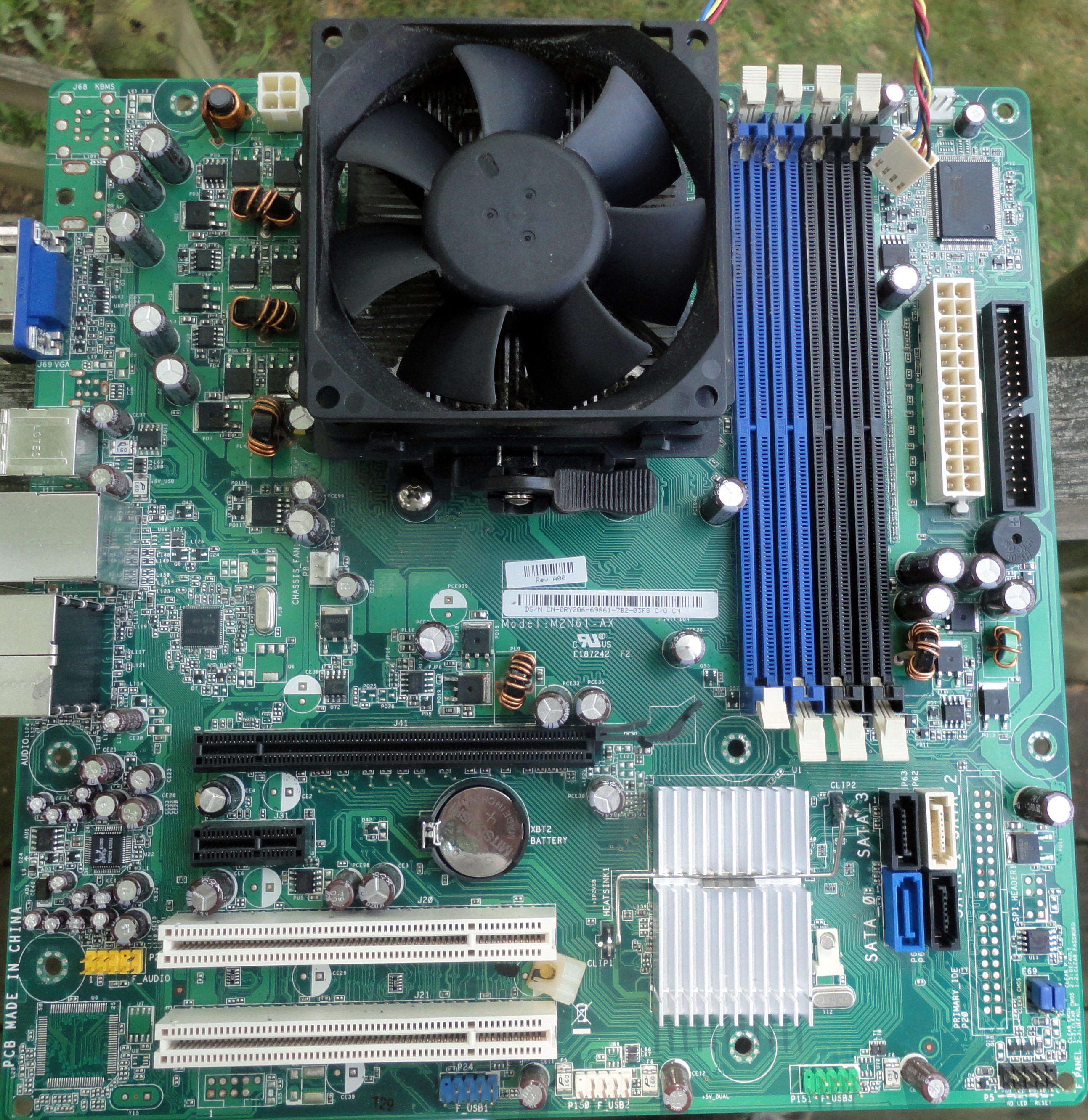

It is an older MB, but I saved it from the dumpster. The computer would not start. The MB had an obvious bulged cap right below the s/n label. I replaced it and the computer fired right up.
Asus M2N61-AX or HP Acacia-GL6E fix
