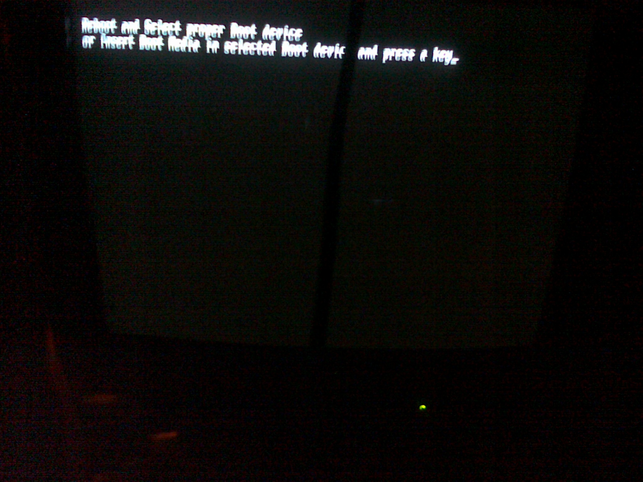

    I recently brought me a computer that does not video, to open the computer I found this:

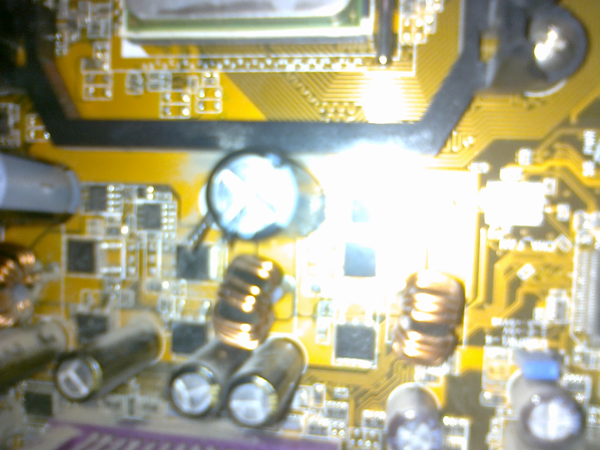

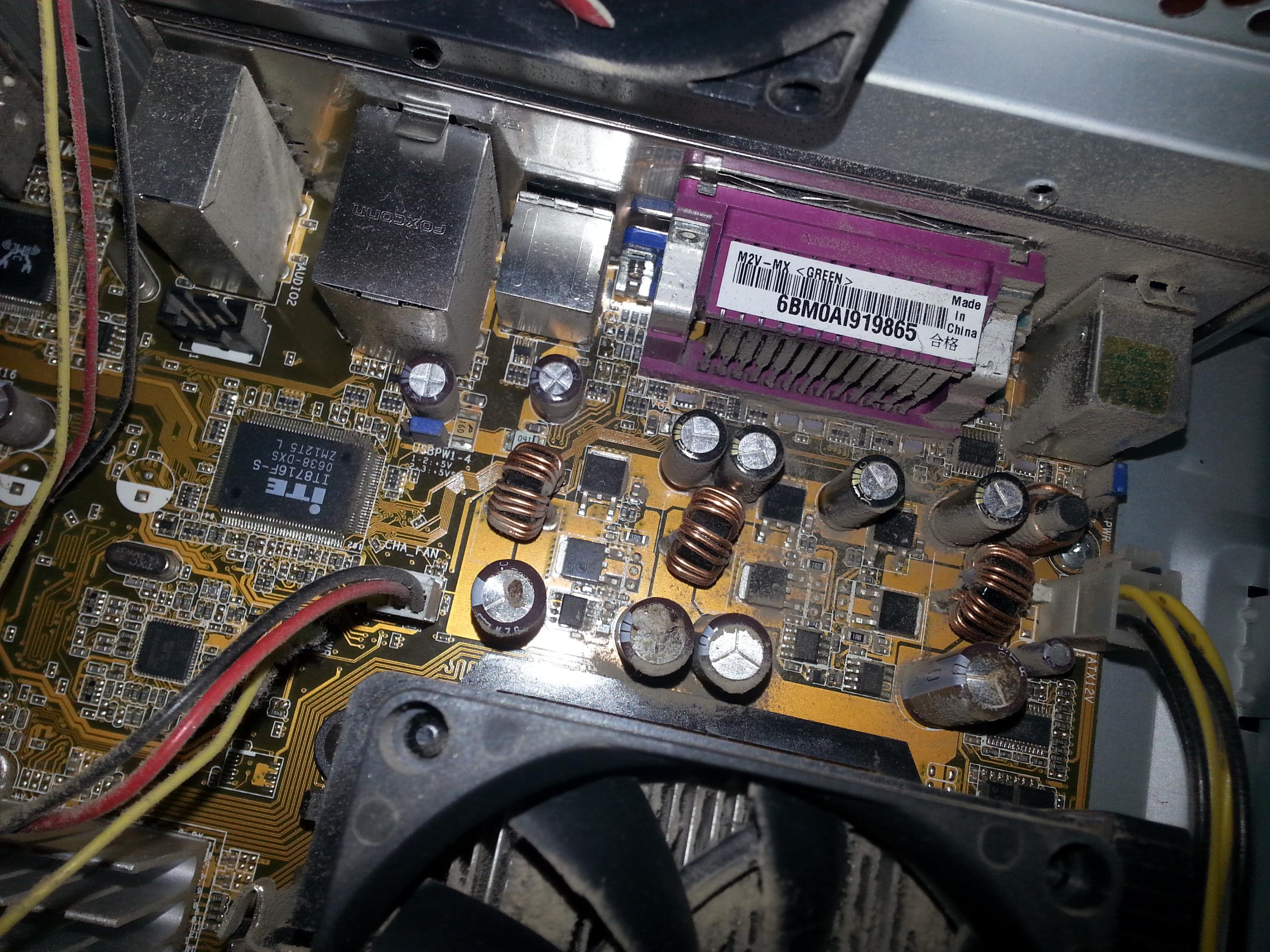

    Capacitors are a Chemi-con KZG 6.3V 3300 microfarads.
    My idea is to change, to see if I can resurrect. I have thought about buying one of 16v 3300 microfarads, but not if they are too big.
    but my question Can break these cap KZG?
    Today I'll go buy some new capacitors. I hope I do not explode one in the face XD. Since the printing of polarity is reverse to what is mounted CAP.

    Sure looks like a candidate for recapping. What caps do you plan to use? Anything you buy locally will probably not be suitable for use on a motherboard.

        Good news, resoldered new capacitors and returned to life!
        Sorry for the quality of the photos, I broke the phone that made great pictures, and are now made with no autofocus
        Here already putting new capacitors:
        Now every soldier, and here is the result:
        And as a curiosity, I'm writing this post with this computer XD.
        It has not failed, no BSOD, no weird stuff.
        Bye. Thank c_hegge for the help
