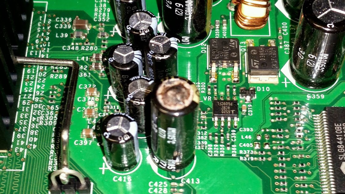

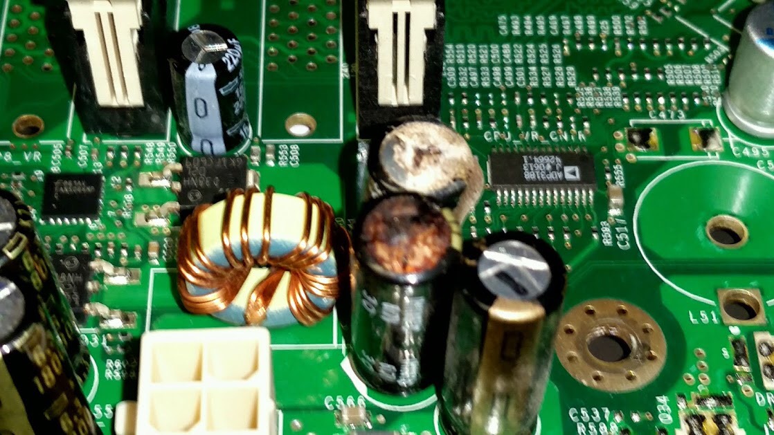

    Dell Optiplex GX520
    MB is a Foxconn LS-36 Rev A01
    Bad caps are KZJ 1800uf 6.3v, the small ones are SMG 220uf 16v.

      I managed to save two of the three images rollme provided back in the day, so I uploaded them for future reference.
