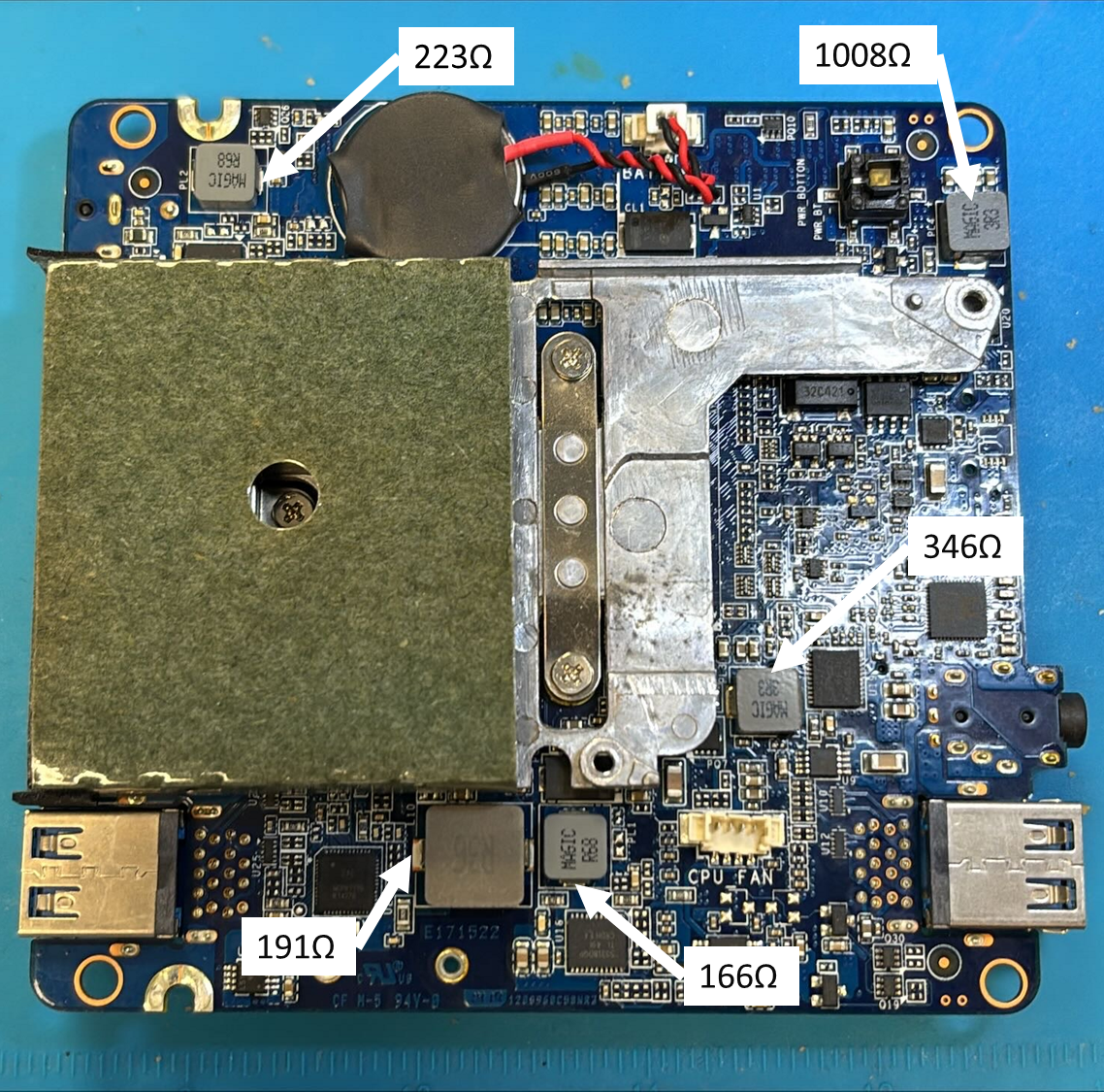

Here are the DMM readings (in diode test/continuity setting) of the coils:

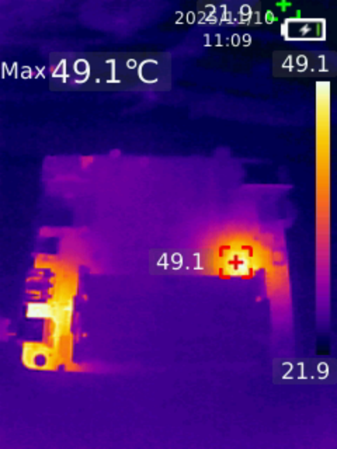

On the other side of the board my Thermal Camera shows that one IC is getting hot:

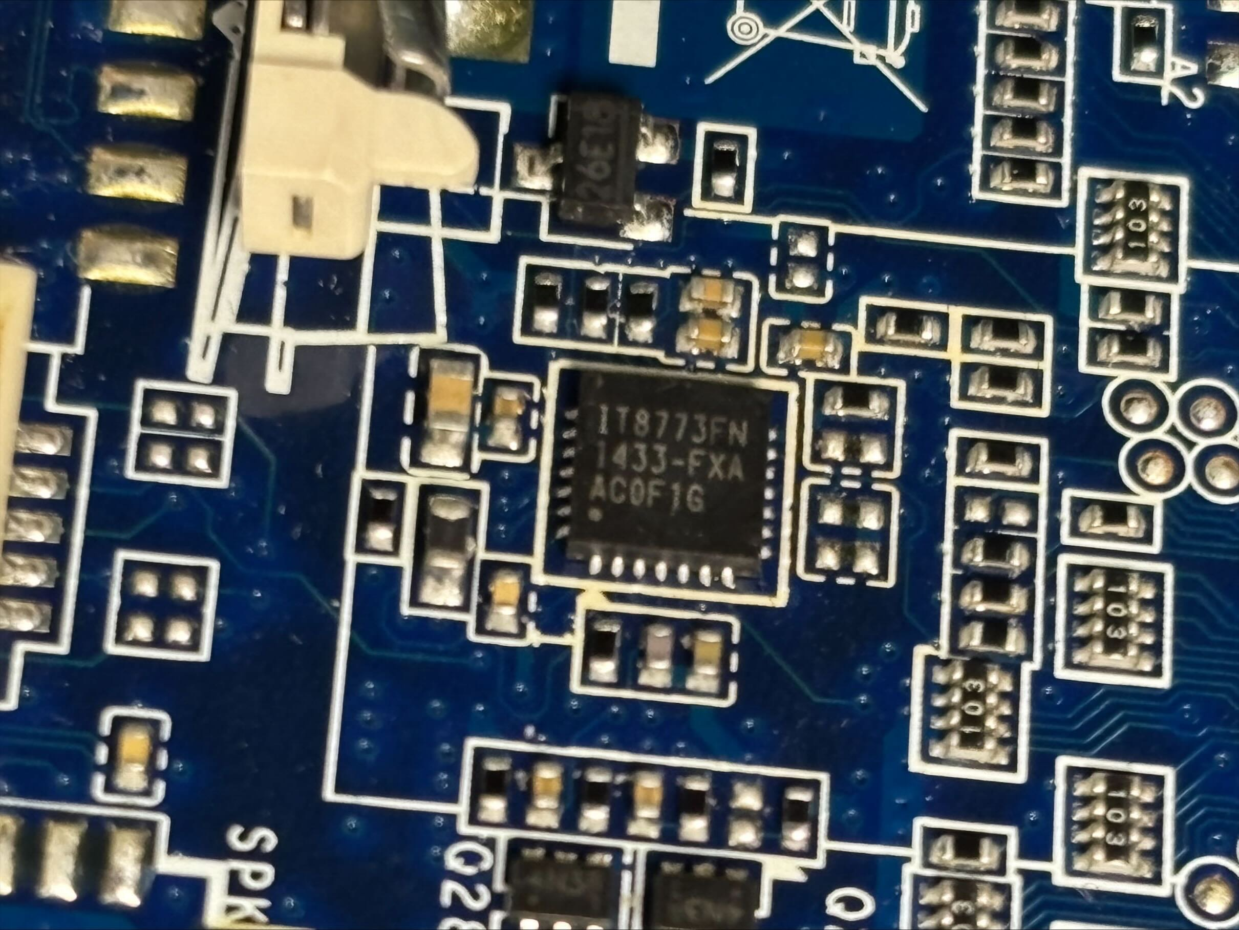

A quick Google and an IT8773GN is an ITE SIO chip.
I've check the capacitors around the IT8773GN chip and none appear to be shorted.
Are the coil reading OK?
What fault-finding should I do next?
