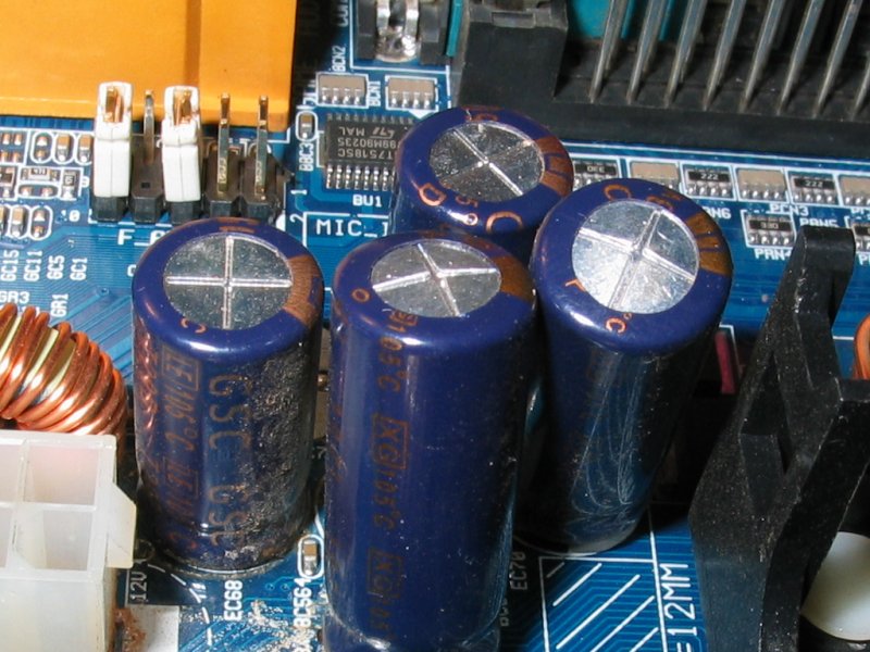

This board had a really nasty mix of Choyos (leaking), GSCs (bulged) and Supacons (still looking good)
Replaced them all and it worked fine.

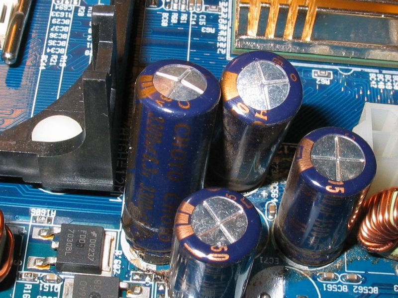

Nice leaking Choyos

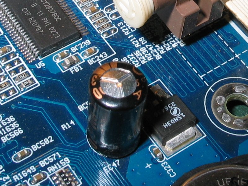

The GSCs are still looking good - but replaced them anyway

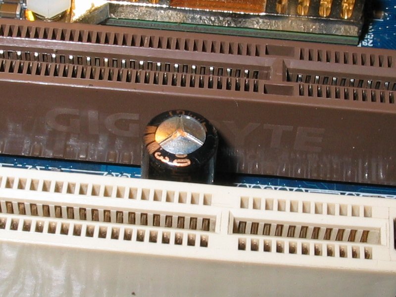

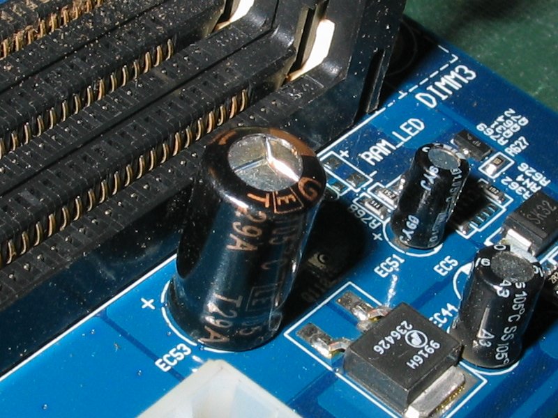

Bad GSCs all over the board
