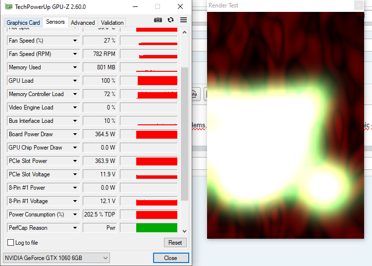

    Hello, I am new to this forum and I need help to repair my graphic more specifically this GeForceĀ® GTX 1060 G1 Gaming 6G (rev. 2.0).
    The graphic has a performance problem and stays at 130 mhz, so I've seen is a problem of ina 3221, and I changed the ina and still continues to give problems, so I would need to help me a boardview that is a graphic or one that looks too much like him because I need to know the voltage of the resistors and coils to know which is the one that is giving me problems.
    Looking at the image you can see that the graphic does not receive voltage on pin 8, and consumption is very high, if you help me locate the problem knowing that it is around the ina 3221 I would appreciate Click image for larger version  Name:	Captura.png Views:	0 Size:	128.6 KB ID:	3465521
    Thanks if you could help me with this.

    mostly it is problem with power measuring. power measuring chip cannot properly measure current by shunt resistor. check traces to shunt resistor

      Check data and clk lines
