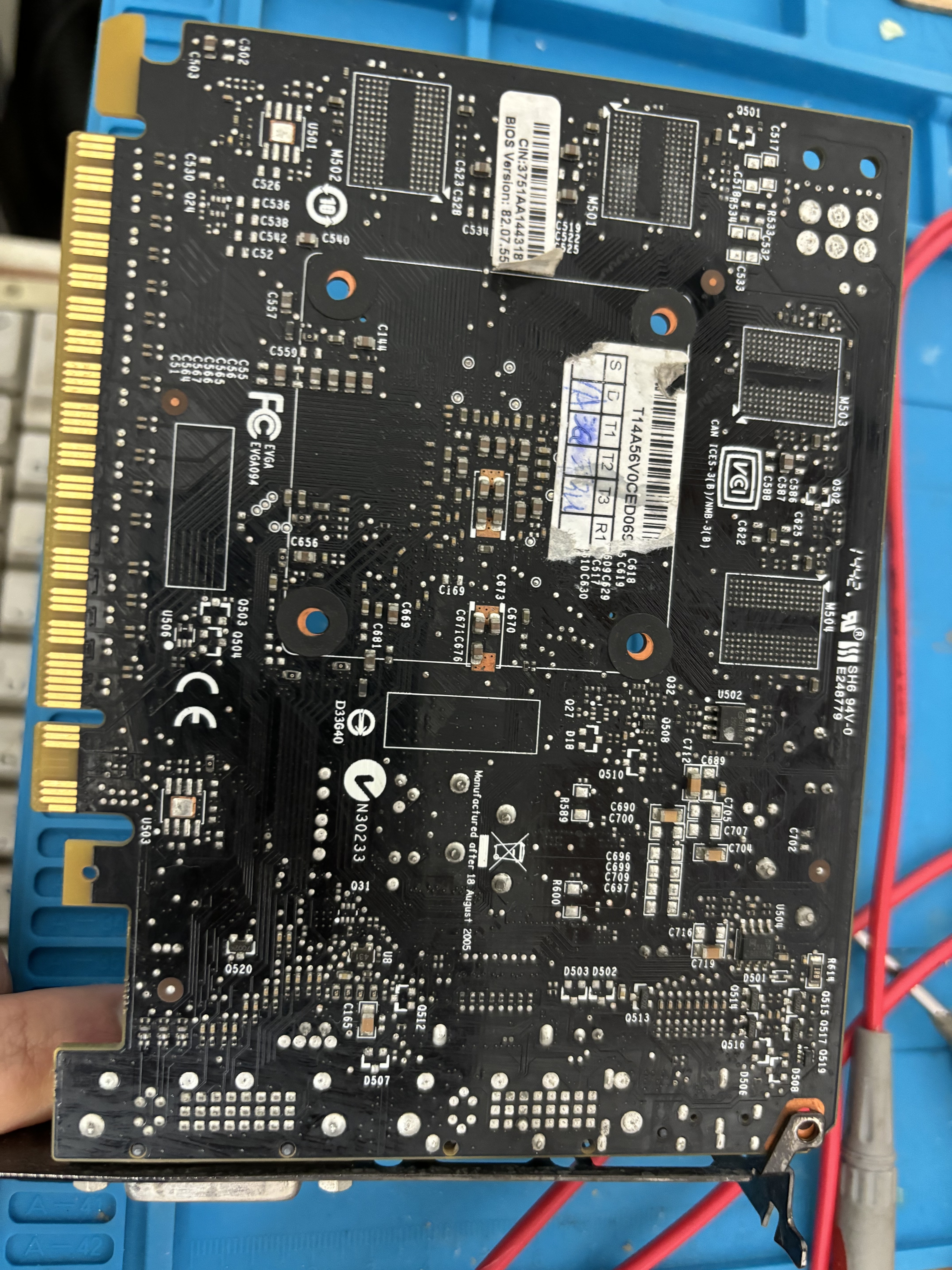

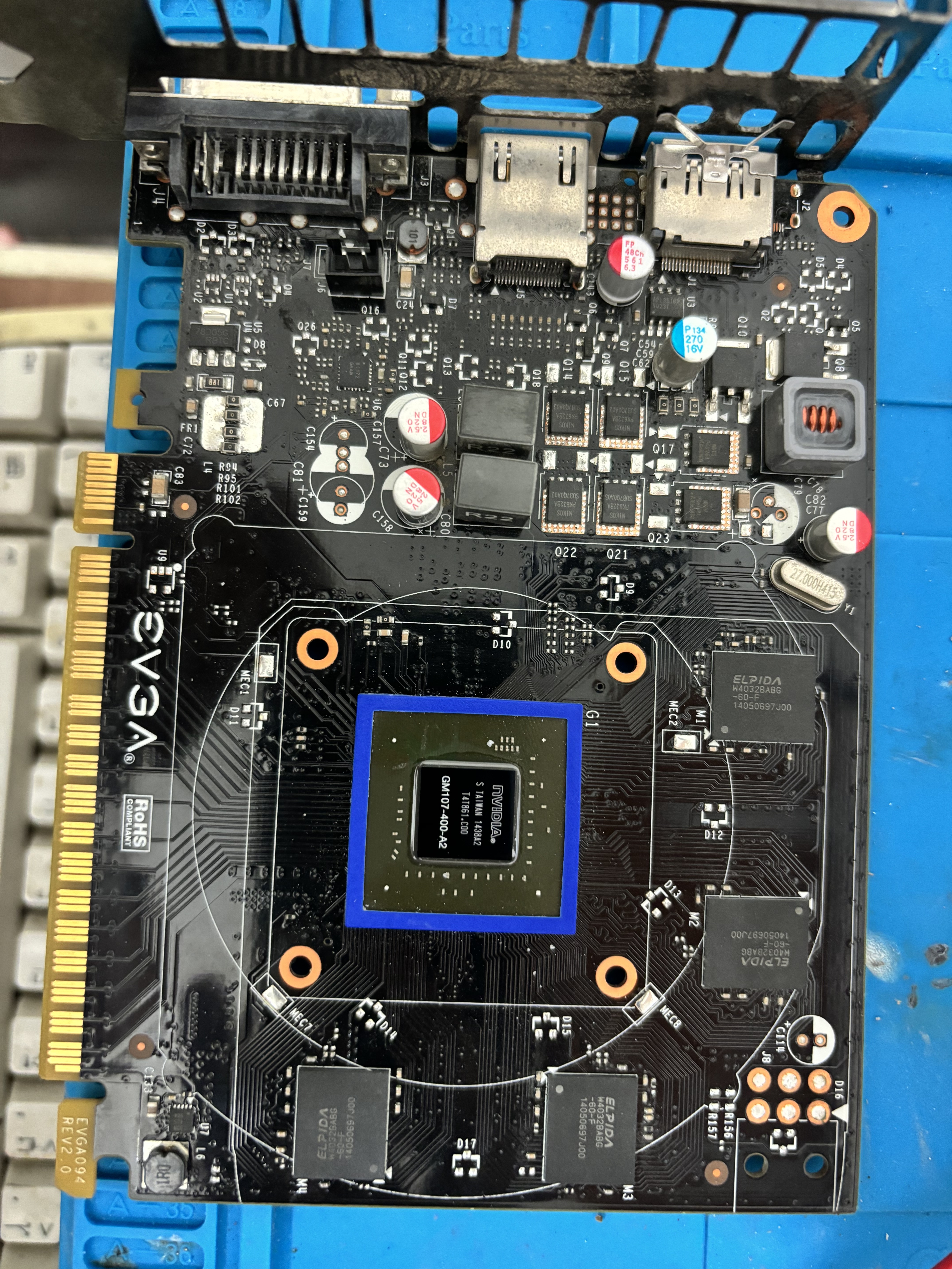

    Hi got this cute GPU,
    PC is powering on, GPU is getting power ~40deg
    Cmos speaker is beeping.
    other cards working fine on this build
    tested the card on 2 other builds- same beep
    visual inspection didn’t reveal any issues or missing components.
    any test points?

    Does it display a picture?
    Installed as a secondary GPU, is the card detected?
    If the answer is no, then check if all of the voltages are present. A warm GPU core indicates it has VCORE, but it may not have VMEM. Some manufacturers have different power sequence. Sometimes it is VCORE after VMEM, or VMEM after VCORE or both at the same time.
    If all voltages are present, check the PEX reset signal (PERST) at the PCIE lanes.
    If it's detected but doesn't display a picture, run MATS to check for VRAM issue.
    Don't understand what you meant by beeping.
    When repairing a GPU card, I use a riser powered by an external power supply with adjustable current limit, and after I verified that the GPU card has no shorted power rails and all of the voltages are present, then I will test it with my computer.
      ***testing voltages- hmmm i would need some reference example of what to test, i may need the riser card otherwise its going to be challenging to test.***
      ***bios is detecting a problem and beeping from mainboard speaker***
      ***any recommendations on a riser card?***
