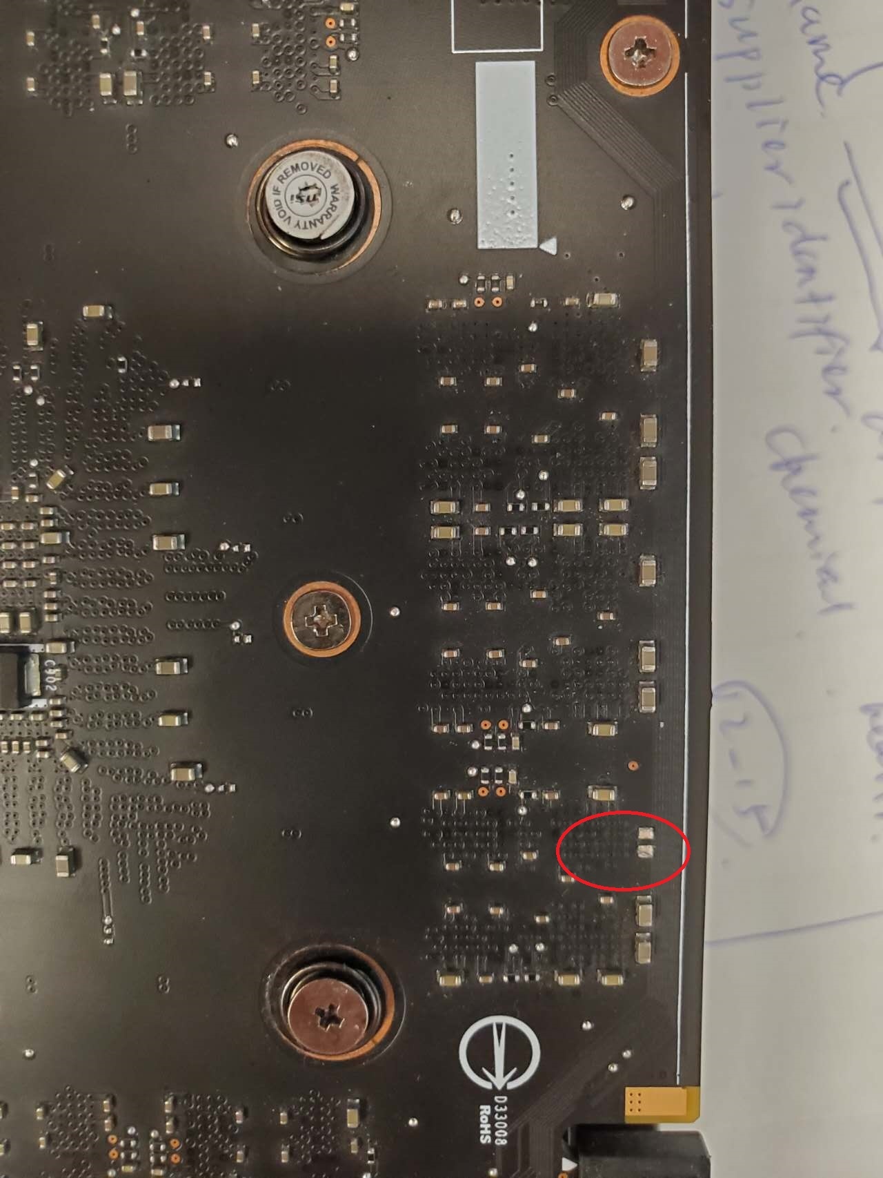

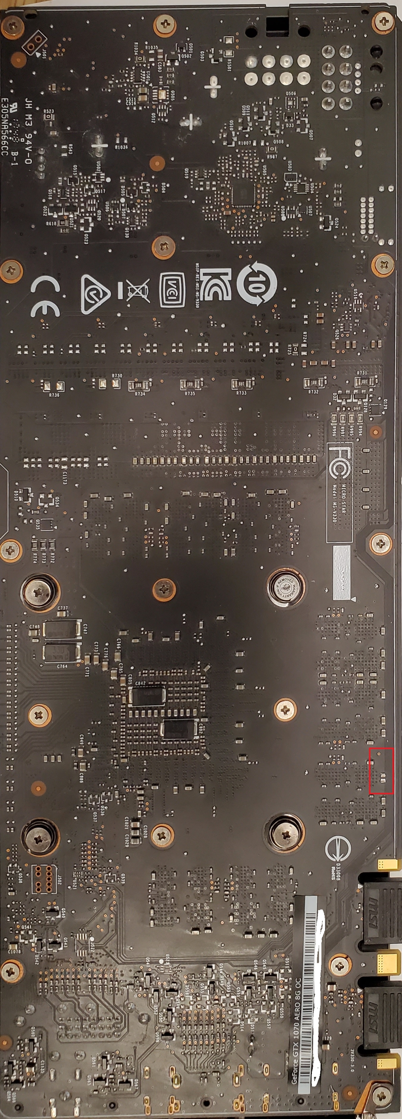

    I need help with the identification of a very small component on my MSI 1070 8GB Aero. I don't know when it was chipped off but it now only shows a black screen for me. This component was highlighted by a red-colored square.

    its a capacitor. i think

        I really don´t understrand your question. did you have a look arround the board? there are minimum 2 or more circuits arround that are not rather the same they are exactly the same cause they are for the ram chips.... other question is how u wanna solder on a smd capacitor by not knowing that this is a capacitor.... smd soldering is not like "normal" soldering. u need special tools as knowledge and a lot of talent...
        the card is old. thats not bad in this case because its still quite ok and the good thing is... the older the card is the higher the probabibelity is to fin a bordview....
        we are all here to help each other and to learn something. be sure not ruinin it by DIY or give it to a specialist.... don´t "try" it... u ´ll do the whole thing wrong... i´m tellin´you.... got my experience as everybody fixing things for a long time... the more they tried the harder it is to bring it up running again...
        Part will have exact same value as the others marked in blue circle... i´m trying toi find out value for you know....

          Capacitor value is 22uf. 0603 is the size....
          as i said the three capacitors are all the same part....
          here is the Bordview... to open it u need boardviewer... u wil find per google...
