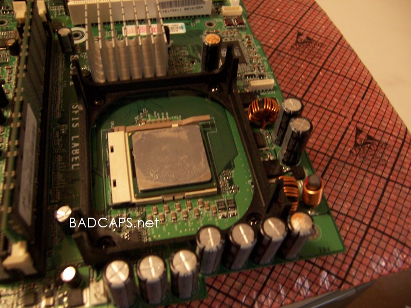

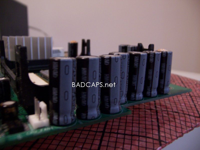

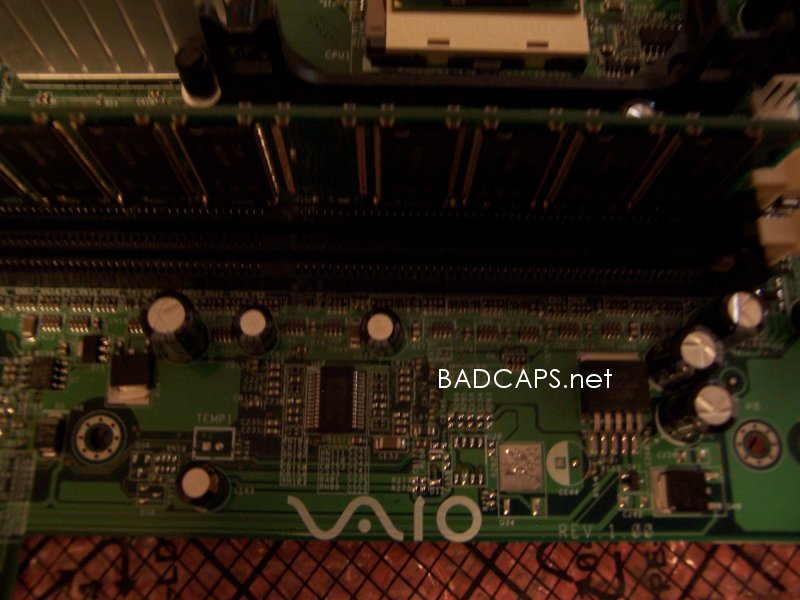

Sony Vaio PCV-W30 - Bad Nichicons
  • Topcat
    The Boss Stooge
    • Oct 2003
    • 16956
    Nichicon HM(M) series, no shocker there..... Just thought I'd share, I don't see many vaio boards....

    Re: Sony Vaio PCV-W30 - Bad Nichicons
    just had a ga-8knxp that was just starting to bsod on the customer.
    this one has the dual vrm
    the hm on the external vrm were open as were all the hm 1000@6.3 all over the board.like 20 of the 1000@6.3
    most were over 10 ohms esr.none bulging.
    this board has an odd mix of nichicon,sanyo,and rubycon.
