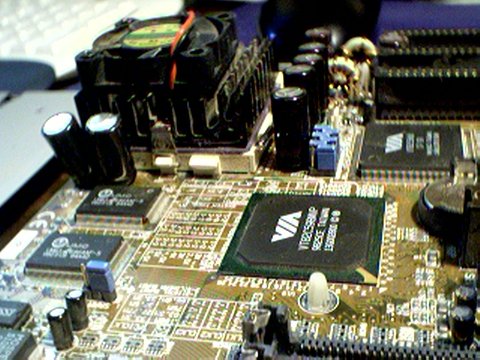

    Just spent a nerve wracking 2 hours with my old VA-503+ replacing all caps bigger than 1000uf as well as some tiny 10uf 25v caps. Used Panasonic FM for the multitude of 1500uf 6.3v, and Chemicon KY for the 1000uf. Panasonic FC's replaced the tiny ones. Some of the 1500's were a tight fit (board had 8mm caps), but most of them went in as most locations were screened for 10mm.
    There were a couple times the iron slipped and made me worry a trace had been nuked, but the job went ok. Tested it a few minutes ago with an old ISA vid card - seems to be a total success
    However, there is still a cap missing FIC didn't add at the factory. It's located between the AGP slot and first PCI slot - looks to be ready for another 1000uf cap. Just wondering if anyone knows - did any of these boards come from the factory with that cap in place?
    Will get some pics later today of the recapped board and some of the caps that got replaced (IQ and SI branded). None were bulging, but the board has been the least stable of any I have ever owned so I did them on general suspicion.

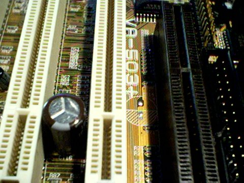

    Here are the pics:
    The Leaning Towers of Panasonic are where I had to shoehorn 10mm caps into 8mm locations. Three of them in all - the third is right next to the jumpers, and I had to bend the CPU retention lever slightly to get it to fit well. The tiny FC's are just visible in the bottom right corner. The other attached pic shows where the missing cap is.

            Hehe - trust me, if I didn't need a working socket 7 board upstairs I wouldn't have bothered with it. I don't think I've even used those SIMM slots as long as I've had it.
            When I last used it as part of my main system way back in the latter days of 1999, I had it running a K6-2 400 overclocked to 504. The 112 MHz fsb setting was actually somewhat stable back then. It always had trouble with the IDE interface, but was usually stable most of the time. Incidentally, the IDE troubles (it corrupts data in DMA mode) are what got me replacing those two little caps - they're right next to the IDE slots.
            I guess I recapped it mostly for nostalgia's sake - it was the very first computer component I ever bought - had a 386SX 33 before it.
              I have a FIC VA-503+ v1.2a and it does not have the "AGP Cap" just like your motherboard.
              Further investigation leads me to the conclusion that FIC didn't add them at factory.
              Useful links with pictures of the board:
              http://jmr.hardware.free.fr/ficva503.htm
              http://www.fic.com.tw/product/mother...cy&model_id=19
              I hope that will help you!
