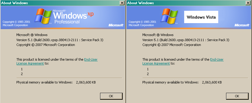

            For fun, I booted the OS before FDISKing and formatting/resintalling. What a heap! It was XP home, but apparently it was D/L'd from a phreaking site and was being pushed as 'Vista.' Some jackass modified it in such a way as to be able to type over any place XP would normally be displayed! Any place you'd find the Windows version on this installation, you'd see the same as in my little example.
