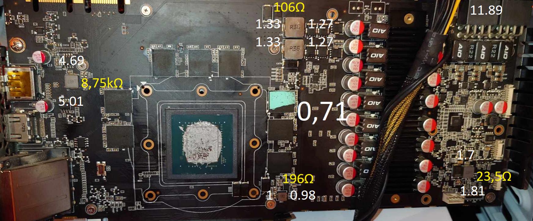

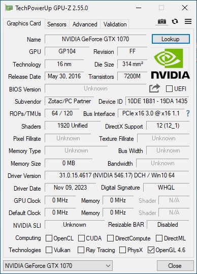

    HI Everyone, I have a Zotac GTX 1070 graphics card that is broken. It does not display the image, on the computer it shows error 43 (at integratet graphic) and mats mods showed errors like "mats version 400.184. Testing GP104 with 20 MB of memory starting with 0 MB.
    Read Error Count: 16368640
    Write Error Count: 0
    Unknown Error Count: 0
    === MEMORY ERRORS BY SUBPARTITION ===
    SUBPART READ ERRORS WRITE ERRORS UNKNOWN ERRS
    FBIOA0 2046080 0 0
    FBIOA1 2046080 0 0
    FBIOB0 2046080 0 0
    FBIOB1 2046080 0 0
    FBIOC0 2046080 0 0
    FBIOC1 2046080 0 0
    FBIOD0 2046080 0 0
    FBIOD1 2046080 0 0"
    I tried to flash the bios because my card behaves exactly the same as in this video (https://www.youtube.com/watch?v=9M2K...ist=LL&index=4), gpu-z is not showing information about clocks and bios version, fans are spining and I have error 43.
    Attached is a photo of my measurements, I tried to flash the bios on the new spi using nvflash, with no result. I wonder if the resistance at 1.8V is too low?
